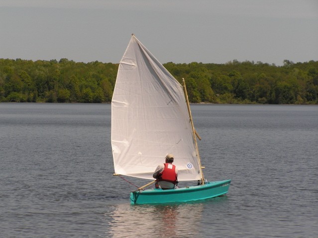

  16. Thanks for the warm welcome back, although I really didn't go anywhere I always lurk to see what everyone is up to. Here is what I was up to last winter and this summer. I finished construction on this Mirror last winter and sailed it all summer she is in a new home in WI I've been helping Meg build her sof kayak And I am currently finishing a sunfish restoration

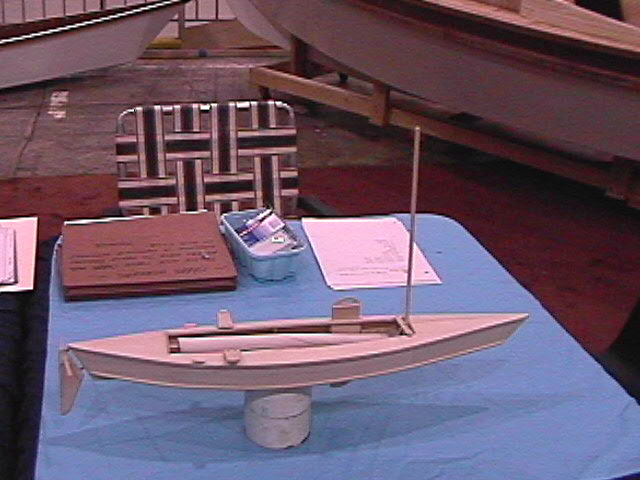

  22. Here is a model of the original construction 1 zillion dollars to the first to name the two designs in the back ground

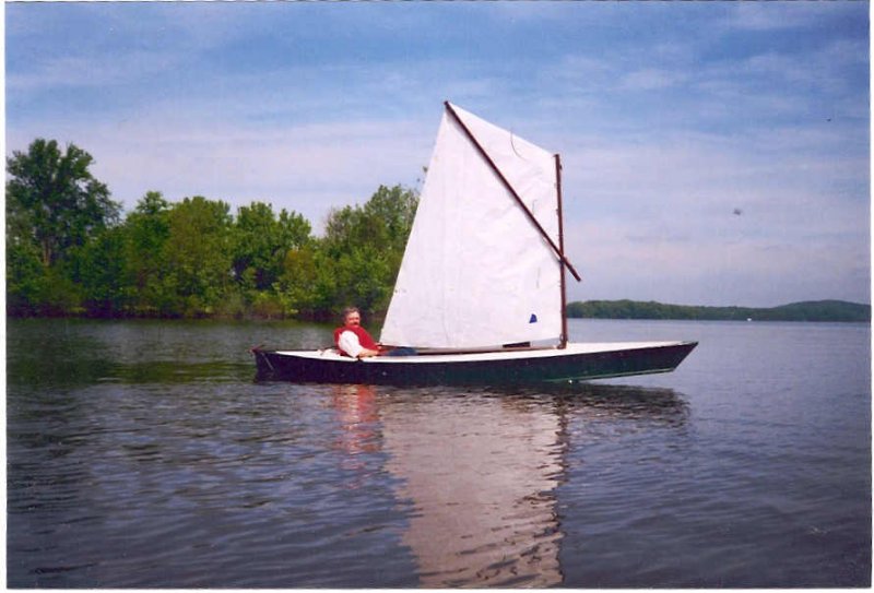

  23. Here is the orginal sail rig
  24. It is a Bolger designed 16ft Pirogue. The sail was increased from 40 sqft to the 65 sqft shown in the pics. I have also added a swinging centerboard and kick up rudder that were not in the original plans. She is a bit tender and it takes some attention to keep her going in a stiff breeze but alot of fun.
