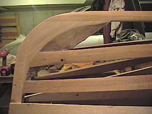

    61

Everything posted by john_manchester

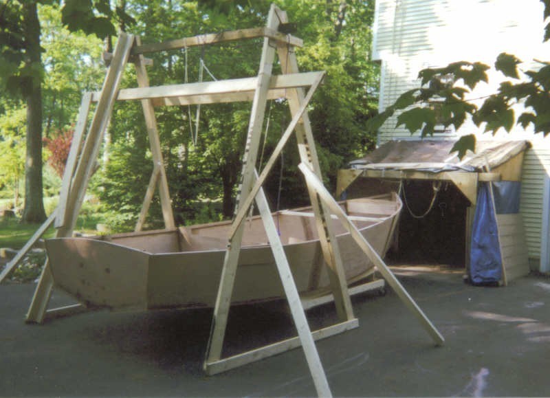

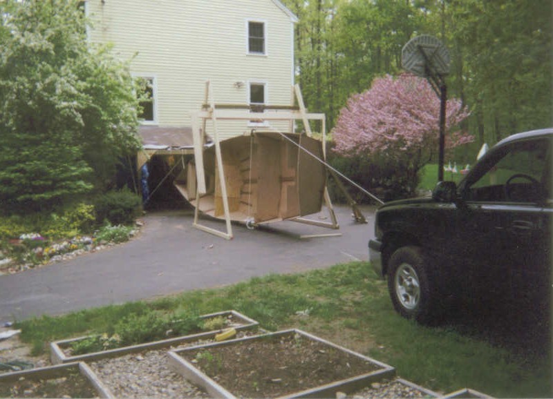

  1. Finally got around to developing/scanning some pictures, and thought you might enjoy these. Charlie's photos inspired the rope cradle, although the "gallows" and pickup are my fault. I've turned her twice now this way, without any help, serious exertion or damage. Although I have to admit looking at the photos it's a little surprising it has gone so well (and that my wife is still speaking to me). Don't have the recent pictures but she's currently upside down again, with her centerboard case and motor well, almost ready for that Xynole polyester I bought so many months ago.

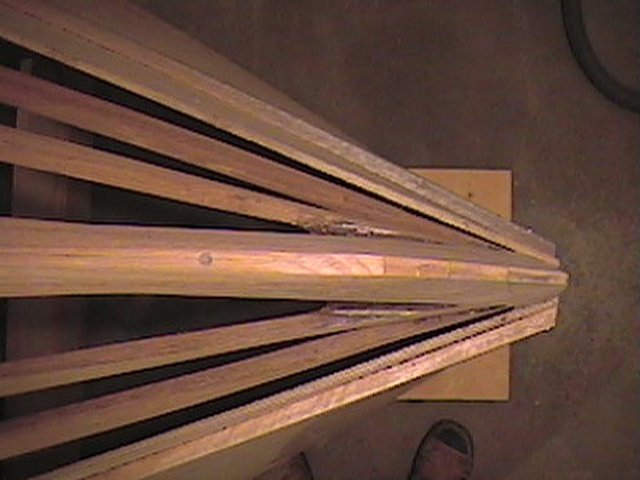

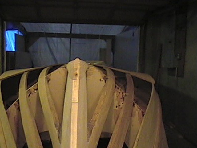

  2. Well, I followed Graham's instructions and I think I got it about right. I pulled the cap off after fairing the profile, and haven't put it back on yet. Hard to tell from the pictures, but what do you think? Charlie's pictures of the stem can in handy before cutting it--nice step-by-step, detailed shots. There are a couple of nice shots of the bow floating around too, just beautiful (and very humbling).

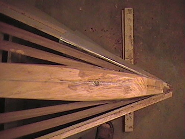

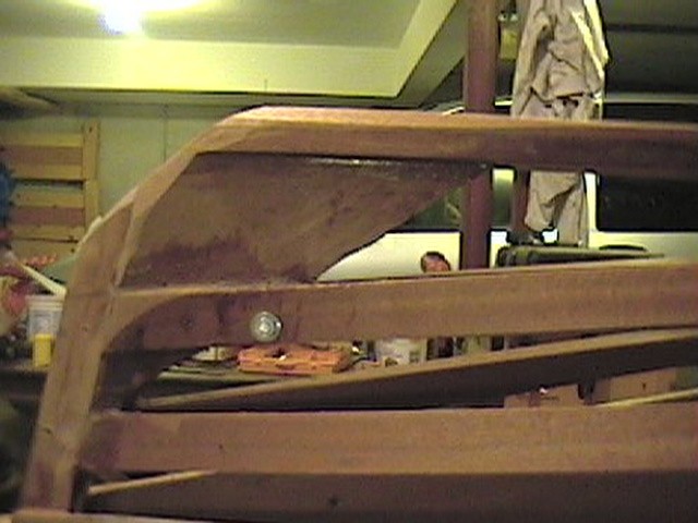

  4. So I do still have quite a bit of material to take off. I guess I can just take my time and apply the old rule "If it looks rigth, it is right"? I haven't attached the stem cap yet--should I do that before fairing the bow profile? I was thinking I'd sort of "rough in" the curve without the cap, and install it after the planking, and then go back over the profile more carefully. I think the forward bulkhead looks wrong in the photo since I just cut off the bottom 1 1/2" straight. After notching for the keel batten and cutting the scuppers, I didn't think there'd be enough material left worth keeping. Thanks very much for helping on this one. I'm sure it's the sort of thing taht's obvious if you can see it or of course if you've done it, but otherwise is tough to conceptualize.
