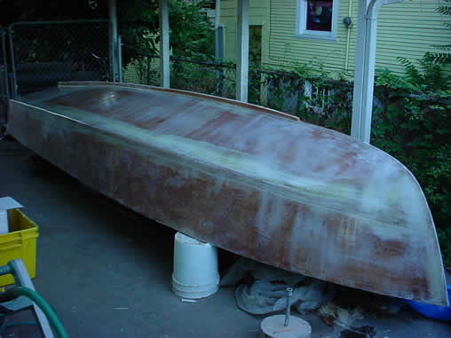

I screwed and glued the keel after fiberglassing the entire bottom of the boat. I needed to screw it down in order to epoxy to the boat. I counter sunk each screw, then filled in the holes. I figured between 1/4" - 1/2" of thickened epoxy between the keel batten and the bottom of the hull for calculating how deep the drill bit should go. I marked the depth for each hole on the drill bit using a sharpie so I was sure that I didn't go to far. As a back up, I would pull the bit out frequenty to check the color of the chips: brown, still in Okume; white, now in the thickened epoxy; brown again, into the keel batten and time to stop. I'll know how well I did when I flip the boat over. BTW, online metals doesn't seem to sell the brass half rounds. Anyone know of a place online to get this?

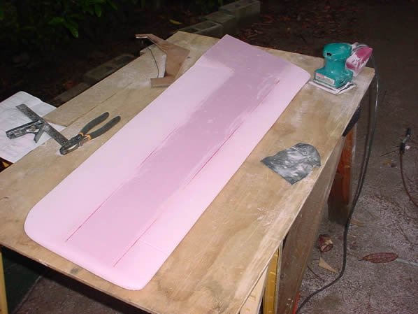

Thanks for the feedback. I roughed up the foam for better adhesion--in as-bought condition it has a smooth, shiny surface. The shiny surface didn't absorb any epoxy, the roughed up did. A test piece pulled a fairly significant divit out of the foam. However, the foam doesn't have much strength, so it didn't take too much force to pull out that divit. The cloth I used is 7 or 8 oz (can't remember exactly). There seems to be sufficient stiffness to limit strain at the cloth/foam interface. Still, I fully expect to build a second centerboard out of wood (now that I have a table saw) as this was more of a temporary solution.
Hi everybody, I think its been a year since I posted anything so I thought I'd stop lurking and share the progress I've made over the summer. I am currently in the process of epoxying, fairing, etc. the bottom. I followed the example of somebody else on this forum and made the centerboard from foam (insulating foam from home depot--$8 for 4'x8' sheet) and fiberglass. I did this because at the time I didn't own a tablesaw and didn''t think I could rip boards true enough to glue together for a centerboard. CB turned out OK and is strong and light. There are three layers of fiberglass staggered: one layer at tip, two midway, three near top. (Also, a layer of fiberglass tape on leading edge for extra bump protection. I made the wood part wider so that the pivot is surrounded by wood, not foam. Turned out to be a bit more work than I expected. Note: I have since purchased a tablesaw and don't know how I lived without it. I'll have to stop at the end of September (school) and I hope to have the boat painted and flipped back over by then. I noticed people have posted their pics of flipping the boat. I wish I'd taken some because it was quite a sketchy operation. Eyebolts drilled into the carport, ropes, pulleys, a come-along, etc. and I still feel like I hurt my back. Next time I am going to use the most effective boat flipping tool known to man: a case of beer to lure friends.

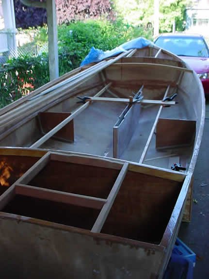

I second Toms advise for using a spacer. My CB trunk had a bit of a warp when I put it in too. I solved this problem (I think) by screwing the side of the trunk closest to the center line to that piece of wood on the center that runs the length of the boat (is this called the "keelson"?). i.e. I screwed from the bottom up through the slot. I then used spacers to keep the other side parallel to the screwed side. After the glass dried, i took the screws out. Seems to be straight and the CB fits inside. On a semi related note: 70% through my filleting of trunk to boat, I ran out of my silica thickener. In a panic I decided to use the graphite powder (West Systems stuff, contains both graphite and silica) I bought for coating the centerboard. Seemed to work great, but I'm wondering what the adhesion qualities of graphite to figerglass are. I applied the fiberglass while the fillet was still tacky. Also, thanks to the graphite, I will have to do some sanding and painting because it looks like someone lost a fight with a bucket of tar on the inside of my boat.

I asked the dark hull question to the tech-sales guys at System Three. Here was their response: "You won't degrade the epoxy. However, Lopez Blue is dark enough so that the decks are going to get up to 170-180F on a hot July day at noon.This is above the Tg of the Epoxy. So the epoxy will be rubbery. The wood will try to lose moisture and shrink. The weave pattern of the fiberglass will print through along with the grain pattern of the wood. The deck will be too hot to touch. After a few weeks of this your boat will look very ratty. If you can live with the snickers of those who see it in this condition then paint the exposed deck and horizontal surfaces Lopez Blue..." Of course, I only want to paint the hull sides and bottom dark, not the deck. Maybe I will just go for it and paint it blue anyway. If it looks bad...well, then I guess I will be doing a lot of sanding...
Hi Everybody, I've read a lot of discussion here about how a hull painted with a dark color can heat up to the point that the epoxy begins to break down. Yet I see a lot of pictures of CS 17/20s with dark hulls--anyone know how are they holding up? Has anyone actually seen a boat with a dark hull have problems? I intend to fiberglass the outer hull of the boat and would like to paint it dark blue. I figure that here in Oregon, it seldom gets hot enough to worry about the Tg of epoxy. However, I also have visions of trailering my boat down to baja someday and don't want to look in the rear view mirror to see my hull peel off in big goopy mess.
Great pics Tom. Thanks for posting them. I think I'm going to try that shortened front deck like you did. Out of curiosity, why did you choose to do it that way? I read your thread from last January regarding paint and was wondering: did you wind up going with the Rustoleum for the interior and enclosed areas? I'm restarting my CS17 project after an 8 month hiatus (school) and am enjoying catching up on the forum. I'm about to frame the interior for the seats.
