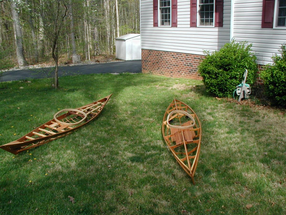

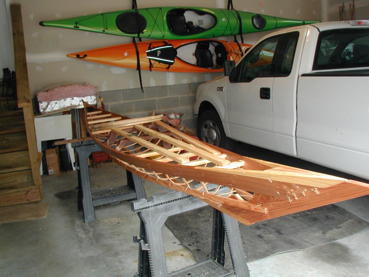

    You may be right, it probably will be tippy. I mostly scaled down the length. I kept the center of gravity and the seat location as per the plans. This is a Wolfgang Brinick design and I wrote him and he said as long as I kept those things the same it would not adversely affect the handling. But these boats are tippy anyway. The other boat is Jeff's freebee 14" design and I stuck to the plans so that boat will probably be fine. I had 14' western red cedar left over from the freebee that is why I scaled it down. The original plans for the Greenland style boat called for 16' gunwales, stringers and keelson. The extra foot of length for the 17' and my 15' came from the stem and stern boards. On Jeff's design I must have installed the stem and stern boards wrong so the stringers and gunwales met in the middle of the stem boards and it ended 15' but I didn't realize it until I had them lashed and decided to leave them that way. I don't think the extra 6" at each should affect it. I am sure it will float I just hope it will be right side up. If not it will be a nice wall ornament. Thanks for the comments.

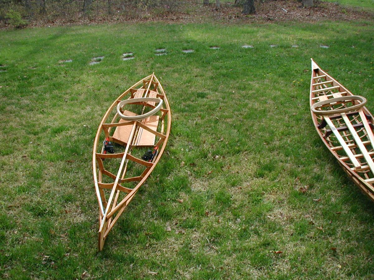

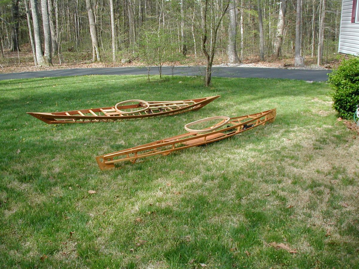

    I finally got around to taking frog pictures. Almost ready to skin.

    Sorry I didn't mean to offend. I thought I was not explaining myself well. The Greenland is styled after a West Greenland style I saw on a Greenland traditional site. Here is a picture attached. Thanks again for the help.
