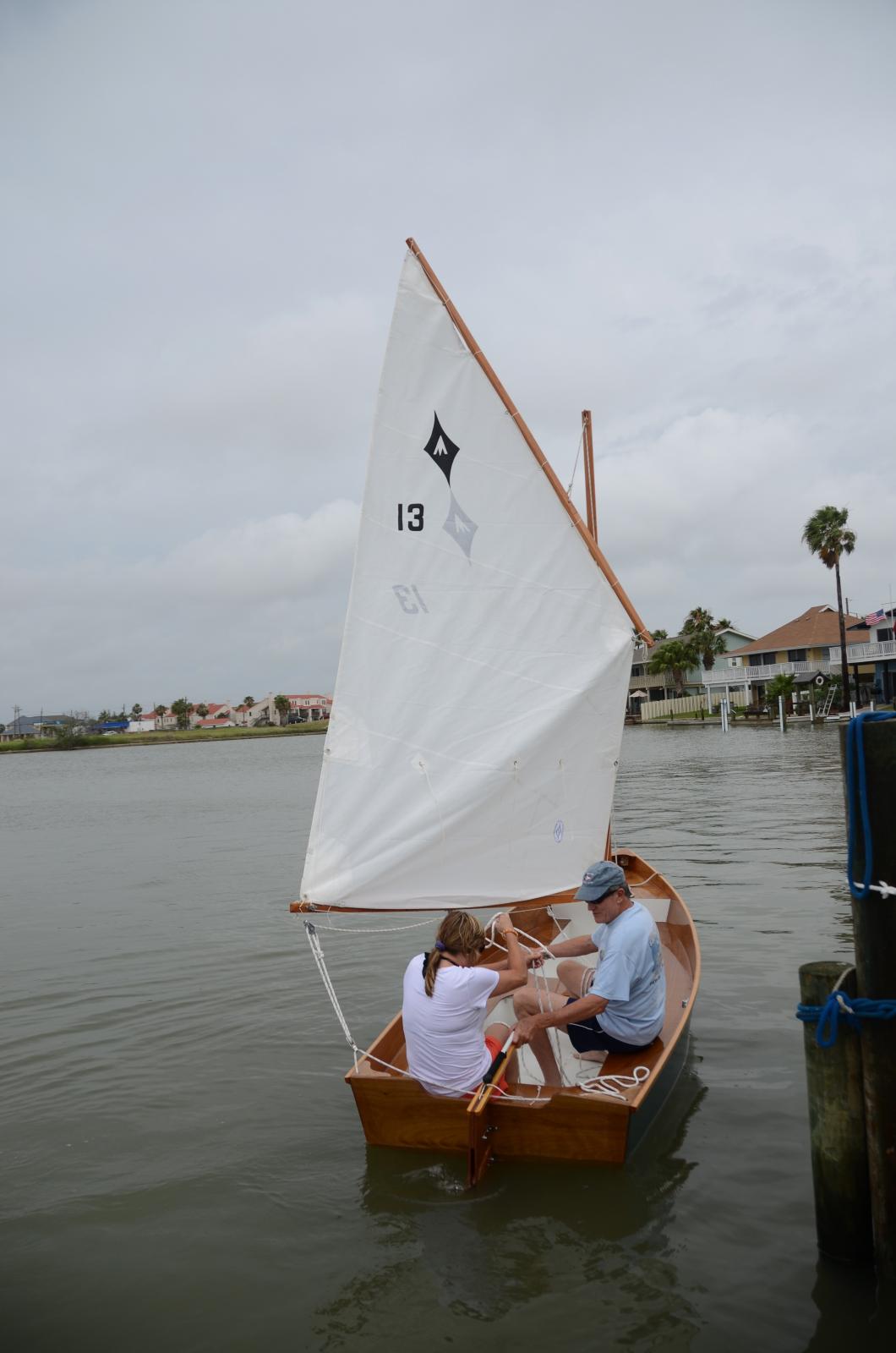

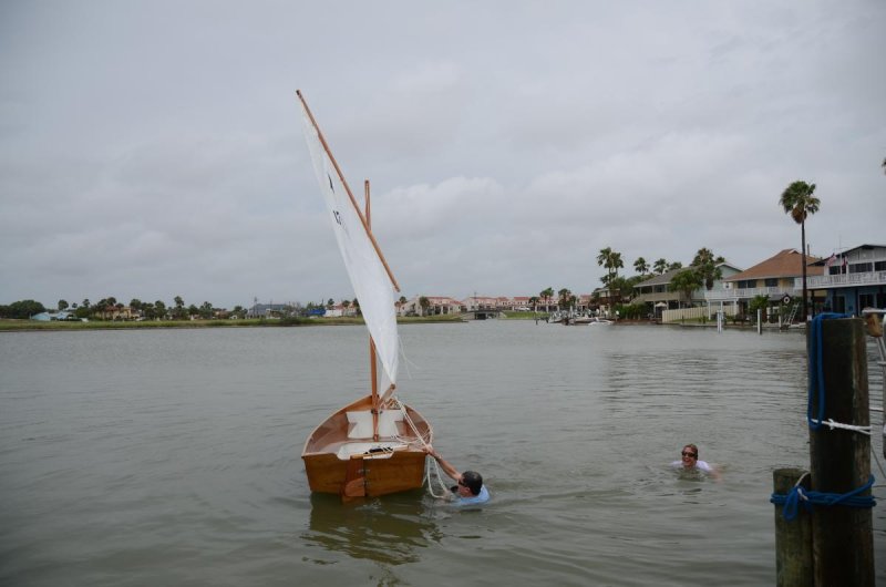

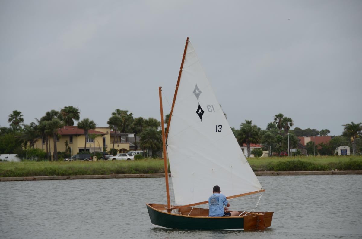

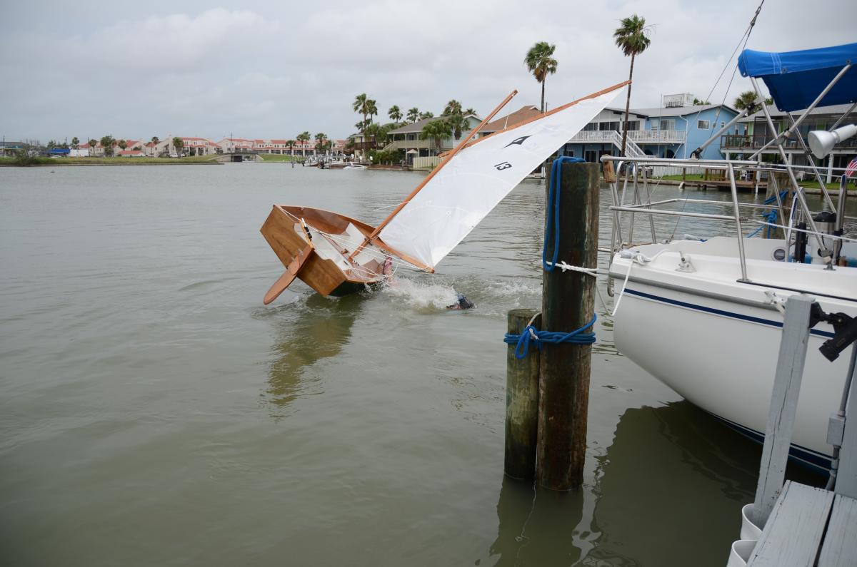

I'm 59. After finally finishing my little Mandy/Amanda (13), we toasted it, put it in the water and my gal and I got in. I push away from the dock, and about 10' later said, "come sit beside me". She gets up, steps towards me and... That's my foot still in the boat! We were laughing as we surfaced! Got back in and actually did get to sailing. The boat sailed nicely, and even did well in 15 - 20 mph wind the next day. Of course, I'd like to build another boat (maybe a Ocracoke or OuterBanks), but can't until and if I can figure out a way to deal with my severe epoxy reactions. We'll see. Many thanks to those who gave sage advice while this first time novice fumbled about the build. And Special Thanks to Graham who patiently answered all my questions, especially the stupid ones (am I being redundant?). Tim

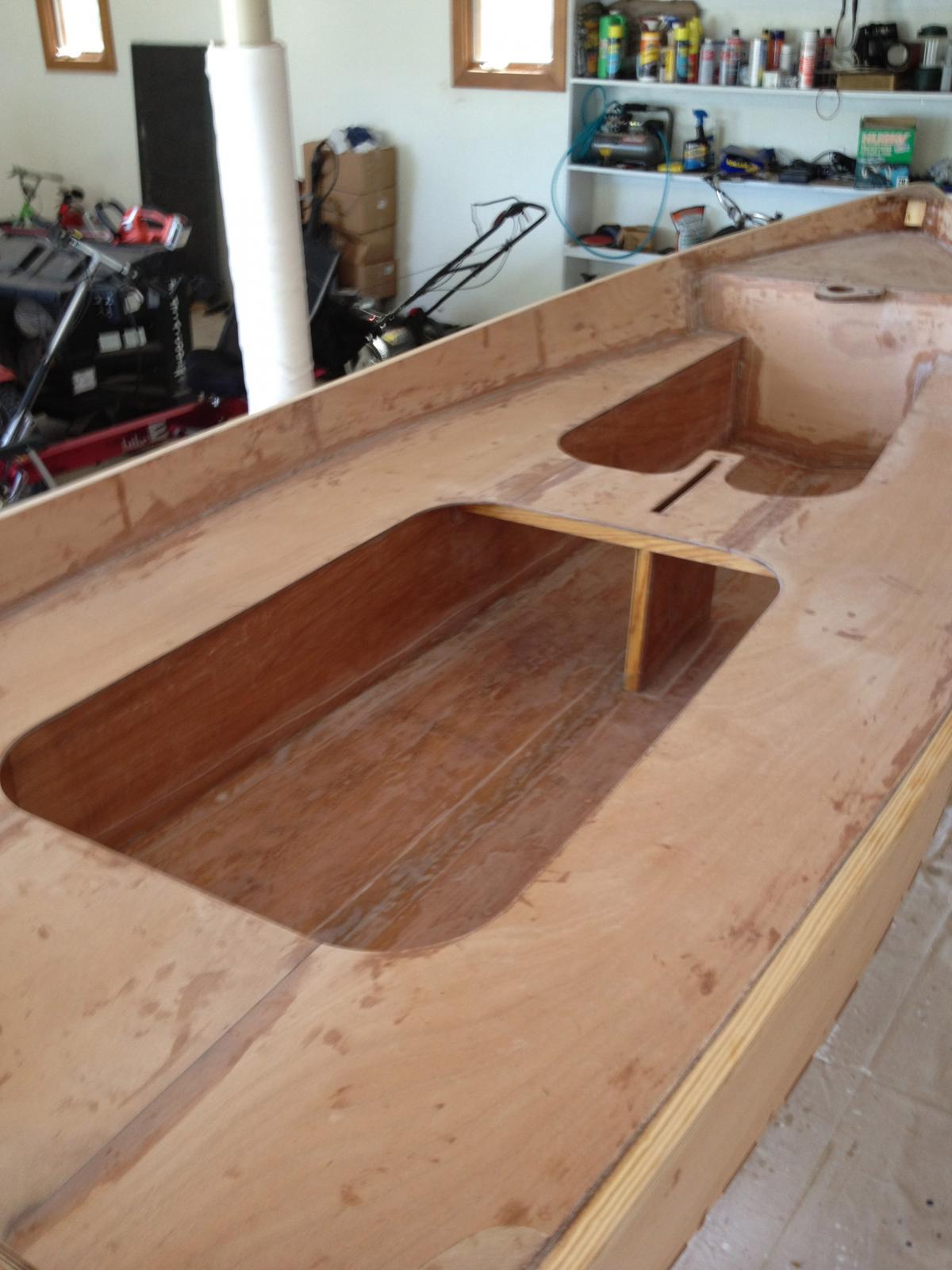

I've about finished up with my boat, and need to rig it, but I don't know s*** from shinola about what to get and where to install it! Not much of a sailor (yet). Does anyone have any good pictures and/or advice as to what parts I'll need and just exactly where to install them? I could post a picture of the inside of my boat if it helps. Tim

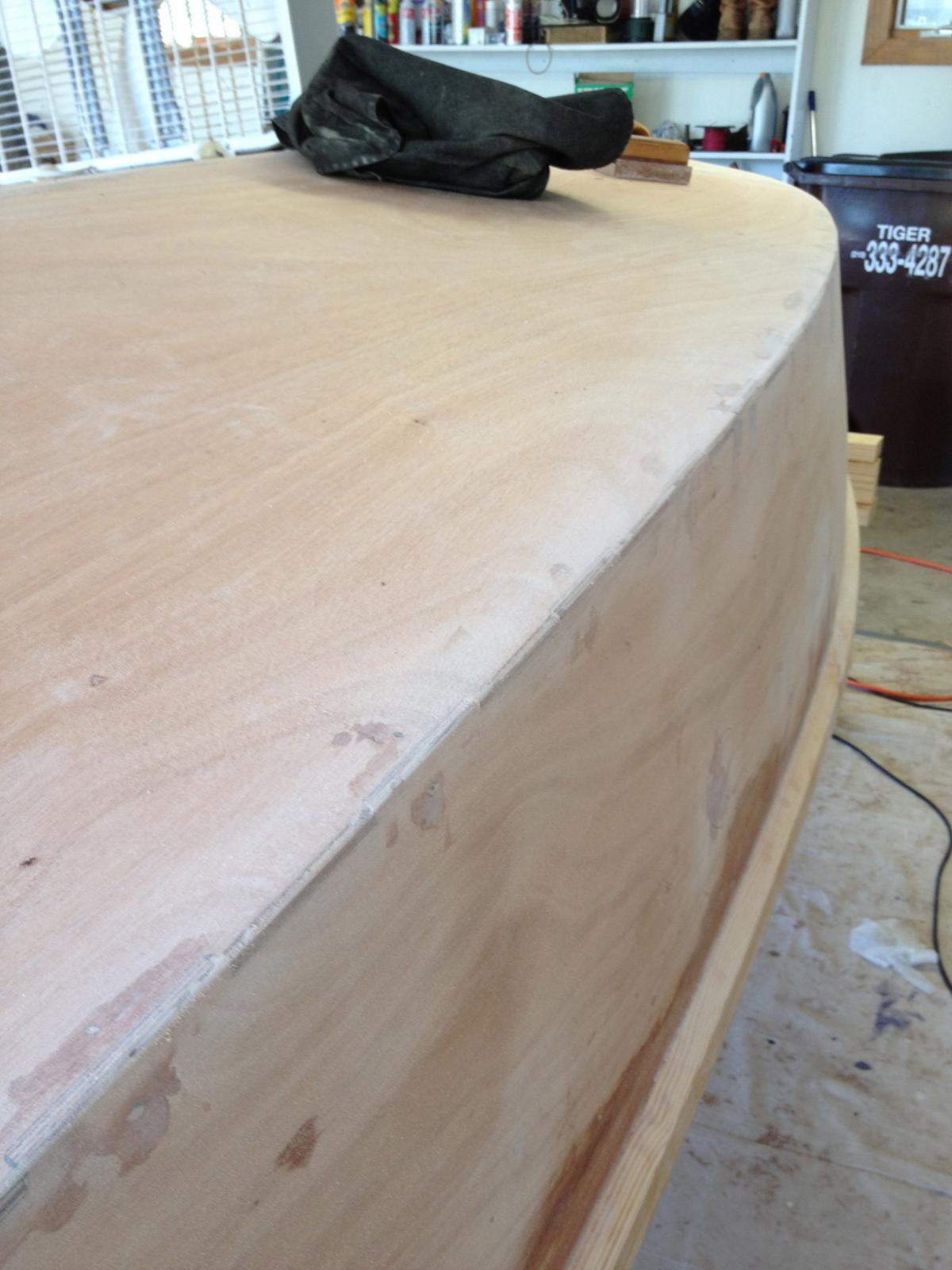

Well, the 3 coats of epoxy went on pretty well after all. I'll sand lightly before applying the primer. Painting question: I'm going to go with Interlux Brightside or Perfection. The Perfection is a 2 part epoxy and costs about double what the Brightside paint does. Since I'm probably going to go with 2 colors on the hull, and an off white on the interior, costs are becoming a consideration. Does anyone have any experience with these paints, and is the 2 part Perfection line worth it or needed over the one part Brightside line? After all the work I've put into this, I don't want to 'cheap out' on the paint now, but the two part with additives will be pushing $300 or so. I've zero experience painting a boat. Tim
Thanks for all the advice, guys. I'll see how the first coat goes on, and if rough let it cure, sand with 80 grit and follow with the other coats. Hopefully, as Alan says it should go one fine from there. I really like the link you gave Howard concerning pre-coating the panels. I'll try to remember to do that on the next boat! There's a lot of other good info there, too. Tim
