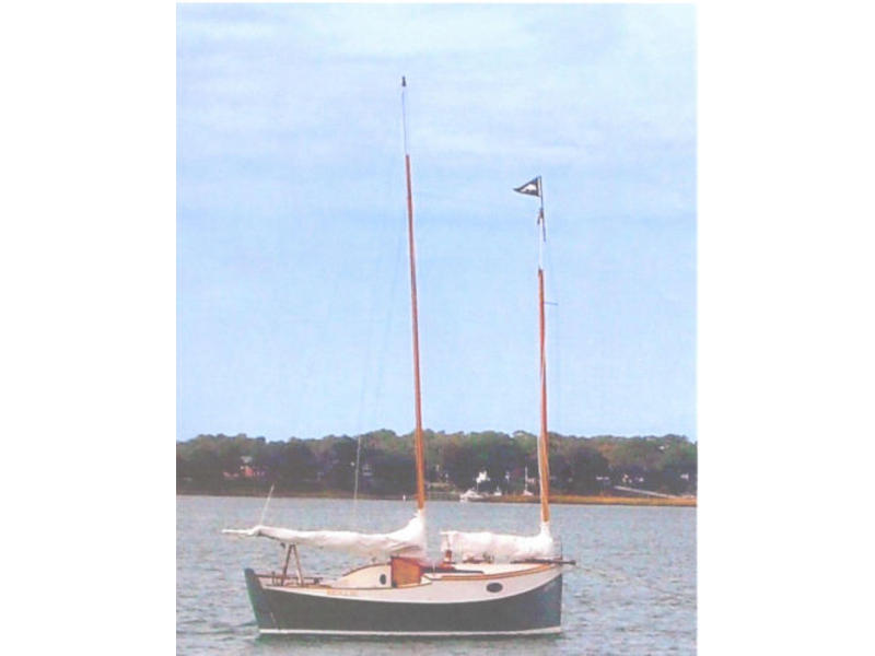

Hello all, I've been looking around for the next little cruising boat, and the B19 seems like the best bet so far -- relatively simple build, roomy, potential for performance, easily trailerable and singlehandable, good support from the designer and the community. Especially the last part. The high level of willingness to help and general tolerance of people's foibles in this forum is admirable. The last is important, 'cause I have a few foibles of my own; notably the inability to leave a good thing alone. So I'd like to run a few ideas past you, and see what you think. The main item on my list of Belhaven mods is the cabin: I'm not a great fan of side decks on smallish boats like this, and tend to begrudge the space lost below. Being able to lean up against the side of the cabin, not hunched over, is very attractive. I would plan on going forward over the housetop anyway. Another factor would be the somewhat increased flotation/righting moment of a raised deck house in a knockdown. There would be some loss in lateral stiffness at the sheer that would have to be made up, somehow. Has anyone done this on one of these boats yet? Considered it? Dismissed it? Attached are a couple of pix showing attractive raised decks, and one, well, not so much :-) I particularly like the Chebacco model. Thanks in advance, Lynn Watson btw, there's a picture of my present boat in the Main Forum, under Test Post..., she's the green double ender.

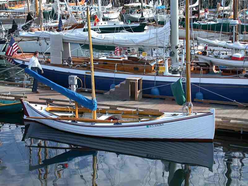

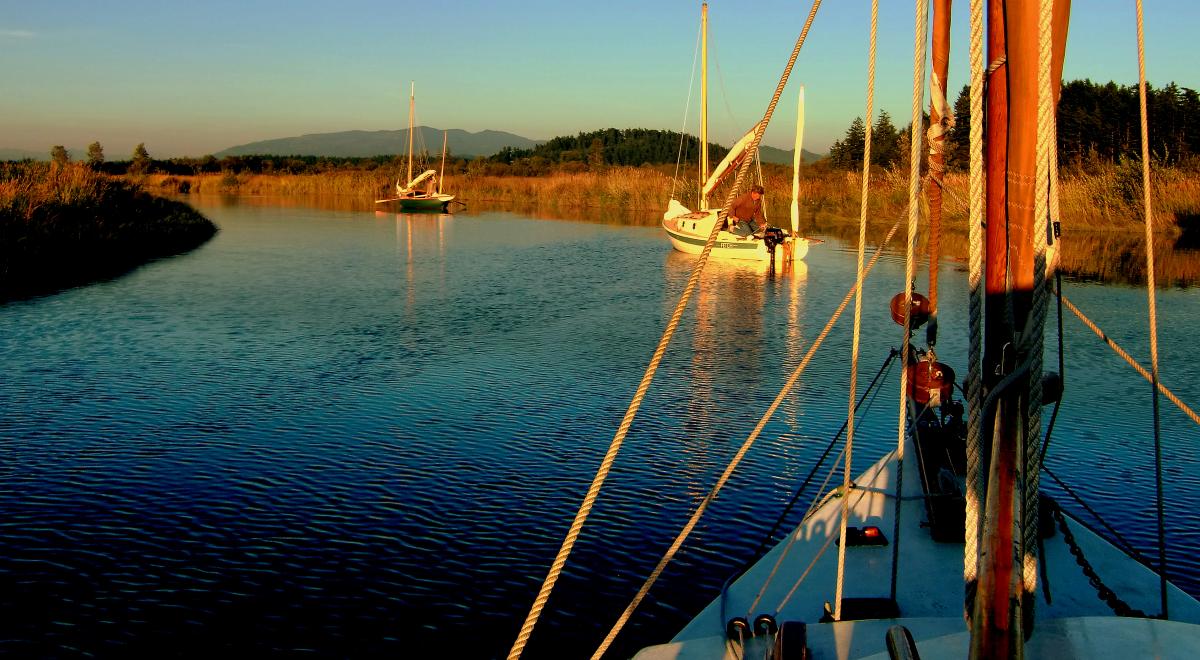

...some beautiful pictures... Thank you. They're just some local shots of some local boats (local is Port Townsend/ Puget Sound). The white double ender is Ernie Baird's Crotch Island Pinky; the "extreme" one from Chappelle's American Small Sailing Craft. The green double ender is my boat Katie Mae, a much-modified Drascombe PeterBoat. The sunset photo is in the Skagit Delta grasslands, taken on a cruise around Whidbey Island; lovely, lovely place. There were a couple of other pix that failed to post; not sure why. Does anyone know what a 500 error is? cheers, Lynn
