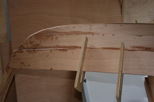

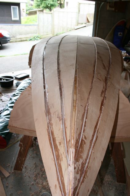

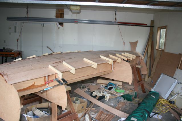

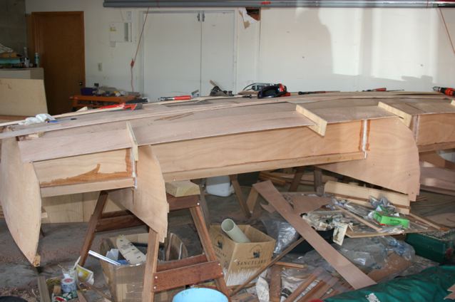

Richard Whitney CS#70 Posted September 6, 2009 Author Posted September 6, 2009 First two strakes laid this weekend. The good thing about doing these two first is that they are on the bottom of the boat - a good place for the learning curve to happen before getting to the bit you want to look really 'fair'. The twist at the stem is tricky with these two. A few mistakes made - but with a bit of filler and paint it will be fine. Nice to have the hull 'locked together' now. Quote

Tom Lathrop Posted September 6, 2009 Posted September 6, 2009 Looking good Richard. Time spent cleaning joints inside the boat is time well spent. Repeat that a few times. The first mark of a nice lapstrake build is how the strakes meet the bow and how fair the gains are. Quote

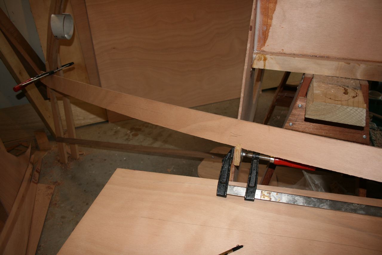

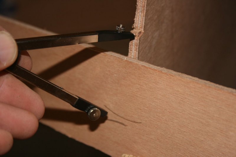

Richard Whitney CS#70 Posted September 20, 2009 Author Posted September 20, 2009 I am being extra careful on my shapes and the gains moving onto the next lot of strakes. I have also been doing some 'spiling' practice. I have now got two battens made of of cut offs from ply that has already been scarfed. Each batten is about 2 1/2 - 3 inches wide. Here are some shot if me practicing getting dimensions at the bulkheads for strake 7. First shot show spiling batten laid across forward bulkhead and stem. Quote
Richard Whitney CS#70 Posted October 18, 2009 Author Posted October 18, 2009 Finally got up the nerve to cut out stake 3 - fits well. I just need to plane the land and cut the gain to be ready to glue them on. The spiling stick method worked well enough to give me confidence to move onto the next one. Quote

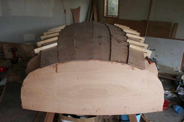

Richard Whitney CS#70 Posted October 25, 2009 Author Posted October 25, 2009 I have completed strake 3 (John T and his boys are pulling away from me like a Southern Skimmer on a broad reach). Good to do the learning on the strakes that will be under the boat. Now I am 'turning the corner' I will need to be tidier on my glueing etc. So far the 'spiling stick' method where I am pulling off the measurements for the strake shapes base on a measurement at the transom, rear, mid and forward bulkheads and the stem seems to be working out well. On to No. 4 (half way is in sight) Quote

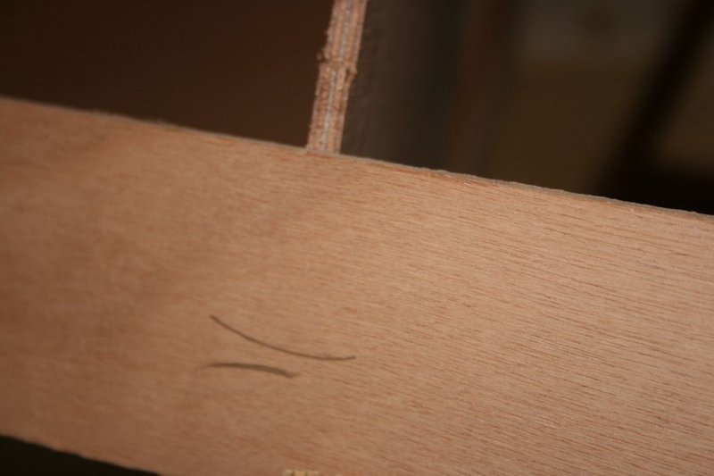

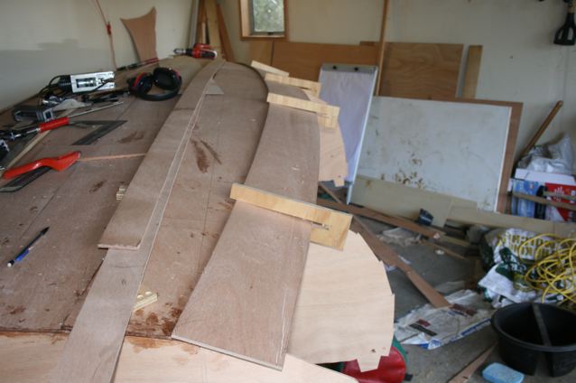

Richard Whitney CS#70 Posted October 31, 2009 Author Posted October 31, 2009 Help - looking for some suggestions. I have cut two mirror image strakes for strake 4. One fits well - the other doesn't. Looks like for some reason I am getting some small differences setting in one either side of the boat. On one side I have to twist and get what I think people are referring to as 'edge set'- on that one side (not the one I took measurements off) I have to bend the stem side of the strake up a bit to get it to fit. This shift the strake at the mid section so it has 1 1/4 inch overlap on strake 3 rather then 3/4 in. Should I just make strakes a different shape on each side - or will this just be compounding the problem. Any suggestions appreciated. Quote
Tom Lathrop Posted October 31, 2009 Posted October 31, 2009 It's difficult to know what went wrong. Obviously the symmetry got lost a bit. The first thing to check is whether the form got twisted a bit to one side. I always have a centerline string to reference this to make sure that the boat stays symmetrical. Of course, it helps to always have this string from the beginning to know if it moved or not at every stage of construction. It's a common problem. I'd check this first. Quote
Richard Whitney CS#70 Posted October 31, 2009 Author Posted October 31, 2009 Thanks Tom I am going back on checking everything on strake 4 measurement. Looking at what I have cut out - both don't quite fit - so the difference may not be as big as I thought. String line still looks pretty good. I have remeasured and think I have figured out what I have done wrong. I had my spiling batten sitting flush on each bulkhead allowing it to form a natural curve. Doing this does not allow for the 'extra' shape that results from one edge of the new stake needing to be defined by the existing curve of the previous one it will be attached to. When I allow my spiling batten to lay along the 3/4 in overlap on the previous strake and pull the measurements off that way I get a different result that I think will be closer to what it should be. I will look carefully before wasting more wood. Would I be best to make each strake to fit the side they are on - even if they are a little different in shape? Quote
