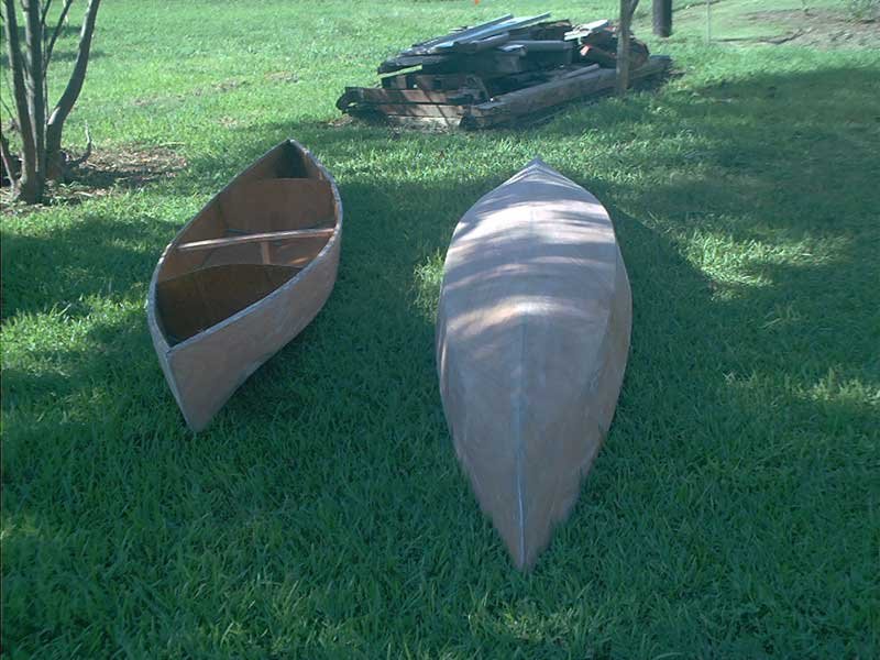

I glassed our Birders on the bottom and sides. Mine got 10 oz on the "football" and 4 oz on the sides. Laura's got 6 oz "football" and 4 oz sides.
Before glassing the two boats weighed 21 and 20 pounds respectively . After glassing, with doublers but without decks, hers is 24 pounds and mine is 26. So it added between 4 and 5 pounds to glass them. WELL worth it for around here.
Waiting for an order of boat nails to arrive so I can put the decks on them. Got the keels cut today, but I'm really debating whether or not to add them. HAVE to do it before decking or I can't get to the bottom for the screws.
