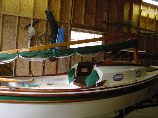

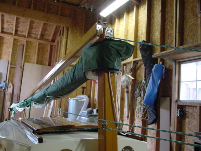

capt jake Posted June 22, 2005 Posted June 22, 2005 I use a cover simular to your when in storage, though I use a cover for the boom/sails when towing. This is the only photo that I could find of it. I made it myself and it works well to keep everything together when traveling. It is installed with a commercial grade zippers after it is laid on the boom. I usually leave it on until we get out into the water. Reinstall it as we are coming into the marina. Ah! I found two others. [/img] Quote
Dave R1 Posted June 22, 2005 Author Posted June 22, 2005 Thanks Jake. That looks good. How far do you have to tow your boat typically? I'd be concerned about the exposed halyards whipping and getting chafed at highway speed. Next week we're planning to take the boat up to the cabin for a sail. That's about a 5 hour drive--mostly Interstate Hwy--without towing anything. I'd worry that all my lines would be tatters by the time we got thereunless they were tucked in somewhere. Out of curiosity, did you make a pattern first? What did you use for the pattern? Quote
capt jake Posted June 22, 2005 Posted June 22, 2005 No real pattern. I took some circumfrential measurements along the boom and went from there. Most of the laryards and sheets are inside the cover, though the ones that are exposed are lashed every couple of feet (to the boom) with straps. I only have to travel about 5-10 miles. 50 MPH is about all the faster that I have gone, though I am sure I wouldn't have any problems taking it further at freeway speeds. Quote
Barry Pyeatt Posted June 22, 2005 Posted June 22, 2005 When Capt. Jake has it all tucked into the sleeve it is a pretty snug and secure package with nothing really to get whipped around. He did a good job on it. He placed pockets and shaped it quite well to fit everything. The front flaps are held together with velcro around the mast stub. I doubt that there would be any cause or worry about chaffing at highway speeds. And it is color coordinated with the rest of his boat. 8) He made a great sleeve to slip the lapper into for travel on its luffwire and with the spool attached. It simply coils up in the forepeak locker for travel. He does use a boom crutch which works out pretty slick for travel. Quote
