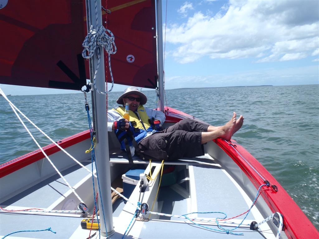

  2. Hi folks, Some time ago somebody posted that there was not much build/in-use info on the CS15. Seeing it was such a nice day here today I decided to take my camera out with me and take some "sailing" video and attempt to post it here for others to enjoy. I mounted the camera on a stick in the rear corner of the transom, not waterproof so I wanted it out of the spray. Next time I'll make the mount a bit more solid and maybe try to rig up some sort of gimbal arrangement. Anyway the result wasn't too bad for the first try. Maybe I'll try to fly the stays'l next time too, although you wouldn't see much of it from this angle. Cheers Dave

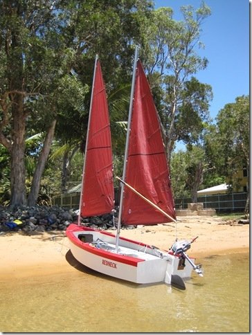

  5. Hi, if you are going to use an o/b bracket you can use a short shaft motor, if you want to mount the o/b directly on the transom a long shaft will fit, with the transom as per the plan. You then have the powerhead sitting fairly high and have some issues with the powerhead fouling the mizzen sheeting. I fitted a 2 hp Yamaha 2-stroke outboard (short shaft) directly to the transom and made a cutout in the transom of about 4 inches to get the motor low enough and minimize fouling of the sheeting. Seems to work fine and doesn't foul the rudder blade in the down position. I chose the 2-stroke Yamaha as it was the lightest o/b that I could find. The attached pic shows the o/b before it was lowered the full 4 inches into the transom.

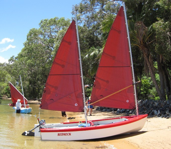

  10. Greetings to all. REDNECK was launched yesterday on Moreton Bay, Brisbane, Australia. The build commenced in May of this year and apart from a couple of trips touring the country, has kept me occupied since then. I did seek advise regarding sail track some time ago and as you can see the decision was made to go with sailtracks instead of luff sleaves. We launched in to 10-12 knots from SW which gave us a good breeze, but pretty lumpy seas with the wind against the tide in the relativey shallow waters. Fortunately I had a crew member to take most of the spray. I am very happy with the way the boat sailed, and looks like not much will need to be changed.

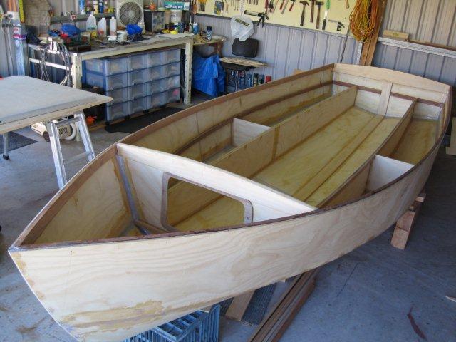

  14. Hi to all the B&B fans, Quick intro, I'm from Brisbane Australia and have commenced building a CS15. After searching the info on this forum I settled on the CS15 as most of my sailing will be singlehanded. The build is well underway and I have just finished installing the sides to the tank/seats, with all going pretty much to plan so far. I am planning on using two-peice masts with the bottom 10' being alloy and the tops, tapered timber. Does anyone have any comments regarding the use of sail track on 2 piece masts, mainly regarding getting the sail slides passing the joins freely etc. I have read the recent info regarding PVC sail track but would think this may be even more critical to align and keep free from damage around the joins when using 2-piece masts. Will try to post a pic of progress to date....
