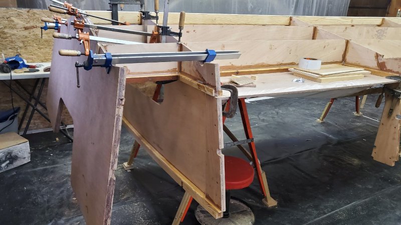

  12. Hi everyone - we received the lumber and the plans and my Dad is hard at work ... attached are a few quick updates. I set up a blog post series on my blog that I'm adding details - feel free to check that out! https://hammersandchords.com/building-a-center-console-18-foot-boat-and-reading-the-directions-afterwards/ I set up a blog post series on my blog that I'm adding details - feel free to check that out! https://hammersandchords.com/building-a-center-console-18-foot-boat-and-reading-the-directions-afterwards/
