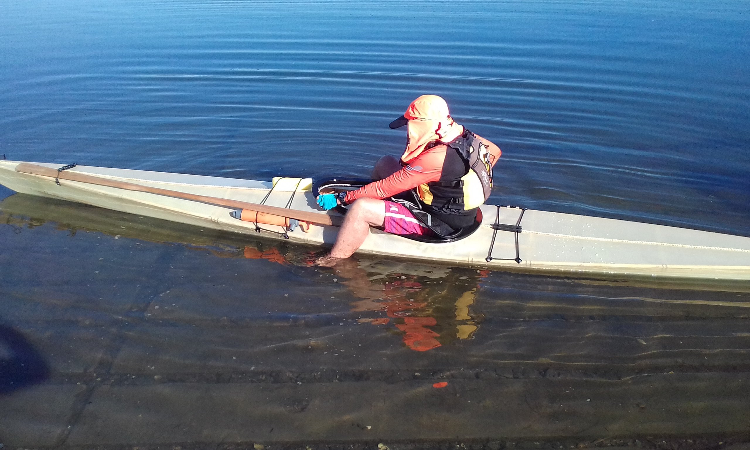

Hi all good Kudzu Craft folk, I have had my Shad out a few times and I am getting to know it better. I have just posted some launch shots. I figure that after two hours on the water (salt water) I have about one cup of water in the boat. A bit of this has come off my rubber shoes and some is from drips that come from the paddle and through the spray deck but I think half of it is coming in from somewhere else. The Shad skin is Jeff's 8 oz polyester with five coats of single-pot clear polyurethane rolled on. So, let us say that I have half a cup of water coming in over a two hour paddle. Is this normal? Is this within an acceptable range? Can I expect to achieve an absolutely waterproof skin? Should I consider applying another couple of coats of polyurethane? I would like to know the experience of experienced skin-on-frame paddlers. Cheers, Denis
My Shad was launched on Lake Illawarra about six weeks ago. Lake Illawarra is a large lake that can become quite bumpy but I managed to launch on a day when the water was like glass. It was tippy when I first got in (bum first entry) but I find it quite stable when I am under way. I have had the Shad out a few times now and have tried it in small surf near where the lake enters the ocean - it tracks well and catches and rides waves very nicely. I think my next build will be the Short Shot - any thoughts? Cheers, Denis
