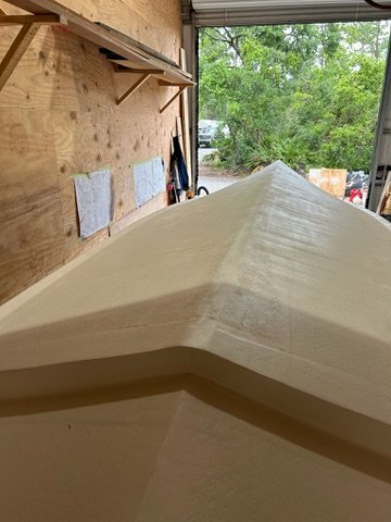

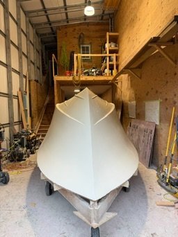

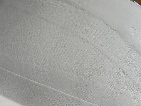

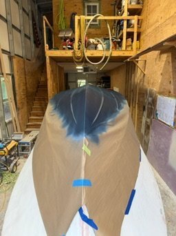

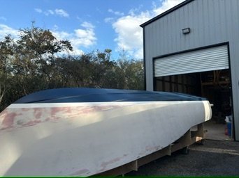

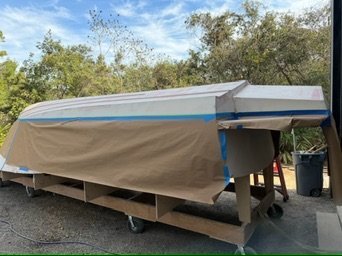

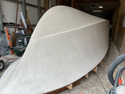

  1. After sanding the first coat, shot the second. Now to fill and sand all the little pin holes and other little blemishes, longboard and sand it all over again, and spray it one more time with primer hopefully, then the Brightsides. Still working on the oars, got some sweet stainless oar locks at the world famous Sailers Exchange here in town for a smooth 40 bucks.
  2. Kept raining off and on yesterday, so no paint. I did get the final coat of varnish on the mast, started making my oars, and sanded the prime coat on the boat so not a huge waste.

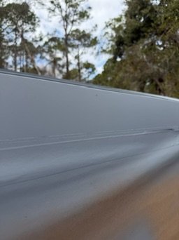

  3. Finally got a coat of primer on the thing! right before the storm to boot. Interlux 404 Primecoat epoxy primer with 2316n reducer (i think) sprayed with a Fuji 3 stage turbine with a 1.8 needle in the gun, thinned to 25%.

  11. What a great wealth of knowledge gone, spoke with him several times, he even offered to give me a few things. So sad, we will all be worse off with out him on these forums, I learned a lot from his posts. Fair winds and following seas Paul. Hulsey
  12. Think I will just buy a gallon of Interlux 404, West Marine has a match the price thing going on, and the store in town has some. The boat has been sitting for 3 weeks at this point ( I go home tomorrow) but I still will be putting some epoxy here and there when I get back and do not want to wait another couple of weeks, I only have 3 off as it is. Thank you all for your imput
  13. Sounds like I made a 100 dollar mistake, not the first and Im sure not to be the last.
  14. What about a first coat with the Epoxy Primekote and then Pre-Kote on top for sandablety- new word!
  15. Gentlemen, As I set here at work obsessing about the paint job I will be attempting when I get back to land, I may have a problem. I bought Interlux Pre-Kote and Brightsides to paint the boat with and while going over the data sheet, I found this on the last page: Compatibility/Substrates - Apply to clean, dry, properly prepared surfaces only. Do not apply over clear epoxy such as Epiglass Epoxy. For epoxy resin, use Epoxy Primekote Y404 as primer following proper preparation to the epoxy resin Ugggghhhh..... I have, I know read about many people using it over epoxy, is Interlux worrying about the epoxy blush? Is it "that will not work, buy the more expensive stuff" ploy? I have already bought the Pre-Kote and would not like having to buy another gallon of 100 dollar primer, plus I wanted the high build aspect as well, the boat is pretty fair but I wanted "smooth as a women's lower back" surface and from what I've read the Epoxy Primekote 404 is not very high build. Dont want to screw anything up at this point so close to the finish line. Please advise
