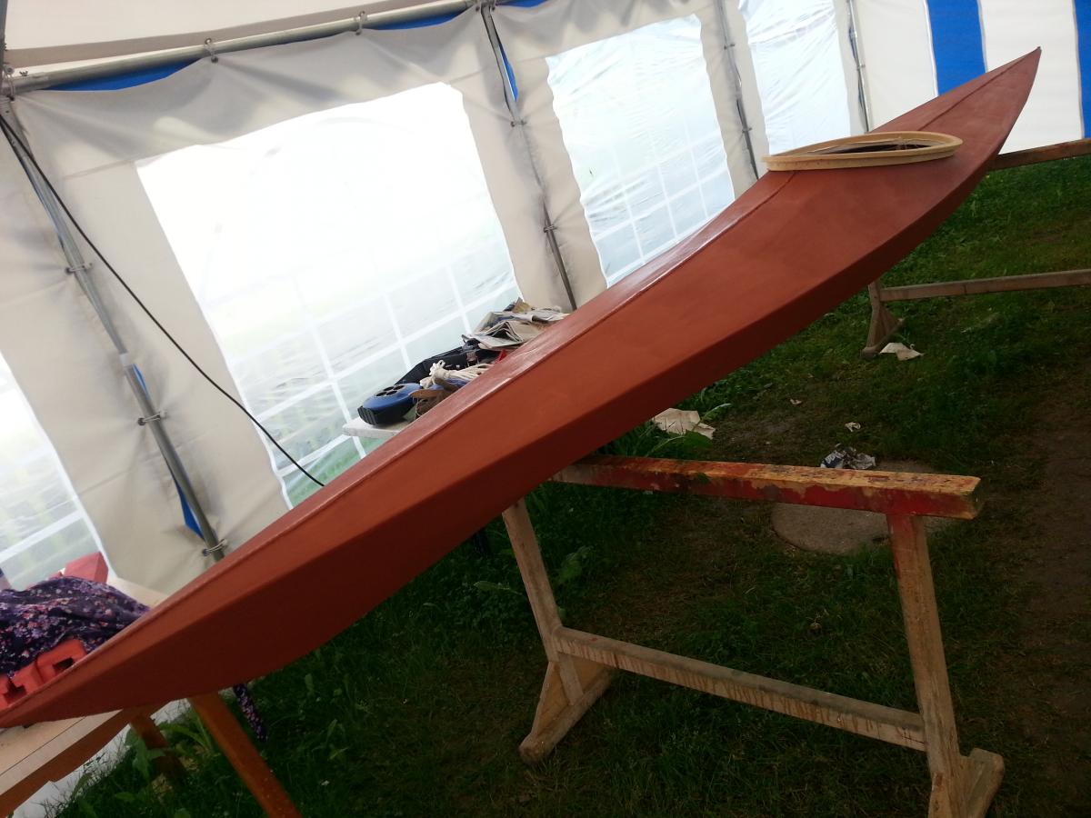

  1. At last, my Vardo hit the water! The coaming works great. I did a mixture of laminated ash veneers and an upper ring of plywood. Glued together with epoxy and for safety reasons, assured it with 20, or so screws. Should last for at least one generation... :-) The first, who tried the boat was my son, followed by myself and my wife. We had a great time, playing on the water of the beautiful "Staffelsee".
  2. Sadly, the coaming broke, when I first tried to put it on my boat, so I tried to repair it, but it didn't really work. So in the last two weeks, I experimented much, to make a new coaming. Hopefully, I can put it on the boat next weekend. Then it will be ready for a real Vardo launch at last!!

  7. Ready with th sewing! All the stitching is done. Yesterday, I broke the coaming. Thank god, nothing serious happened and I had to glue it over night..
