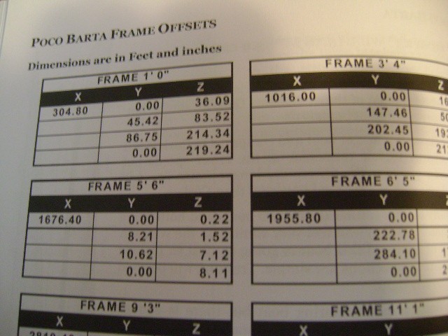

  4. Let me ask you this Jeff. I want a very stable Kayak plan big enuff for a guy like me, 6'4" @ 212lbs. Would the Poco Barta do that for me or would you recommend a different design? Not looking for a race boat but a cruiser.

  10. I was transferring loftings to paper when I found a descrepency in one of the lofting numbers. In the book: Fuselage Frame Boats A guide to Building Skin Kayaks and Canoes by S. Jeff Horton on page 60 the lofting numbers should be gettting larger as the frames progress and smaller towards the stern. At the 5'6" frame the numbers are small. They should be bigger than the frame at the 3'4" station. Now I have to do some figuring to get the next set of numbers. Any thoughts? I have included a pic of the page.
  11. I was transferring loftings to paper when I found a descrepency in one of the lofting numbers. In the book: Fuselage Frame Boats A guide to Building Skin Kayaks and Canoes by S. Jeff Horton on page 60 the lofting numbers should be gettting larger as the frames progress and smaller towards the stern. At the 5'6" frame the numbers are small. They should be bigger than the frame at the 3'4" station. Now I have to do some figuring to get the next set of numbers. Any thoughts? I have included a pic of the page.
