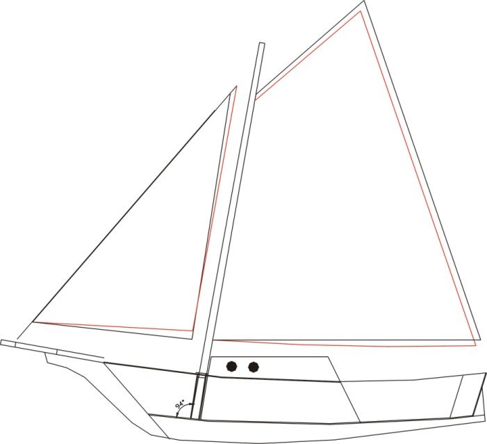

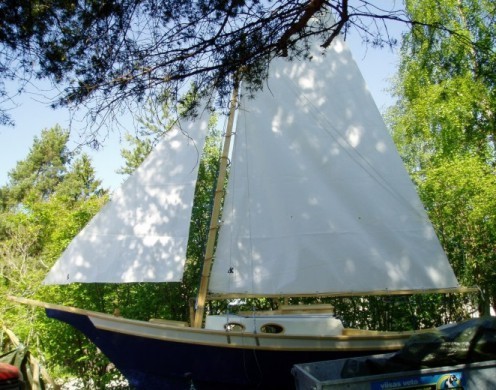

  1. I checked the mast angle yesterday and it was 94 degrees. "Only" one degree too much. It could be bended backwards in hinges on degree too? Who knows? Then I checked the sail dimensions. The lowest side ,which comes to boom is not cut like strait line,but it

  3. Hi Intresting reading. My boat is in winter garage about 100 miles away. Have to go there in some weekend and check the mast angle. I remember that I try to be quite accurate when I assembled the mastbox. I made 93 degree gauge with plywood and used it. But there can still be some degree error - have to check that. I watch my photos and maby the mast is bend backwards little in hinges. I read Franks post and he said that his boats boom was obove his head when sitting in cocpit. The pictures with his mail had vanished somewhere. My boom is in quite same line with my shoulders. And the boom is quite same line with cabin roof. The sails are maid with orginal plans with professional sailmaker. But when I measured the jib it is little smaller than in plans. I havent check the mainsail yet. The clubfoot seems to be little too short too? - or I have misteken with measures. Here are some pictures for boom line and tiller postion when sailing. The pictures are taken in front so - its not the same situation than sitting in cocpit.

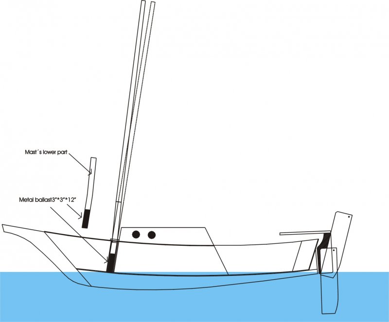

  4. Hello I have spend some time using search and reading old topics about making modifications to make weekender in better trim. I think I have too mutch weather helm - the pressure in tiller - if I have understand things right. Especially when sailin boat empty and fast. When we had the boat full of gear ( extra batterys etc ) I think it was quite good - at least mutch better. So I found instruction here to reduce the weather helm by bending mast forward and add some ballast in front. I think my mast hinges wound stand bending so it would be easy to make masts lower part with curwed profile. Now I have the battery (39lb), anchor (11 lb), in front - and outboard ( 22 lb ) in back. The mast foot could be made in metal about (22 lb ). I dont know how mutch these weights matter and woud it be too much just in front of boat. Maby something easier removable could be better. I have beach trailer and it needs more power to take the boat of the water, than using car trailer ( because car trailer goes under the boat in water ) - so I dont want to put much more weight in the boat. I'm also doing new rudder hoping that woud help. The one I
