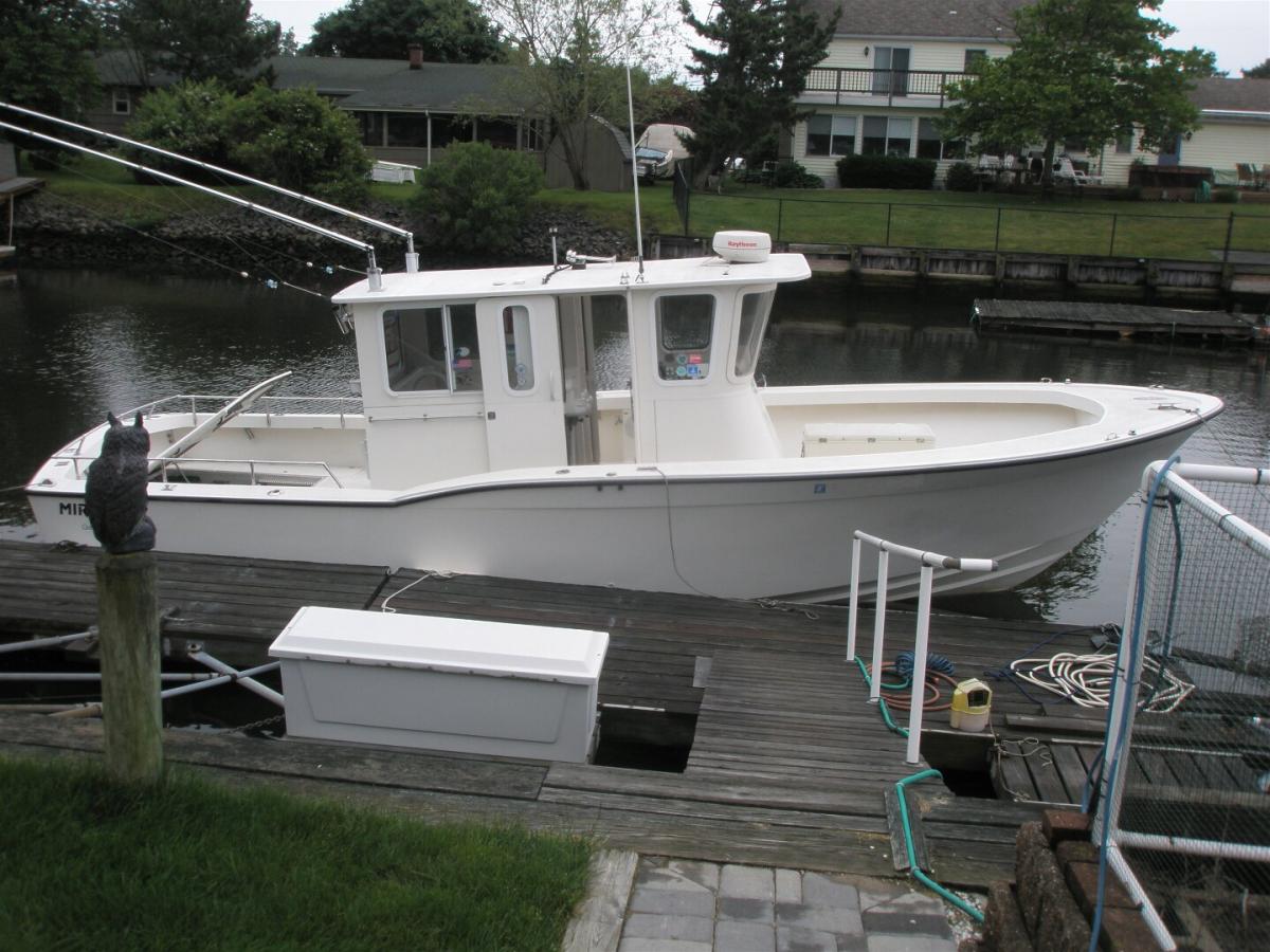

  4. Something very much like the pilot house Mirage 32. I know it will be tight but with a beam just shy of 10'. With a pilot house about as wide as the cab of a full size truck.
