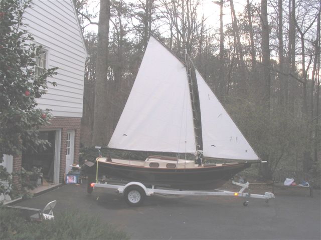

  6. well all i read sounds familiar. i too am having problems with tacking and attributed it to a lack of forward momentum. my boom seems low, but when i compared pics of my boat with others, the mast rake seems ok. i think it is very difficult to measure the mast rake relative to the waterline. take a look at this pic of my rigged weekender on trailer and tell me what you think about the mast rake/ boom hight.
