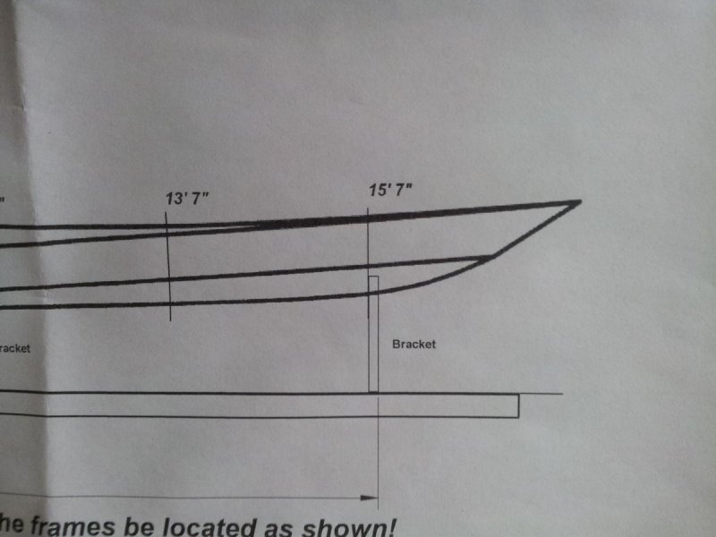

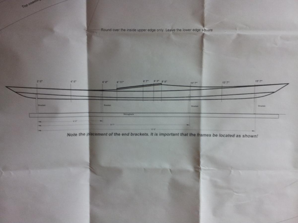

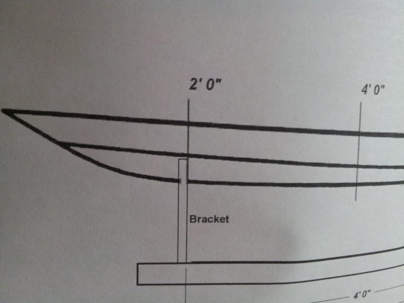

  16. I'm pretty sure I have not swapped the bow and stern. I thought of that, but I am working from full-size plans that I purchased from Kudzu. Also, as I removed the paper patterns from the cutout plywood pieces, I wrote what each piece was directly on the plywood to keep track of things. I have compared my bow and stern shapes to some pictures on the Kudzu blog website and mine appear to match up. After studying the problem over the past couple of days, I am a little stumped. It seems like no matter how I consider modifying the bow piece, it will tend to impart a slight downward bend on the gunwales. My expectation is that the gunwales should continue to sweep up all the way to the tip of the bow. Is my expectation right or wrong? Is there anyone who has built the Shad that can let me know if they have run into this issue? Thanks

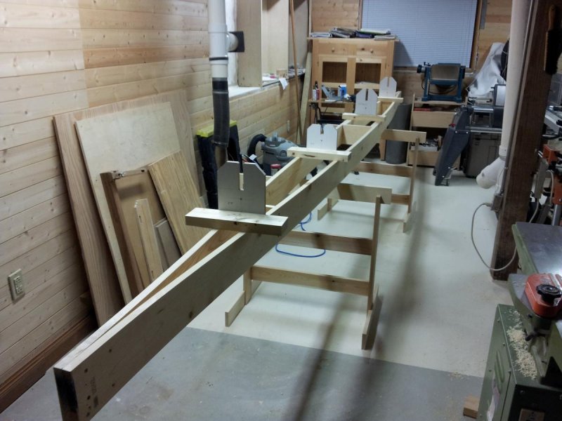

  18. Thanks for the quick response to my question. I will follow the plans as you suggested Jeff. The plans have a specific note stating to install the frames on the end backets as shown. It shows the frame located at the 15'7" position being located on the opposite side of the bracket versus all the other locations. The plans also show the measurement for the 15'7" bracket being taken on the left side of the bracket versus right side for all the other postions. I have included pictures of the plans and a picture of my strongback. Thanks again.
