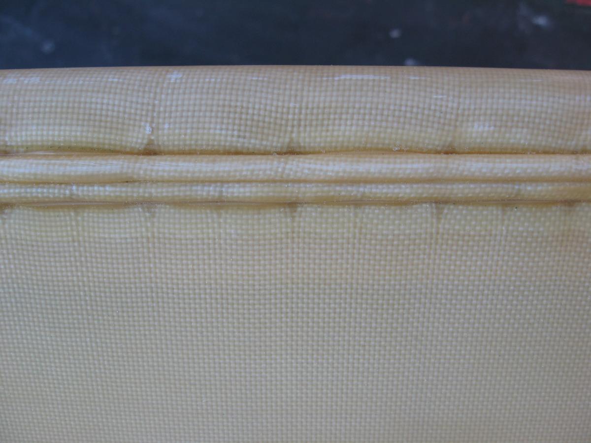

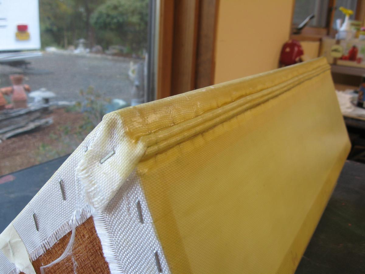

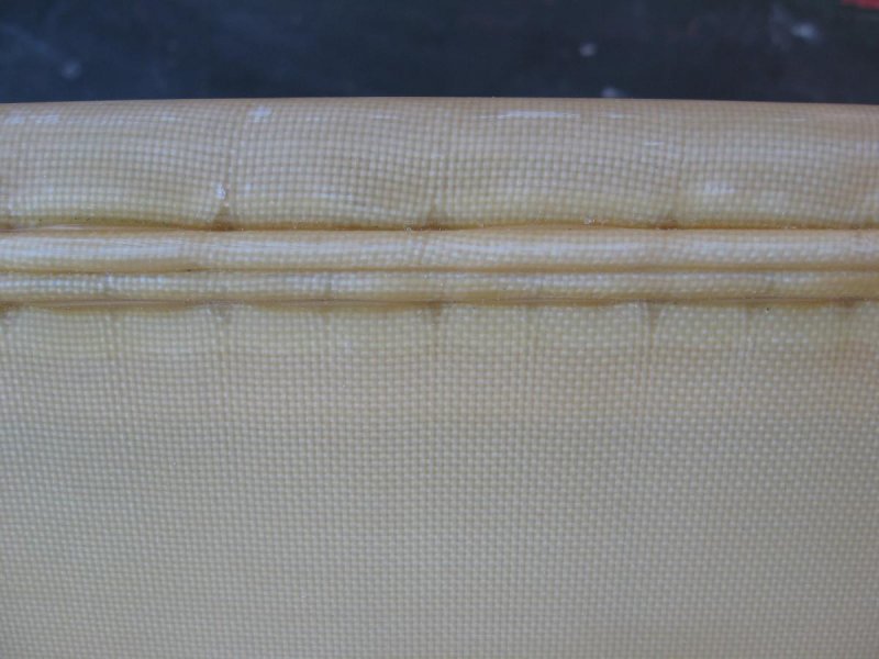

  5. Here is another option, sewing the skin to the gunwale. Attached are two pictures of a mock up to see if this method would work before trying it on a kayak. The bottom was sewn on first. The fabric was wrapped around the cording, which is weed trimmer line and sewn to the gunwale, very similar to sewing the the fabric to a coaming. Then the top was wrapped around another cording and sewn to the bottom cording. This method took 18 hours to sew a 17' Yost Sea Rider, not counting sewing the coaming. If I were to use this method again I'd sew on the laminated coaming before sewing the top to the bottom. As it was there was just enough material to sew to the coaming. Also, the last few stiches at the ends were hard.
