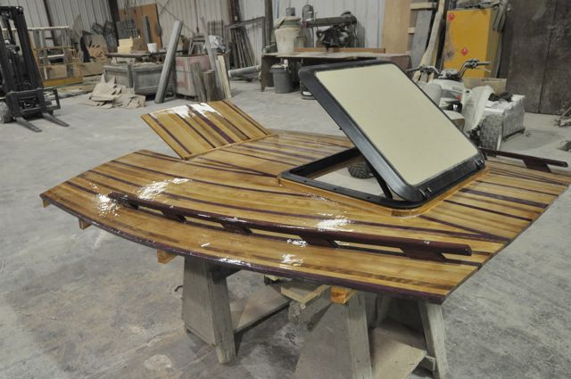

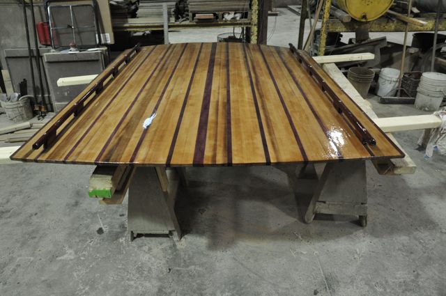

  1. Hi Jim, I think 1200 to 1400 lbs dry weight is very achievable. I used 3/4" purple heart, maple and walnut for the cabin top, pilot house top and trim pieces. The 60HP Evinrude weighs 260 lbs alone. I don't know what the weight of a 25HP motor is, but I'm sure at least 100 lbs could be shed there alone. If I reduced the amount of fibreglass and epoxy on the inside of the hull, a lot of unnecessary weight could have been eliminated. My dry weight also included the down-riggers and a couple of cast iron hatches. Kind Regards, Ron

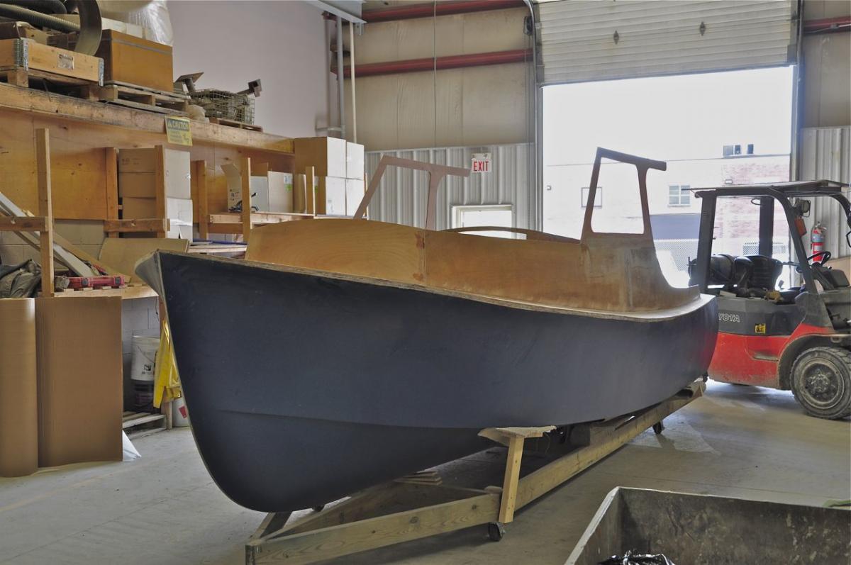

  4. My little project finally came out into the big bad world. The Canadian registration arrived last week, so off to the sign shop we went. After that, Ronny's raft was chauffeured up to Doe Lake to have the electrics rigged up. Hopefully, it will be ready to have a test run on our July 01 Canada day long weekend in Blackstone Lake near Parry Sound. If all of this goes as planned, the OB20 will reach it's final destination in Wiarton the following weekend. Regards, Ronny B
  5. I can't believe that my last post was in the middle of April. The engine did finally get installed closer to the end of April. The helm console was made out of an old medicine cabinet and a piece of walnut. The fuse block and connections should all fit in there. I found it necessary to build another console on the port side to fit both a stereo and the chart-plotter/GPS/fish finder. The red glove box is a chimney clean out and the bottom spare battery holder was a 40's milk box from a home demolition. All these little hatches and access doors were all relatively inexpensive. Official marine access doors are just stupid expensive. It bothers me that putting the word "marine" in front of any product is some kind of licence to triple the price. I could have just made all these doors out of plywood, but it wouldn't be nearly as interesting The consoles do look a little eclectic and weird, but they certainly are original. I am slowly running out of scrap pieces of lumber in the wood shop. This OB20 has darn near every species of wood that is commercially available. The seats are all mounted on swivels for doing whatever is on the agenda, fishing, chatting or travelling. The speakers are mounted in the seats and can not be seen in the pics. Several conduits run from the transom to each console and between all seats. The engine works, but the rest of the electrical needs to be installed. This is something that I don't care to play with. The downriggers and some other things that just hook on to the battery with in line fuses are fairly simple. The lights, horn, bilge pump,stereo etc, I have no interest in. I am hoping to have Ronny's Raft in the water by July 1st. I'll keep everyone posted. Regards to all Ron

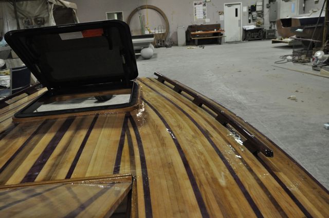

  9. Things are moving along on the OB 20. I finally got back at it in January. The laminated cabin top and pilot house top have been hard mounted. Windshield frame has been cut out and installed. Side windows have been reinforced and ready for tracks. Gunwales are laminated and mounted as well as a stainless steel bumper guard (same material as the keel strip). The toe strip around the deck is also installed. I have ordered an Evinrude Etech 60hp and a trailer. The next steps involve painting, glass, console, live well and finding some marine electrician to help me figure out the electrics. I'll keep you all posted with the progress. I have owned boats that have had electrical issues, and it can completely take the fun out of boating if fuses pop and motors don't start. I took a course this winter on making paddles, and the port holes on Ronny,s raft could be converted to oar holes.(Just thinking out loud). By the way, whats with this "polar vortex" thing. Mars has been rather balmy compared to Canada lately. I have never seen this much snow or been this cold, ever! Kind regards, Ron

  12. A little update on Ronny's Raft, Not a whole pile of progress since the last post. Cabin top now has a raised section to support the hatch. Cabin access door is made from the original piece that was removed. I was going to make a flat access door to act as a small table, but stuff will just end up all over the dash and windows. Around these parts, advertising drinks on the dash is not a good idea. We'll stick with a discrete table at seat height. Six ounce cloth went over both pieces along with three coats of epoxy. A final sand and satin varnish will be next. I'm not a big fan of the high gloss. It makes everything look like plastic. In the snap shots, the glare off the shop lights make it very difficult to photograph. I also made the grab rails out of purple heart and mounted them with 1/4x3" stainless bolts. The first coat of primmer was also applied to the deck and cabin sides. Regards to all, Have a great weekend, Ron

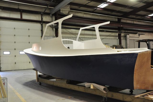

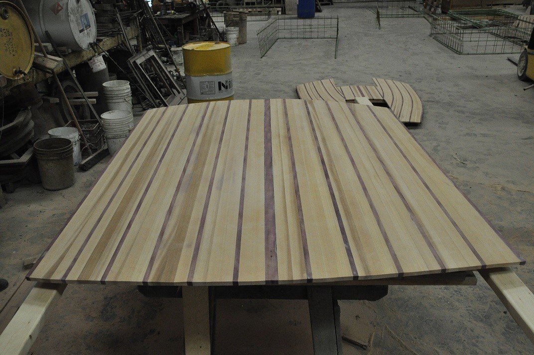

  15. Ronny's raft update, I finally got back at it for a weekend. The cabin top, pilot house top and windshield were dry fit. So far the most challenging part of this build was trying to fit that two piece windshield on the boat. It's my own fault because I changed the thickness of the cabin top from 3/8" plywood to 3/4" laminated cedar and purple heart. The plans included an expanded pattern of the windshield and measurements were clearly shown on the drawings, but wow, that was complicated. I could have made it fit quite easily, but custom warped glass is not in the budget. It is still not 100%, but nothing that thickened epoxy and trim can't fix anyway. The whole works was taken apart and put on saw horses to sand. The hole is cut out for a pre fabricated hatch in the cabin top. A section is also cut out behind the windshield to allow for easy access to the foyer of the master bedroom, (with en-suite I might point out). All is sanded and will be finished bright. The next step is to sand, prime and paint the cabin. This will be a lot easier with the cabin top removed. Who knows when that will happen, but that's the plan. Regards to all, Ron

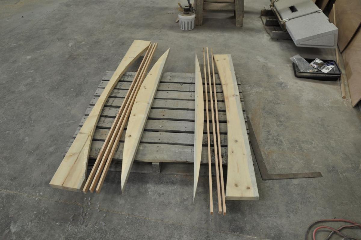

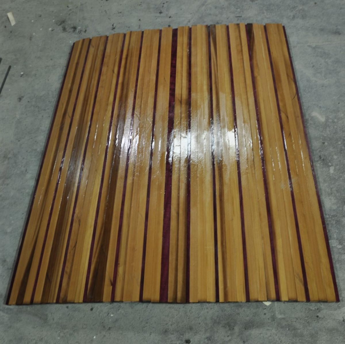

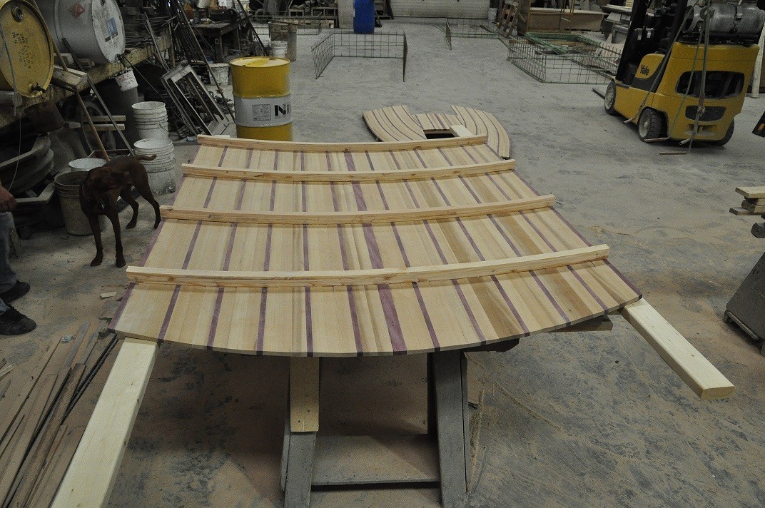

  18. Ronny's Raft update, I laminated all of the pilot house and cabin beams (3 strips of 1.5"x.5" fir). All of the beams were dry fit on the OB20, secured and removed again. I plan to finish the tops bright, using cedar and purple heart strips. Laminating, sanding, epoxy work and trimming will be much easier to do on the floor instead of jumping around the boat. The strips are 5/8" thick, and will add some weight. It will, however, reduce the amount of under-structure support pieces required, and the cedar is very light. The tops will be awkward to put on, but the overhead cranes in the factory will save me yet again. I do have employees that would be more than willing to help, but would prefer not to involve them in this build. I obviously have no friends either, until the OB20 is in the water. A hatch for the cabin top has been ordered and should be in on Friday. Six round port lights have also been ordered for the cabin sides. I would like to have all these things dry fit before all the sanding and painting starts again. Regards, Ron

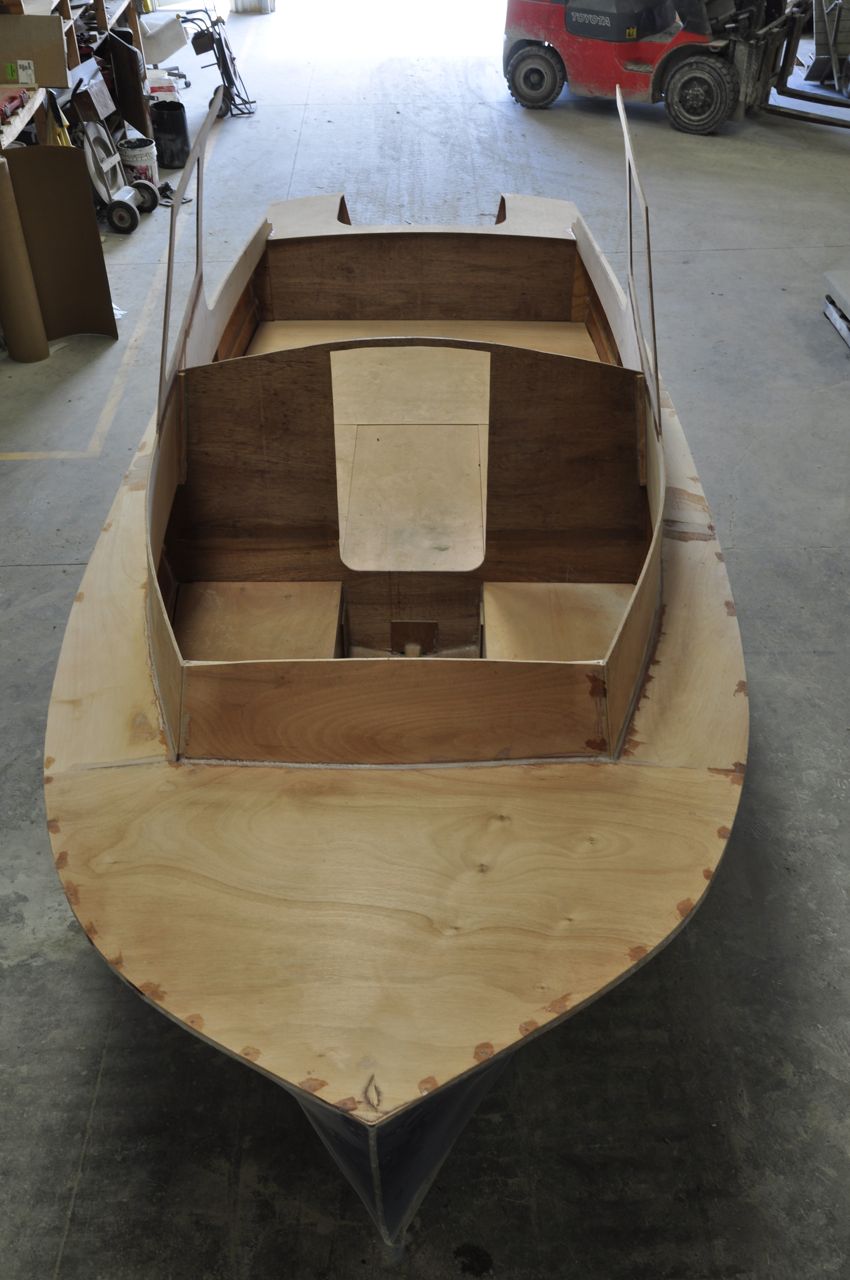

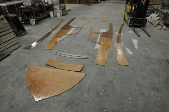

  21. A little update on Ronny's Raft, I finally squeezed in an uninterrupted weekend on the OB20. The transom now has a sporty looking cutout. Four "hanging knees" are installed to support the deck and cabin frame. All deck pieces are cut out and dry fit as well as the cabin front, sides and pilot house sides. I hope to have next weekend as well to attach everything. If all goes well, I'll update progress again next weekend. Regards, Ron

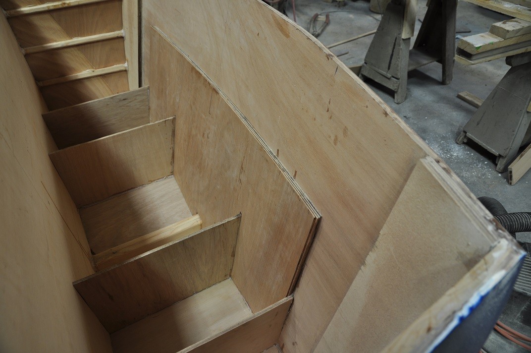

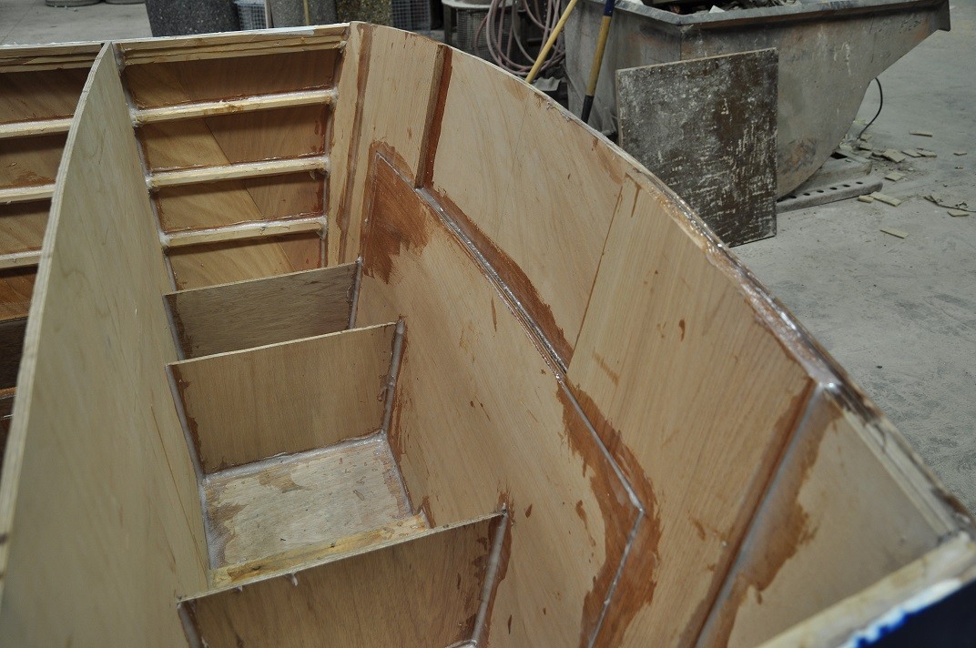

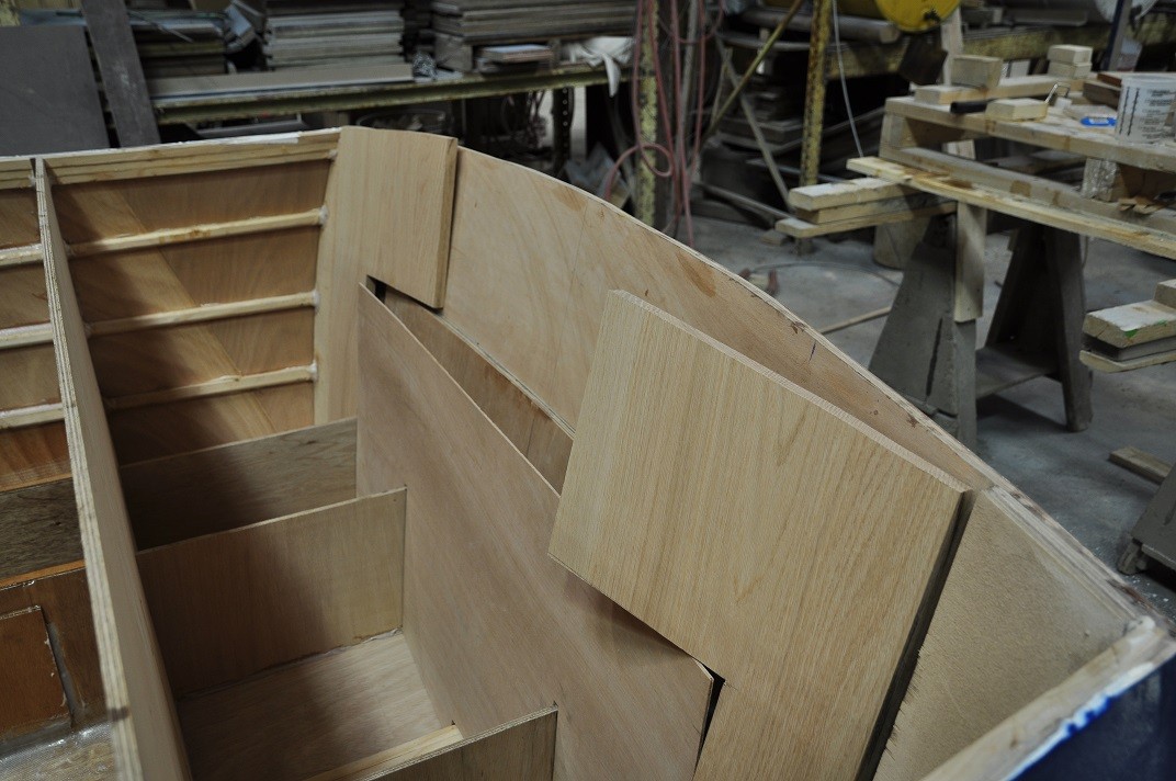

  23. Some pics of how I dealt with the transom. It still needs to be gassed in, cut out, and currently consists of 9 layers of 4mill ply. The OB20 will be hoisted in and out of my little boat harbour annually. To facilitate hoisting, I added two solid pieces of 3/4" oak, (yup, oak). Lifting rings will be attached through the transom. The boat can now be easily pushed around on it's jig with wheels and the fuel tank will be located forward of what is indicated on the plans. The motor will be in the 250lb range plus 25 gallons of fuel will make the back of the boat disproportionally heavy.(I think) Regards, Ron
