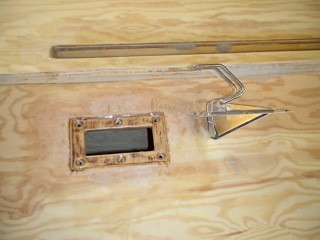

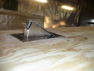

  4. Hi! This is how I did it, after the holes for bailer and screws I made a recess in the hull for the baseplate and a layer of glassfiber/epoxy.
