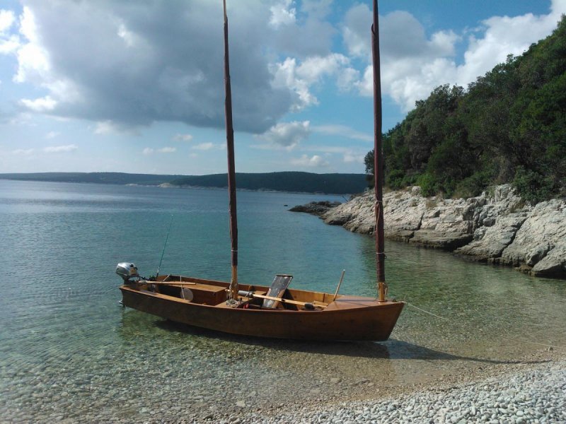

  14. must be a great tour, do you rented the boat in Italy? last year I could feel the bora on a ferry ship and on the shore, very very impressive, strong fall wind with force 8-9 + heavy gusts, I am warned now!
  15. You boat looks great.Is that a daggerboard in your BRS15? Please tell about it and how it works! Thanks, Hi,it was real the first project with wood, I had no tools, no sawhorses, no clamps, nothing, just the plan and the book, modern wooden boat bulding with WEST SYSTEM. I started this project in a DIY market and bought a drilling maschine and a jigsaw..... After a long building time and much visits of the DIY market, I hasn't the persistency to build the complicated centerboard case, and also I don't want to cut the big slot in this new hull....so I decided to build the simple daggerboard. For the board I used a form board for cement building, straight and very strong, it works since ten years and some groundings... if this happend, I have to loosen the main sail very quick. I drilled two holes in the board, so I can hold the board in different positions with a simple pin, depending of the water deepness. I hope you can understand my discription, my english is not the best one. Regards Ralf
