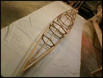

Rookie

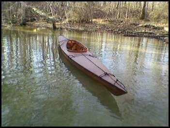

  5. It Took about 1 1/2 quarts to finish my boat.
  6. Thanks for the comments. It is 8 oz polyester skin. I adden the stain to the zar before applying. Thinned the first coat then 2 more coats full strength. The thinning probably was not needed but it did soak in the fabric good. 27lb rigged and ready for the water. I am 245lb and it floated me with plenty of freeboard.
  7. We built the frame in his shop only so I could give him instruction. lol
  8. ZAR exterior poly tinted with mahogany stain
  9. Just completed the vardo. Took it for a short paddle in my pond. Tracks great, very stable, turns like a battleship, but hey it aint a white water boat. I am well pleased with it.
