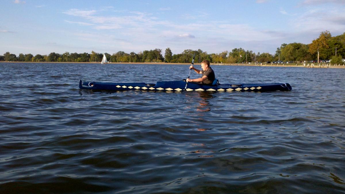

  17. I like the paint job too, it was not exactly what I had in mind but it ended up that way. I wanted to use Zar with some blue pigment added they had Zar at the hardware store but said they could not add color to it because they only had water based pigment. So I went with the blue Rust-Oleum. with a few coats of Zar over it. Hmmm, I am not sure if they were correct about not being able to tint the Zar though because they did offer to tint the Rust-Oleum.......and its oil based. Anyway the diamond shapes on the side are white paint covered with reflective paint. Diamond shapes were about the only shape I was capable of painting ;-) and of course I added eyes like ones I saw on a flying tiger. It took me a long time to build it. I did not have any wood working tools or experience, that and I was busy with a lot of other things at the same time. My son (in the picture) wants one too so its likely I will make another one over the winter. OK, lets see how it likes 340 miles on the Missouri next week. *Jay*
