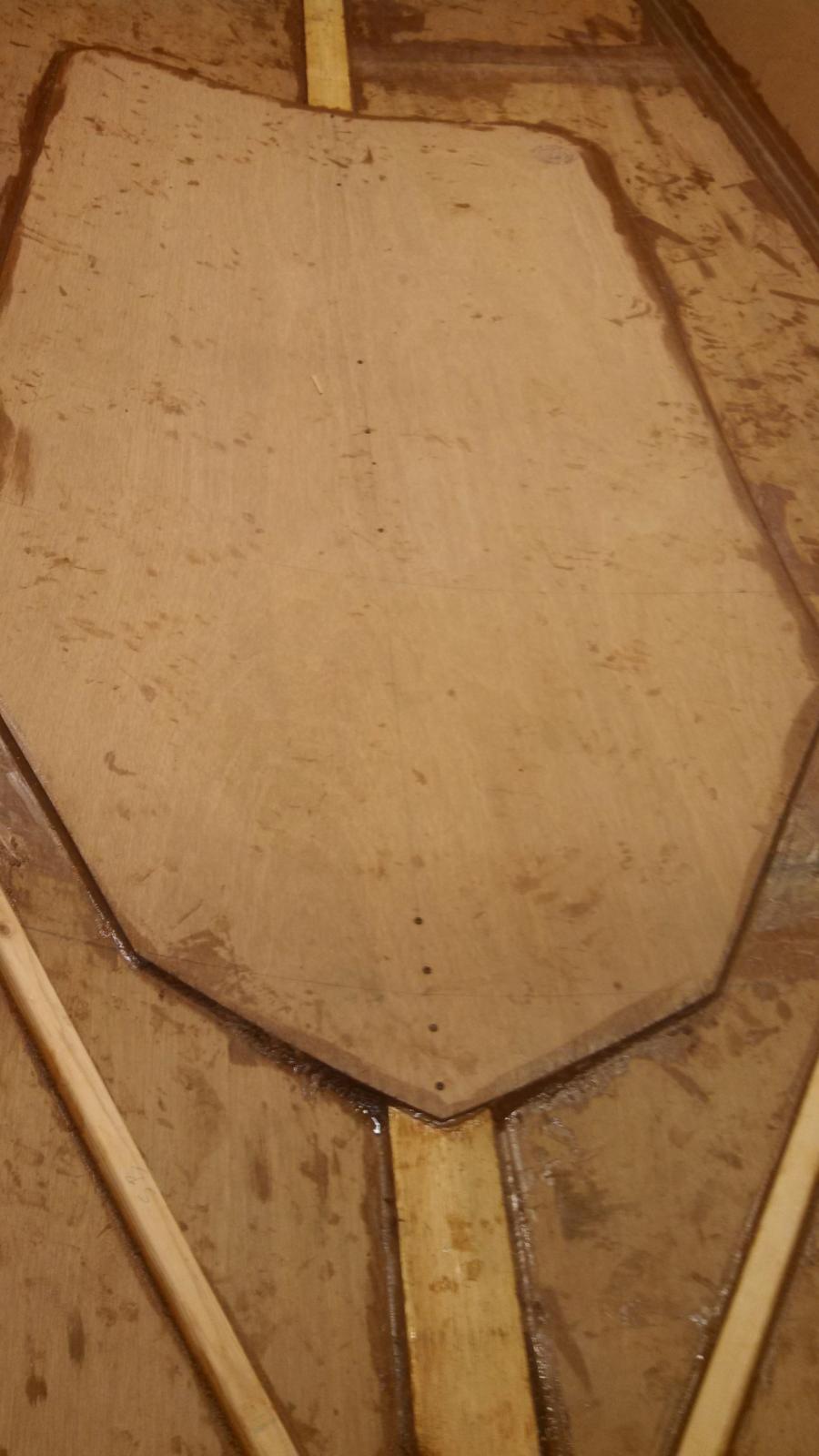

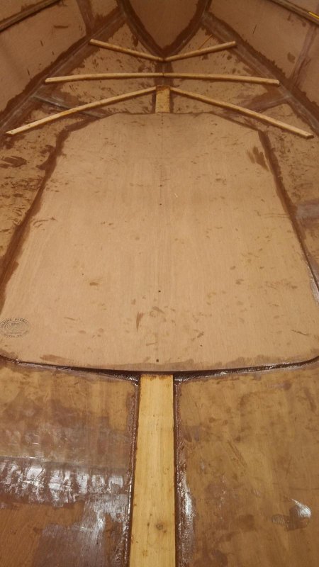

  1. Rolando, I think my doubler came out close to what the designer had in mind. Not perfect but close. See pics.
