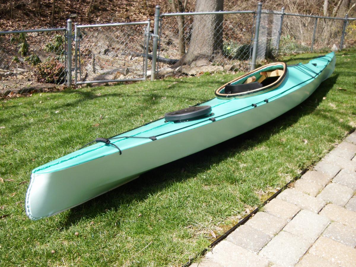

  1. Went for a paddle today. Surprising how easy she maneuvers with the long keel line and minimal rocker. Comfortable too.

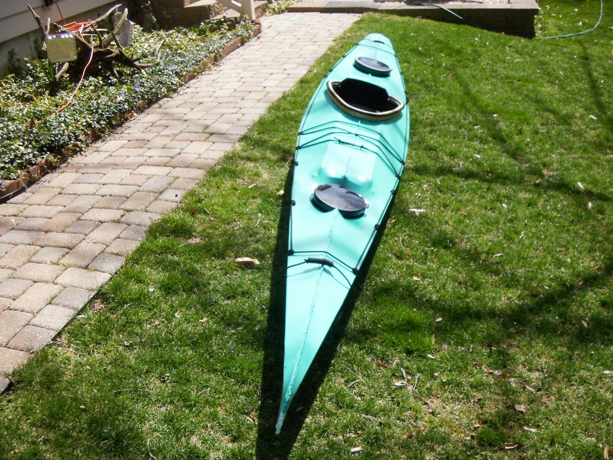

  3. OK, photo on grass. All that is left is the deck line behind the cockpit and 1 surprise that is in shipping. Test paddle coming up Sunday.

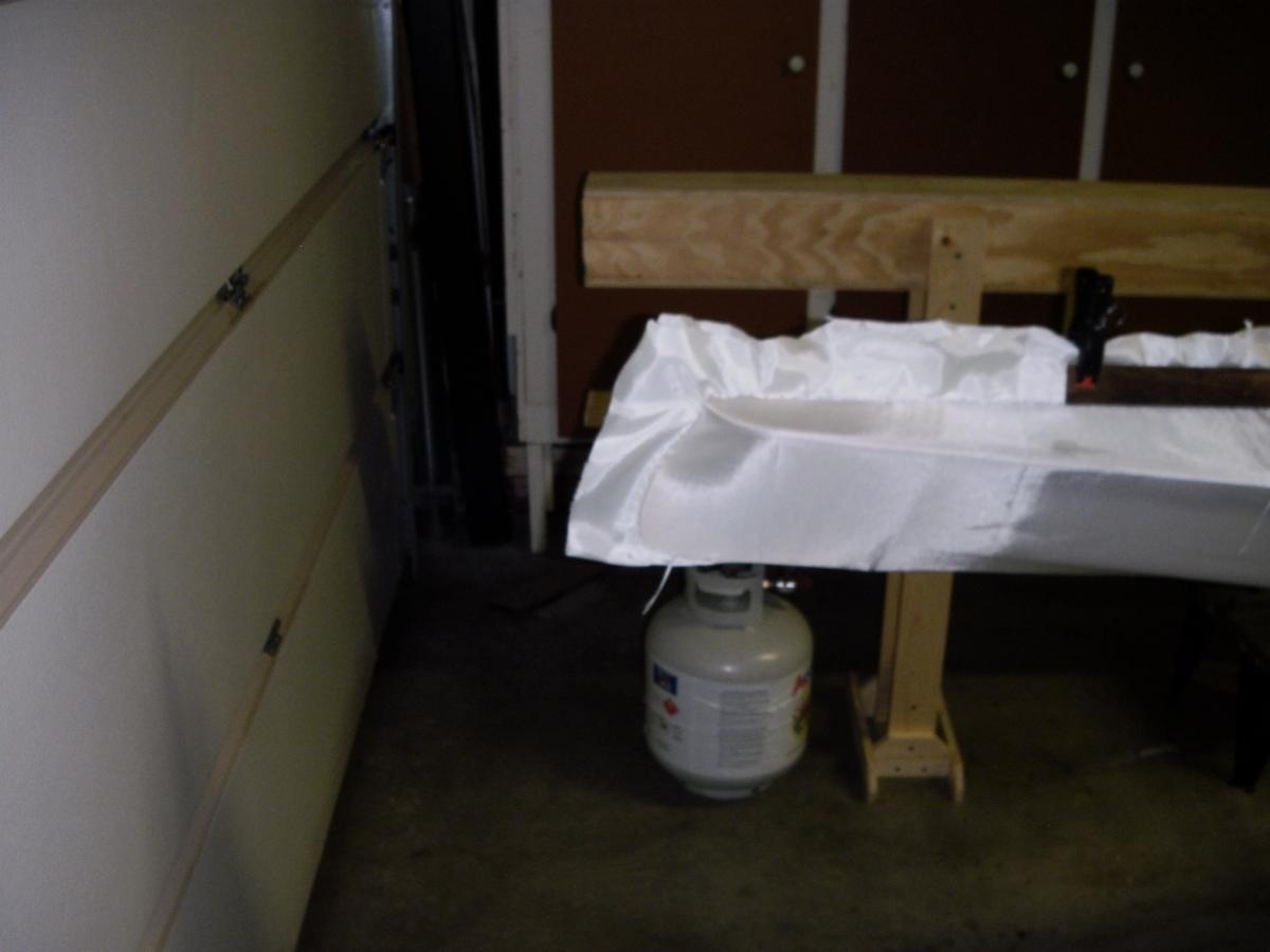

  7. WOW, I can finally upload some photos. The shrinking went very well. At first I wasn't sure but I just slowed down the iron and let it heat a little more. First time I have done this without wetting out the fabric before ironing. I will admit to a few holes in the stitching by being too aggressive with the thread. Will have a better feel next time. Have the Lexall on hand. Need it for the hatch rims anyway. Holes are melted for the deck rigging and hardware is on the workbench. Finally made a paint decision but you all just have to wait. Went ahead and installed the seat back. Did a variation on the book as I just wasn't content with screws. Found a type of T nut with out teeth and thru bolted. Used the caulk to seal up. My rope lip looks pretty good to me. Like the black so all deck lines will be black. It was easy to do and I decided not to attach the seat back to the rope like I had originally thought. Just a shot of the skin shrunk out.
