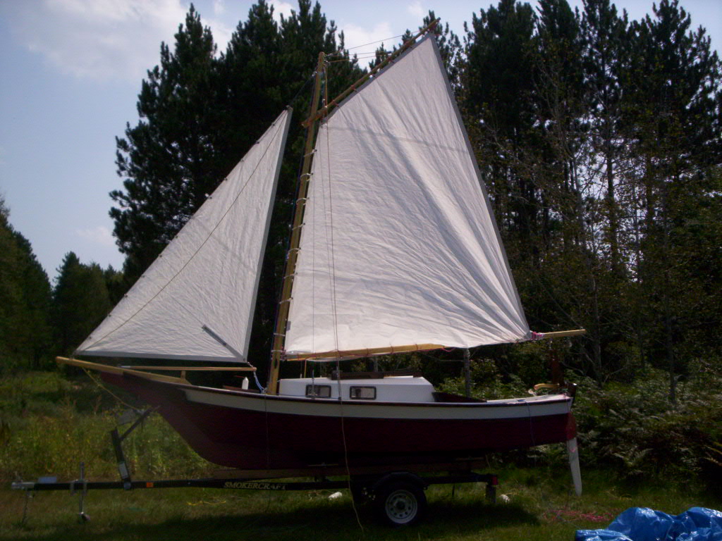

Here are 2 photos of my Weekender with the modified sails I made to increase the height of the boom. The luff is 106" and the foot is angled at 75degrees.
Thanks PAR, That is certainly encouraging. Do you think 106" at the luff and a 75 degree will do it? I also figure that an added benefit will be that the gaff will not bind on the shrouds with a height of only 106 going up the mast
I will not add a block. I want to keep my center of gravity low. However, I will make a new sail with 106" length at the luff and a 75 degree angle at the foot. I figure that the sail will raise the boom when hoisted. Of course I realize that I will have less total sail area then 120 sq. feet. but I want the boom higher and there is a lot of wind here anyway, enough that one would think of reefing every other day.
I've already had the boat out a dozen times. It sails well. The mastbox is right on at 93 degrees. It's just the boom height that I don't like. My question is, can I use the new sail I plan to make hold up the boom as in the picture. Thanks, See my detailed question above.

OK ! I see they did come out. Now for a question. One of the photos shows the sail as per the plans, however the boom is too low. I can't live with it that way. The next photo shows the temporary modification to the sail to get the boom to an acceptable height. now I don't want to fool around with the mast and the shrouds etc. So, I would rather modify a new sail along the lines of the photo. The dimensions will be: 106" for the luff going up the mast. The angle at the boom to the mast will be 75 degrees running along the foot of the sail for a total of 128" So in effect the sail is holding up the boom and I will have the clearance. The only measurement I'm not sure of is the leech but I guess that is just a question of connecting the line from the top of the gaff to the foot of the sail. Once again thank you all for all your help in this forum during the building process. The boat took me 500 hours and 4 months. A special thank you to Frank
