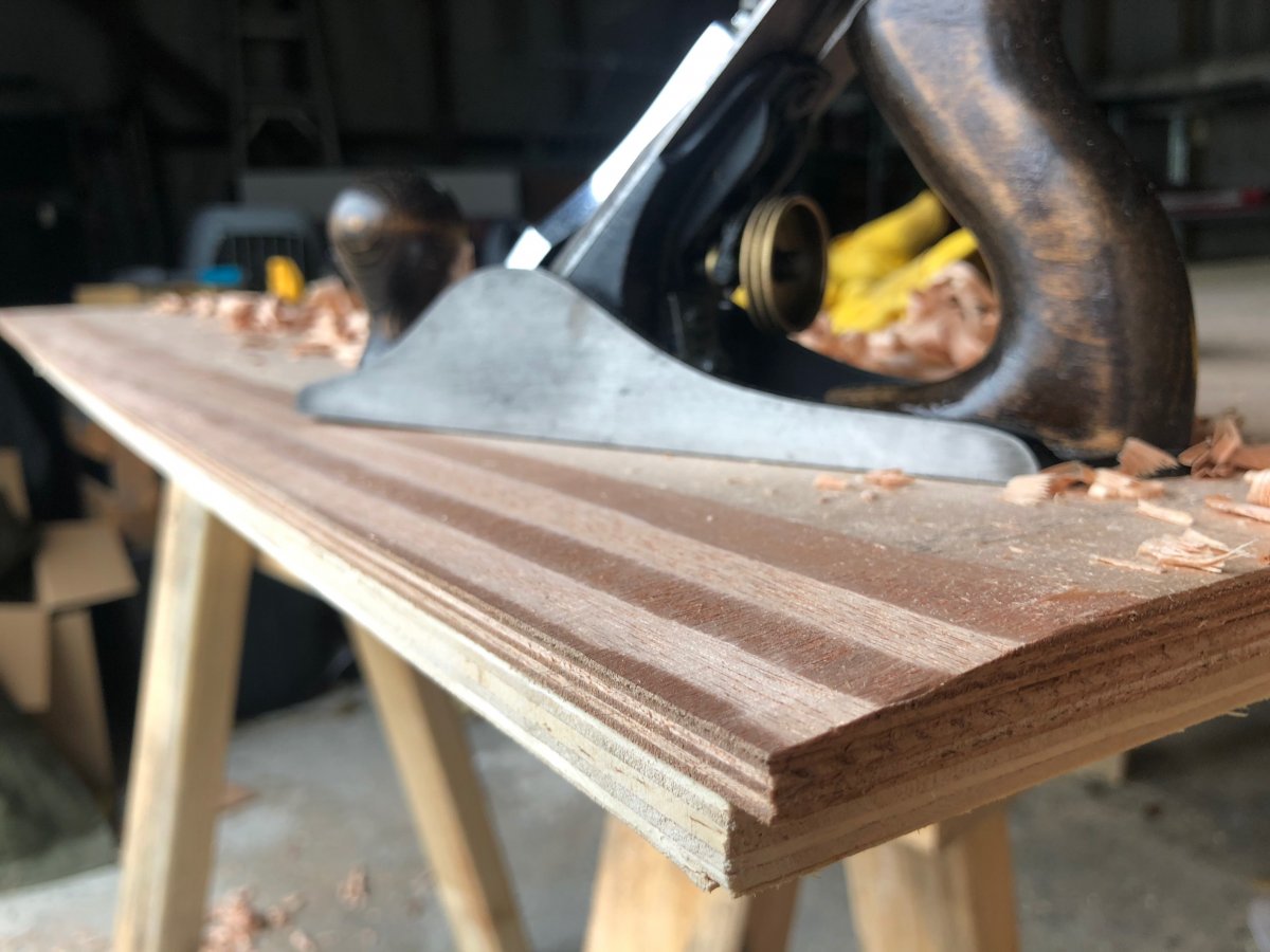

  3. Hello! I've been working on a Spindrift 11 for a year or so! It's going great, I'm about to glue the seats in. and I'm about to source the parts for the aluminium mast, and, after having a few suppliers look at me like I'm a little crazy, I'm beginning to wonder if I've understood the plans right. They call for 3 tubes: 6'L 2.5" D 0.065" Wall 6061-T6 tube 8'L 2.0" D 0.65" wall 6061-T6 tube 6'L 1.5" D 0.65" wall 6061-T6 tube The wall thickness tho seems wayyyyyyy too thick? that 2" tube would have an internal diameter of 0.7", which would mean the 1.5" tube couldn't fit inside it... unless I'm way off. I also don't understand why the bottom tube would be thinner than the top ones. Has anyone else solved this step? I'll attach some build photos as well, because I love seeing other people's builds
