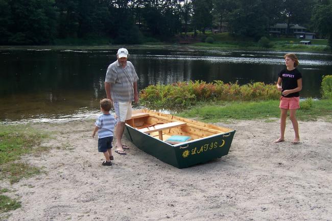

  2. Here It is out and about on first 3 hour cruise. Family enjoyed the homemade boat ride and decided Dad wasn't so crazy after all. The seams held tight there was plenty of freeboard and very stable. I was very pleased with the boats performance. maybe next A sailing dory?
  3. Success! It floats! Seams held perfect. My wife ,son,daughter and I took it for a shake down cruise today at the local pond. We call it Latis godess of water and beer. My three year old son loves it especially after watching and helping me build the boat. He didn't want to get out. I used an old 24lbs thrust trolling motor I repaired to power it which pushed it along nicely. Lots of free board and very stable. We can't wait to go fishing in it. There's nothing like building and using your own boat! I will definitely build another next year maybe a skiff or dory for the bay. I will send pics as soon as I size them for uploading to this site
