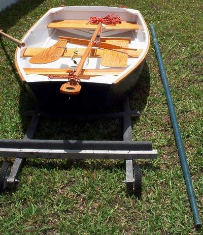

  12. Here is the picture of my setup. I think I need to make the dolly wider. John
  13. I don't have roof racks on my Honda. I built a little dolly that has carpet on it. I slide the dolly onto the roof of the car. The dolly just reaches the end of the boat sides so there is no room to attach the mast. Maybe I should redesign the dolly. Thanks, John Stevens
  14. The mast is around 14 feet. It's a cat rig with no stays. The sail is a sock type. I drive a Honda Accord with the boat on top of the car and I have been tying a line around the mirror and on hanging out the back door. I slide the mast through the lines and secure it with bungie. Is there a better way to attach it to the car? I'd really like to have it in two parts. I saw a guy with an aluminum mast that came apart and was wondering how to do it with the carbon fiber. John

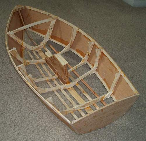

  16. PAR, Thanks for the detailed drawings. I understand your explanation but not how you came to it. I guess that's why you design boats and I just build and sail them. A few more questions for you: You said the Minuet was not a fast boat. Would a larger roach on the main make it any faster or just unstable? Is it the hull shape that slows it down? As you can tell I know little about design but really enjoy learning about what makes sailboats do what they do. Here's a shot of the model I'm building of the Minuet at 15 % the size of the original. TIA, John Stevens
