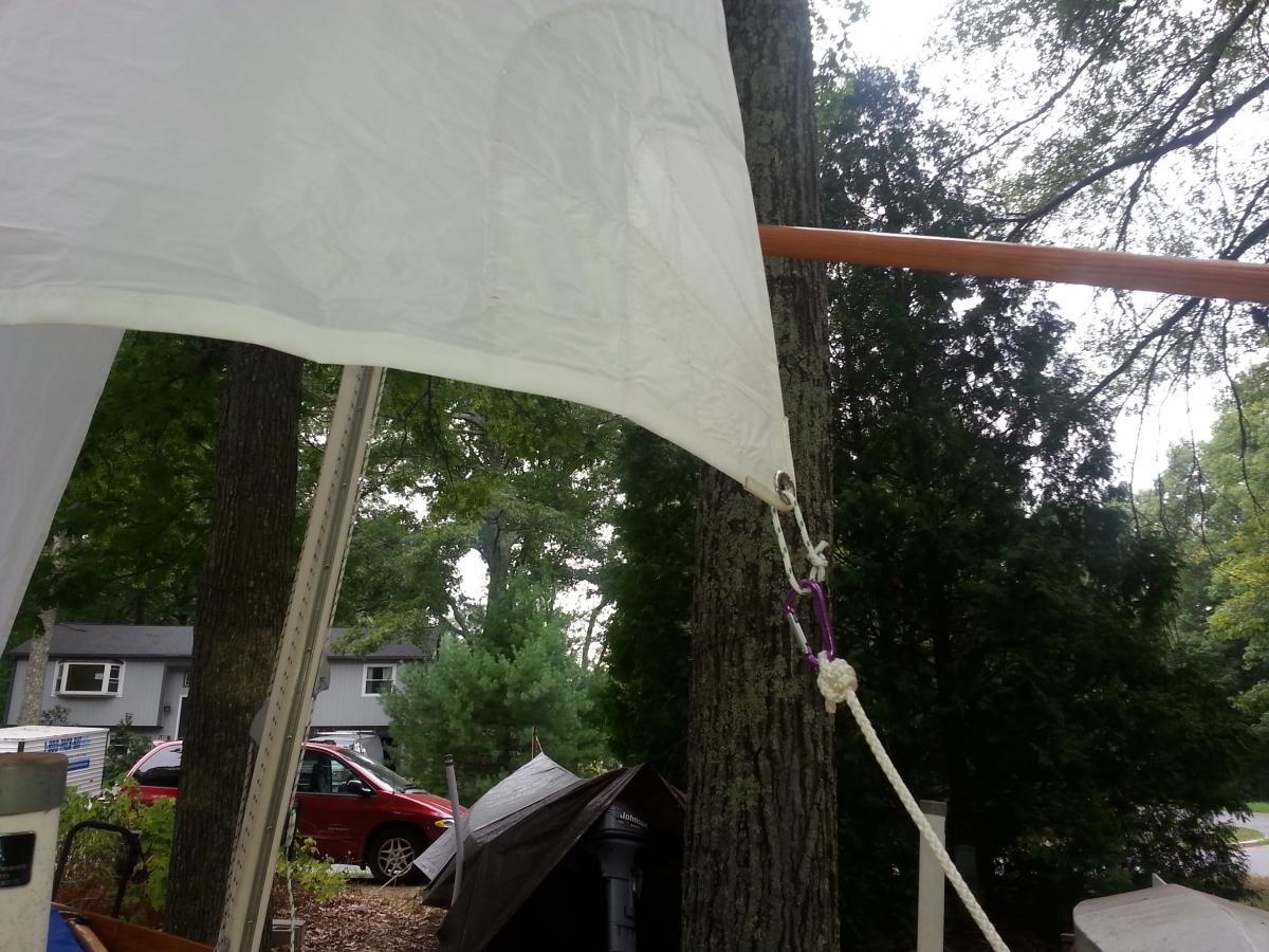

ecgossett Posted August 30, 2016 Report Share Posted August 30, 2016 After using my rowing pins as cleats, and holding the sheet for 5 hours (R2AK 2015) I swore I would find a better way. I had purchased a Racelite Block/Cleat combination http://www.duckworksbbs.com/hardware/blocks/d100/index.htm of which I could never find a good use.. Initially I used a softshackle, and attached the block to the loop on the mizzen downhaul hook. This worked great until I lost the softshackle. Now I use a Wal-mart 100lb rated aluminum carabiner, and it is faster and works better then I could have ever imagined. Derigging and rolling everything into my canvas grocery store bag I put the staysail in is a snap. For tacking I drop the sail, untie the sheet from sail, re-position around the mast, retie. Aft of main mast 1 foot, I have an eye hook on each side. With a quick release pin, it's easy to move the line back and forth. For re-hoisting, I have a figure eight in the halyard 12" above the sail head (thanks Graham for that advice). All I can say is that easily removable cleat system with a block is the best advice I can give. Quote Link to comment Share on other sites More sharing options...

Dnjost Posted August 31, 2016 Report Share Posted August 31, 2016 ]I think I have it. Thanks for the ideas. Tack is outboard where crew can get to it quickly. The sheet is attached to the clew with a lightweight aluminum caribiner clipped to a rope loop. This leads to a block on the mizzen then to a cleat on the mast. The halyard gets attached to some Holt jam cleats just above the stern locker. At some point, I will add the traveller Alan mentioned to assist with tacking. Quote Link to comment Share on other sites More sharing options...
