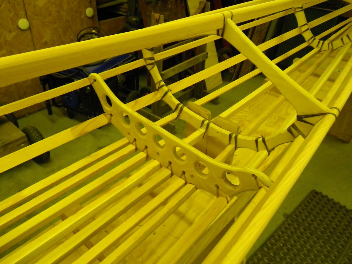

I sit differently in my kayaks.  Sitting frog leg style causes me numbness so I sit with my feet on a foot rest carved from closed cell foam.  My feet are close to parallel at at a 35 to 45 degree angle.  A Longshot is in progress and with my size 12's, I pretty sure I'll have enought room.  I added a frame to hold the foot rest.

I don't have large feet but always wear footwear which takes up more room. The wetsuit boots in the pic below are about 11 1/2 inches long. Tops of my feet are about 11 inches behind the frame indicated by the red arrow in the other photo and heels are about 14 inches behind that frame so my feet are angled forward.
As you can see the toes just touch the deck skin and heels are just resting on the bottom skin with no padding.
