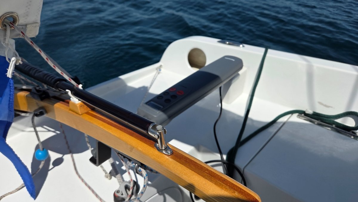

Like Bob Dylan in 65, Skeena has gone electric, at least most of the time.
How this happened. I put a 6HP motor on Skeena that had frward and reverse. Magical to have reverse. But the size and weight weren't great. So it was back to the Suzuki 3hp.
Then I got enticed by the Epropulsion Spirit 1.0
I started looking at revues (mostly very positive, a few not) and dreamed of a quiet electrical experience with reverse. As a 6 year owner of a Chevy Bolt, I'm a huge electric fan. Low (no) maintenace, whisper quiet, lots of torque, no gas vapors, full tank every morning, no more gas station junk food, etc.
So I bought one. Got it a few weeks ago. Sadly, unlike any other outboard I've ever seen, the tiller doesn't tip up and so it wouldn't fit in the space I'd created for my Suzuki. Grrhhh!
Who designed this thing? But I wasn't giving up. I bought an extension cable for the battery and a lid that replaces the battery.
I routed the extension into the Starboard aft compartment where the Battery now lives at it's front. This keeps the weight of the battery off the stern a bit. Used a SeaView Cable Gland. A really great product to keep the compartment water tight.
Here is the motor on Skeena. I do have to rotate the motor 90 degrees and before I tip up to accomidate the tiller handle (dumb).
While I don't have any video, I wil say that this expencsive toy is a joy. I backed into a slip in Burlington Vermont while I was talking on my cell phone. Incredible.
I do have range anxiety and less money. At 3.2 knots in calm seas it goes 8 hours. More to come.
