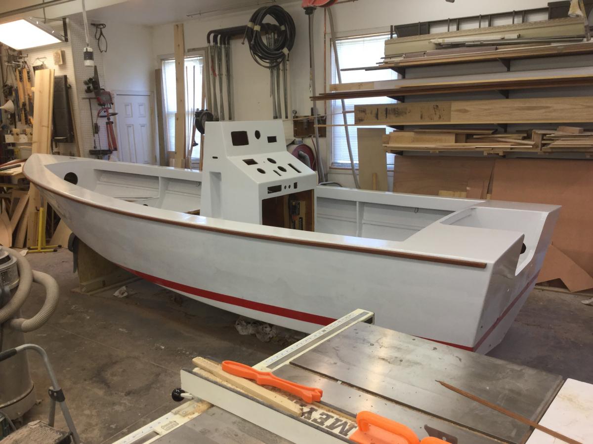

Latest update:
The console is completed and installed.  All the large-gauge wire has been run to the switch, main fuse and buss bars.  I went with 4 ga. since per my dealer's suggestion. I also ran the engine harness, and steering tubing through the chase.
I got the rub rails made and installed.  I originally planed and tried to use white oak but it was very hard to bend around the bow curve.  Mahogany is softer and seems to bend slightly better so that's what I used.  I'll install SS rub rail next winter... I want to go boating now!
I'll also make the doors for the console and aft lockers when it's cold out.  Since these areas will be closed, I'm not painting them.
I got the first coat of primer on all but the cockpit sole and swim platform.  I have one more piece to make and install before painting the sole - the seat support.
Here's a few pictures:

Very nice.  I like your foot space at the bottom of the console.  I noticed fishman also made a step at the bottom of his console.  Although different from yours, still a place for your feet.  I now wish I had done something similar.  Leaning post placement is critical for a comfortable fit.  Mine is just square at the bottom and although it works, its just not quite right while standing and leaning against the seat.
Your boat is going to be a nice rig.

Thanks Miyot.  I can't take credit for the toe kick,  I just built the boat from the kit that I bought from Graham.  I mostly stuck to the plan and when I modified something, I was very careful.  The fire extinguisher box was my idea and I think it was a good one.
