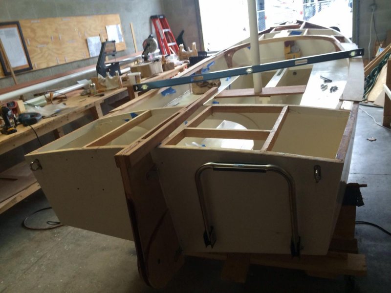

Needed to take a little break from Epoxy but back at it and making progress. Took her outside today to check on mast plumb and alignment . Main mast locked in but some flexibility on mizzen as mast tube not installed......looks fairly close and where they don't line up all fixable with aft mast tube installation.
No pictures but port fore deck installed, sprits done, rudder shaped and half glassed.
