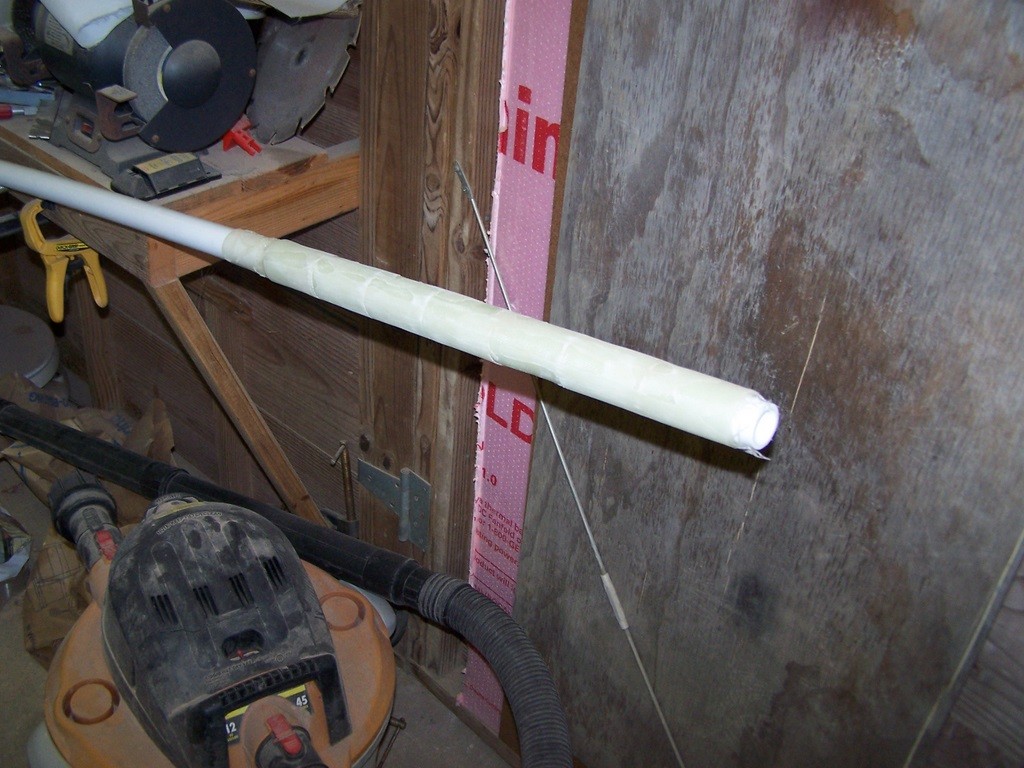

Thanks for the information. Between that and information received from Tom Schleiff, we have determined what we are going to do. I have started to build a fiberglass/epoxy pipe for the stern tube with fiberglass tape and epoxy using a piece of 1" pvc pipe for a mandrel and have built it up about 1/4" so far. I am shooting for a 3/8" wall thickness with an inside diameter of 1-3/8" to fit a cutless bearing. The outer diameter will be set up to fit a Lasdrop Dry-Seal shaft seal. The shaft diameter will be 1".  8)

Mike,
You ain't gonna belive this, but the tube I made yesterday looks really good and has sufficient wall thickness for clamps. I'll have a picture of it after we work tomorrow.

Here are pics of the stern tube on the mandrel and after I took it off.
Really looks pretty good.
Will have to put aside for a while and let it cure while we glass the hull.

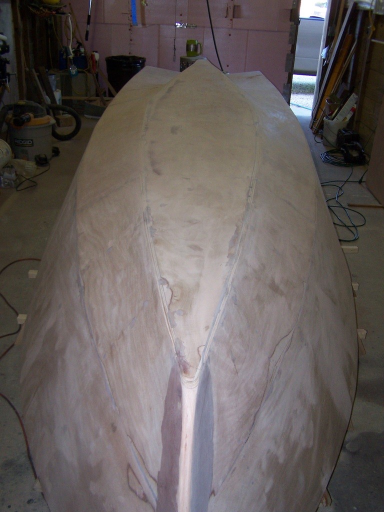

Haven't had much to report on for the past week or two because we were slowed down due to the rather cool weather here in Alabama. The temps moderated this last week and we were able to get the port half of the hull glassed with 6oz cloth & epoxy.
Yesterday, we applied the 14 oz biaxial cloth on the keel and out to the chine. That soaked up lots of epoxy, but it looks pretty good today, after we took the "leveling cloth" off.
Now we are at the point where we are going to sand to get ready for paint. We have a long board, but that appears to be a lot of work. We are looking into an air-powered long board to help us with all of the hand work. Sanding is not my favorite thing, but it will help us get a more acceptable finish.  :grin:
Here are some shots of the boat as she sits now.
Steve
Share this post
Link to post
Share on other sites
6 oz over the whole hull with the keel area overlapped and then the bias ply on top of the 6 oz. That should give us sufficient keel protection for beaching the boat.
The name of the "leveling cloth" stuff is "Peel-Ply." It is a polyester cloth that is applied and smoothed out after you soak out the fiberglass cloth. After the epoxy cures, you simply peel the "Peel-Ply" off the cured epoxy and it leaves a smooth surface with a VERY fine weave pattern. Finishing the surface left by the "Peel-Ply" is much simpler than the surface left by not using the material. We love it!  :grin: :grin:

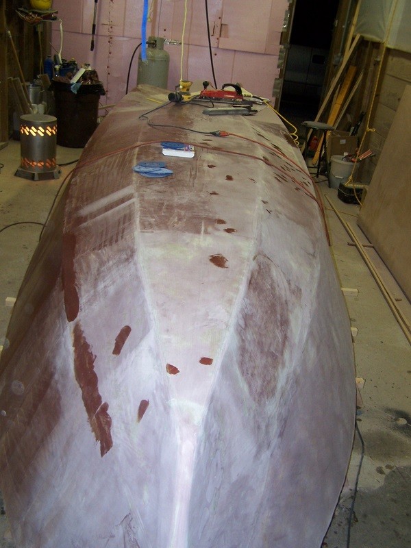

Hello All,
I see from other threads that everyone is feeling the effects of the cold weather and precipitation this winter. It's been quite cold here in Alabama, too. The weather people are calling for high 20's to low 30's for tonight and tomorrow night, then more rain. After that we do it all over again.
I finally got out to work on the boat this week. We are working on the final sanding before primer and we have the starboard side sanded back to midships from the bow. We're getting there, but it is slow.

Ken,
What you see there is a air powered long board, a hand long board and a random orbital. I rarely use the random orbital, and I use the two long boards almost exclusively.
I found a few new muscles using the hand long board! :shock:
