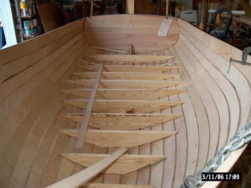

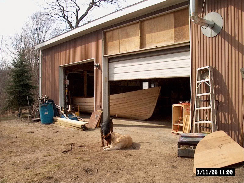

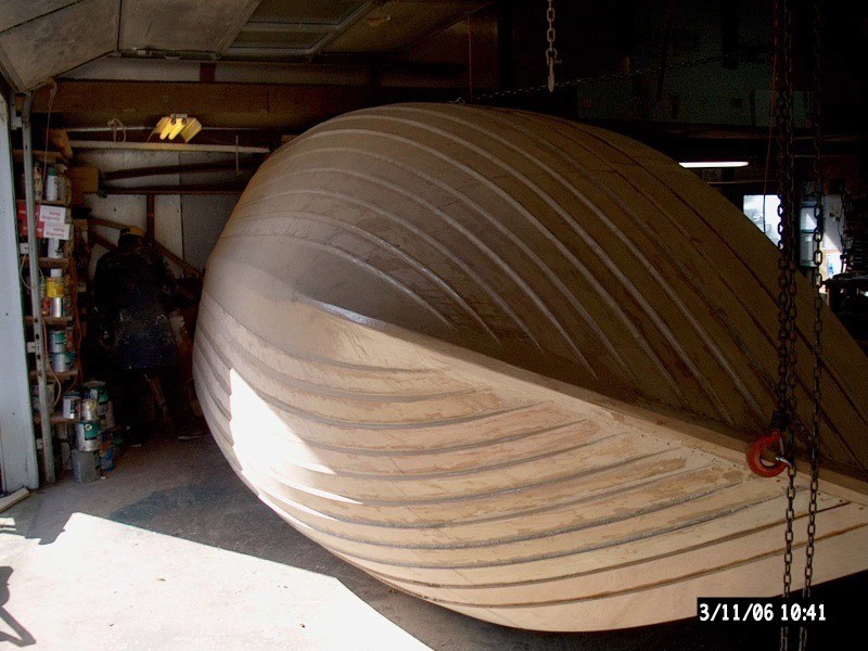

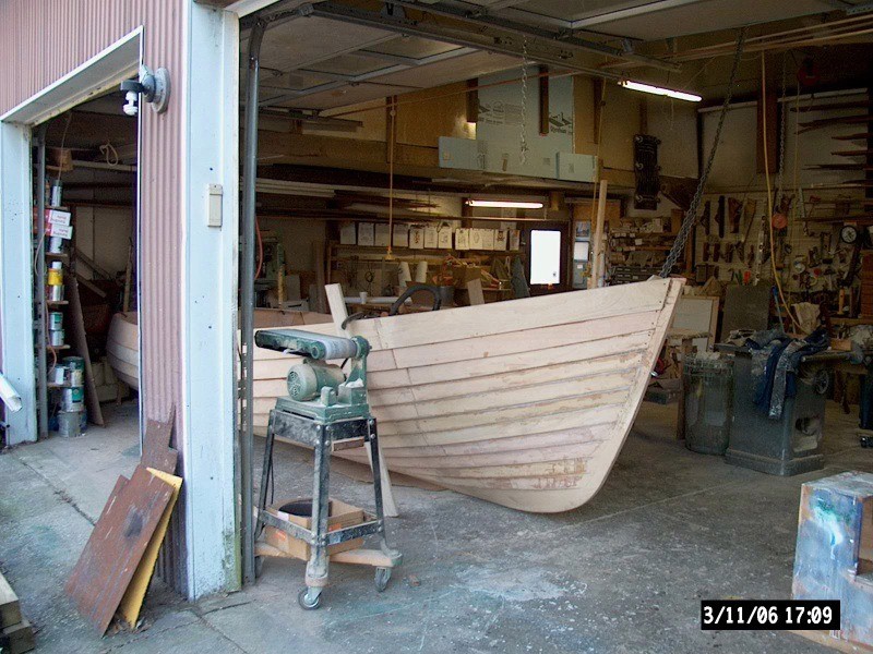

Greg Luckett Posted March 12, 2006 Author Report Share Posted March 12, 2006 Week ending Saturday, 3/11/06. The shear plank was installed Friday. We hooked up the boat to hoists, removed the molds, rolled her over, and began making additinal floor timbers as well as working on the shear and getting it ready for the rub rails. Quote Link to comment Share on other sites More sharing options...

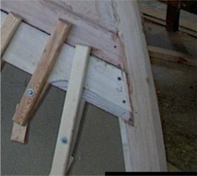

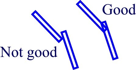

Greg Luckett Posted March 14, 2006 Author Report Share Posted March 14, 2006 GregNice boat! I take it an outboard? Excuse my ignorance' date=' BUT is what you're calling the "gains" the (scarf joint ?) between the lapstrakes at the bow and transom? Nice detail! I always thought the plank thickness was planed down to get the curve fair. :oops: Updated detail for plywood?[/quote'] The gains are to reduce how much the ends of the planks sit on top of each other which makes them blend together without sticking up. This is at the stem and the transom. The entire length of the plank is beveled to allow the next plank to sit flat against it without making large gaps. I hope this explanation makes some sense. I have attached a crude sketch. Until I get my scanner hooked up again this will have to do. Yes, it will have a 50 HP 4 stroke outboard. I am not sure what you are asking about the plywood detail. Notice how the planks are the same widths, all 12 of them, except the sheer plank, which will have a 2 inch rub rail, and then it will look the same width too. Also notice how the planks align and are the same widths at the stem. This is a neat trick. I have started looking at other lapstrake boats but seldom see this......so far anyway. Quote Link to comment Share on other sites More sharing options...
Phil Posted March 14, 2006 Report Share Posted March 14, 2006 I was confused by the photos showing only 1-2 ft. of gain at each end. So the gain or "bevel" goes the entire length of the strake? Makes for truer glueing surface as well. Quote Link to comment Share on other sites More sharing options...
Greg Luckett Posted March 14, 2006 Author Report Share Posted March 14, 2006 Phil, In some instances the gains blend in with the bevels but they are normally cut in at different angles. A gain is a tapered paper thin champher which changes to a bevel, then tapers out to nothing, and is only at the plank ends. This is hard for me to describe, but later I have been promised diagrams from our student recording everything. Don't let me forget to come back to this with the pics later, please Quote Link to comment Share on other sites More sharing options...

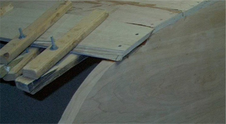

Greg Luckett Posted March 14, 2006 Author Report Share Posted March 14, 2006 Try these pics....maybe they have enough detail? Quote Link to comment Share on other sites More sharing options...
Phil Posted March 15, 2006 Report Share Posted March 15, 2006 Got yea! I see the transition between the bevel and the gain now. The gain allows the strake to flush-out to the stem or the transom. Is this a Bolger detail or traditional? I always thought they planed the thickness of the strakes. See WB # 189 page 19 " The Landing School" Is this what you gain from a "gain"? The detail your using allows for the full thickness of material, yet it's flush 8) Quote Link to comment Share on other sites More sharing options...
Greg Luckett Posted March 15, 2006 Author Report Share Posted March 15, 2006 Phil, yes I think you have it now. Look back at the picture I posted with the boat sitting on its port side. You can see the same effect. Quote Link to comment Share on other sites More sharing options...

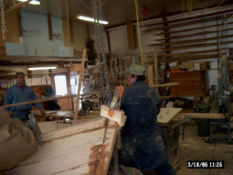

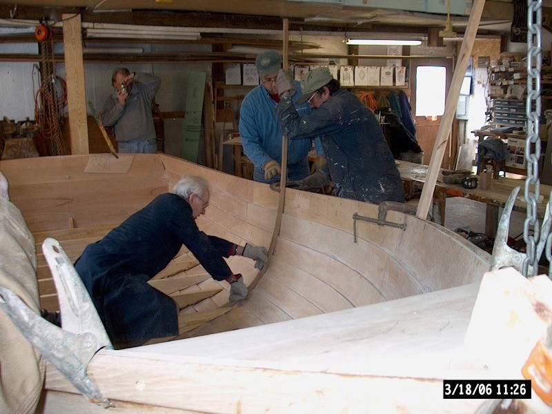

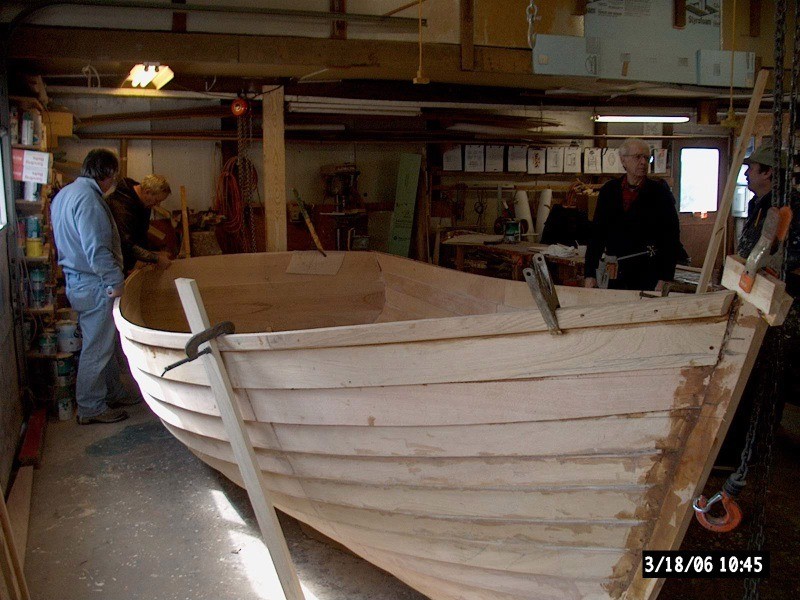

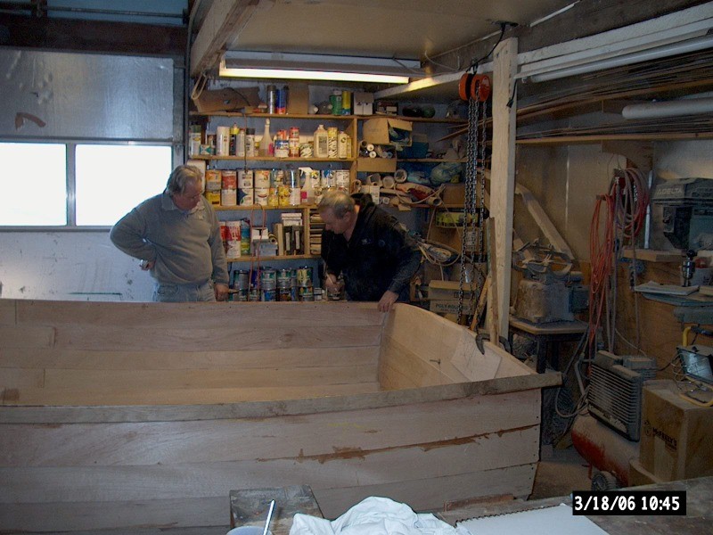

Greg Luckett Posted March 18, 2006 Author Report Share Posted March 18, 2006 Class #10, at least the first half. I had to leave early to attend a banquet with my wife. The white oak rub rail has been added and the interior seams sanded since last weekend. This morning we finished adding more floor timbers (made from Yellow Pine I think), then fabricated the breast hook and the quarter knees (made from Cherry), and then steamed and attached the port side ribs (made from Sassafras). Yep, we steamed ribs. . The class has also been extended to the end of April, but at no additional tuition costs.....quite a good deal . Quote Link to comment Share on other sites More sharing options...
