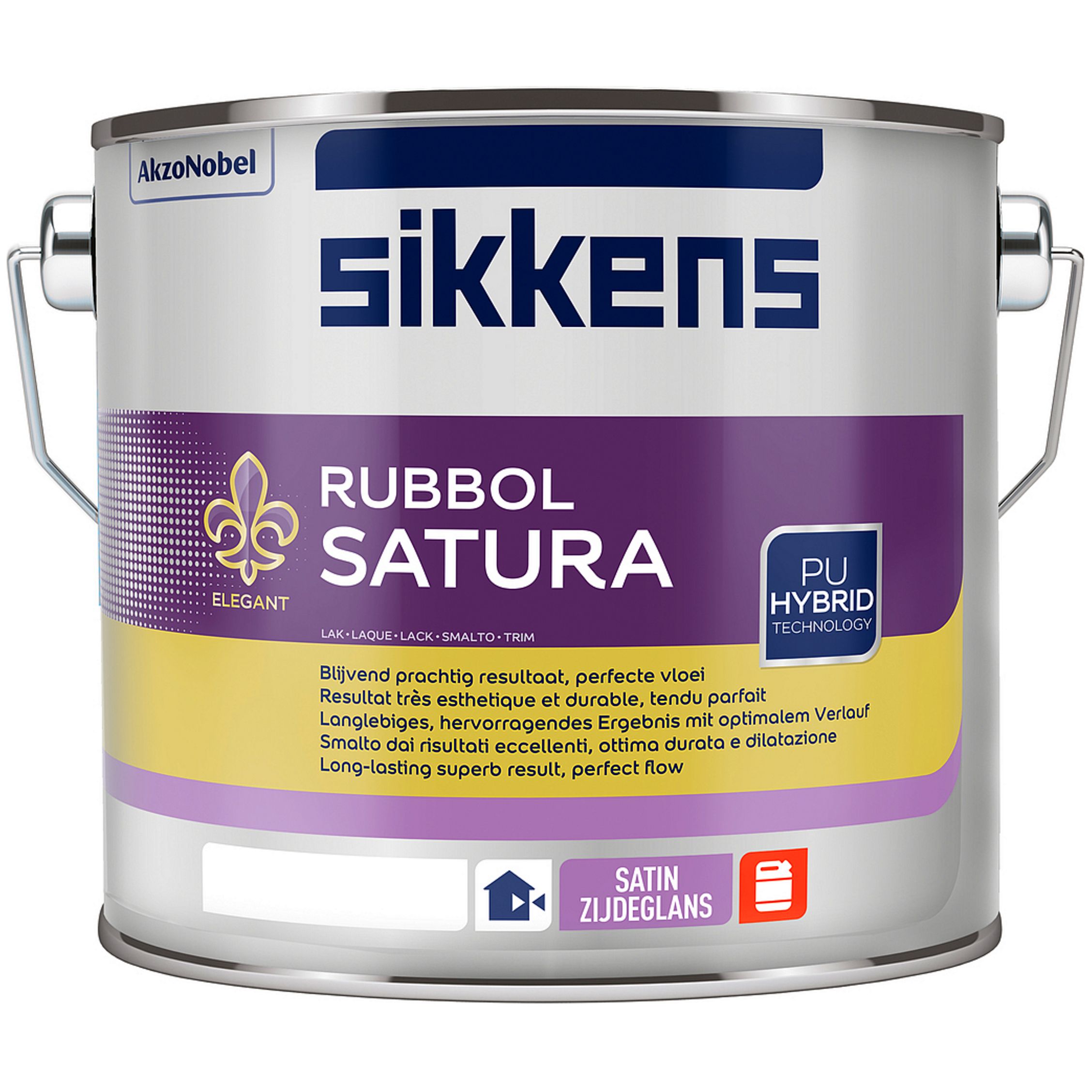

Paint:
I have bought this one:
Sikkens Rubbol Satura from farbekönig.de
https://www.xn--farbenknig-kcb.de/media/image/65/d5/08/SI0030.jpg
This was recommended to me by a boat builder in a facebook group, how has used it on his skin on frame kayak. He also mentioned that using transparent paint does not protect the fabric from UV light as good as coloured paint, and therefore might need a reskinning earlier.
I estimated the area of the curlew by modeling it as a cylinder:
A=0.3m*pi*4.5m=4.2m2
Using the calculator on the website I will need a bit more than one liter. Since there are only 0.5l, 1l, and 2.5l sizes available, I decided to buy 0.5l white as a first layer, and then 1l with the color of my choice. RAL color palette is avaible, from which I choose "RAL 1016 Schwefelgelb" (engl. sulfur yellow) with the reasoning that I would like to be seen even in bad weather conditions.
78,98€ incl shipping
Another, probably even more durable option would be a 2 component polyurethan. Here is a discussion about it in German, with some people recommending Coelan. However it seemed quite expensive, and since all this boat project is already complicated enough for me, I thought learning how to use a 2 component paint on a rather large surface was another rather large task.
Corey's Goop is also mentioned in this discussions.
A third option, at least for nylon, is epoxy resin coating. Capefalconkayaks is using that method. An attentive reader has pointed out to me, that capefalconkayaks actually uses a 2 component polyurethan coating.
I tested the white color on a small leftover piece. I realized when using more than 10% thinner, it soaks so much into the fabric that the inside is getting ugly white stains, therefore I will stay with 10%. I also realized that if the "backside" is painted, none of the soaking appears. Therefore this must be the coated side. I have skinned my boat the smooth (coated) side of the fabric on the inside, but in hindsight it might be better to have that side on the outside as it is smoother already.
I have not painted my boat yet, as I am waiting until the garage is warm enough. I will update when it is done.
Some more discussion on Skin Paint.
If you want two colors and wonder which combination will look nice, this color wheel might help.

Painting the Skin:
I used 0.5l of white paint(because white is cheaper than the custom mixed color) that I thinned with 10% of paint thinner for the first two layers of color.
Then I put two more unthinned layers of yellow color on the boat, which used the whole 1l of paint.
It is fine now, but it could have used another layer of paint. Next time I would buy 1l white and 1l of my color choice for a better paintjob.
