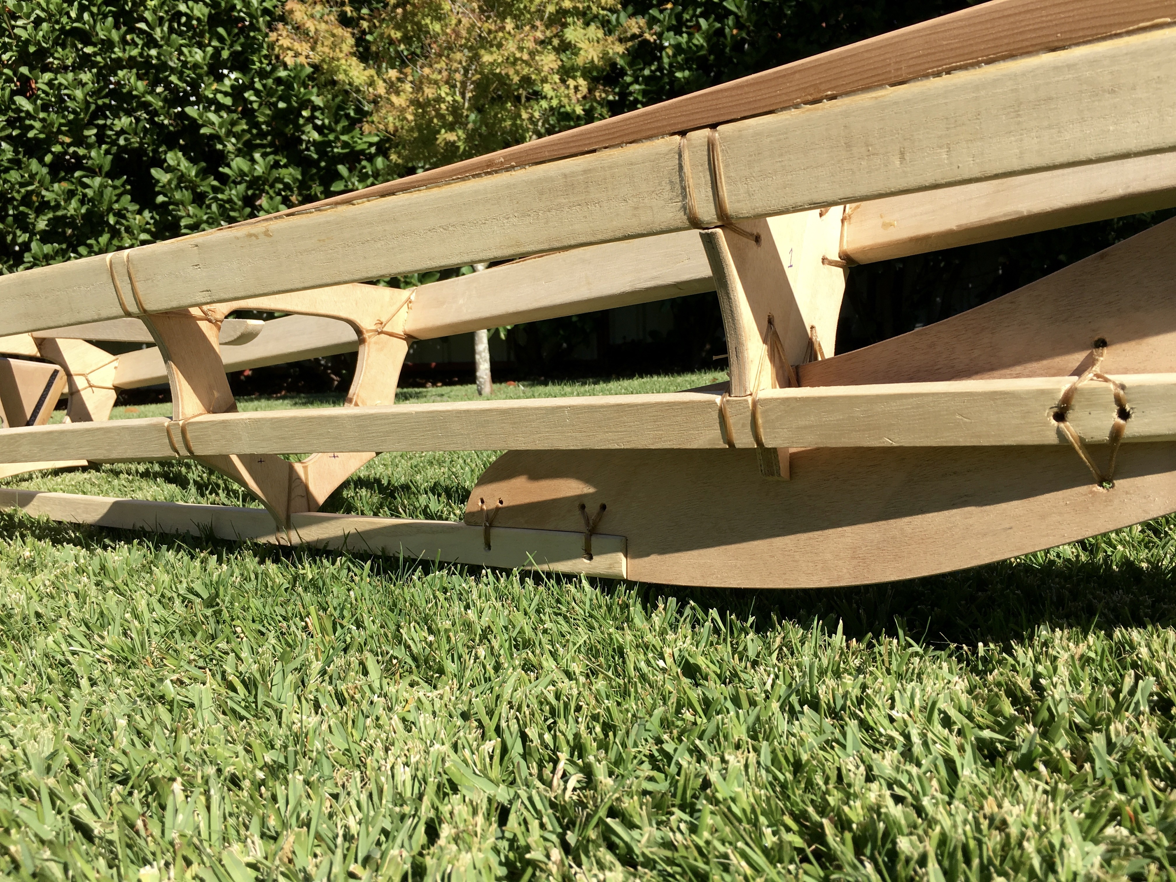

Hi Teasea, I used Paulownia and can't speak highly enough about it. Plantation timber grown in central and north NSW, Australia and Asia, its a delight to work with hand tools similar to Western Red Cedar and has comparable strength and marginally lighter in weight.  Also glues well.   The photo shows the colour difference between the ply stem, keel, chine, stem,gunwhale and WRC sheer riser.  Search   paulowniatimber.com.au   and you can order sizes to you needs DAR and they will pack and ship. I don't know if they ship to USA but an email will inform our American friends,  they were pleasant to deal with and small orders not a problem and cost effective as the timber could be used as delivered.

Hi All
Another new member here. This is a very interesting and timely discussion for me. Having “discovered” kayaking  April last year, I was intrigued with the idea of building one and completed a SOF during a course in July by way of introduction. I am now starting my first solo build and have ordered a set of Ravenswood plans from Jeff. I am also considering Paulownia as a replacement for WRC.
I am a complete beginner and at the moment I am simply trying to absorb as much information as I can. Apologies in advance for any dumb questions as they occur.
Labrat, I know you said you like the Paulownia. Can I ask how your Curlew has held up over the last 4 years. Much use?
In the photo from Trakka, the lashing seems to be cutting into the Paulownia quite deeply. Is this a potential issue?

Thanks for the replies folks.
Trakka - I can see now what you mean regards making grooves for the lashing. And Labrat, thank you for the interior pics. Helps a lot.
Looks like either WRC or Paulownia are eminently suitable so I'll probably end up going with whichever I can get in best quality (long, straight grained, clear, etc) at a reasonable price.
