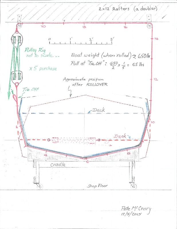

Jay showed me photos of the rig he used to "roll" his "Southern Express." Attached is my sketch of his approach. Jay's shop ceiling was quite high and he used some scaffolding to support the overhead spreader -- whereas my shop has exposed rafters 8' above the floor. The lifting loop needs to be adjustable so that the boat may be lifted off her cradle and (when rolled) down onto saw horses or other supports. Jay had a "come along" for that purpose. At our local True Value hardware store I found that the pulley tackle of a "Deer Lift" would do the job -- and at a cost of only $20 (for the entire package).
The Deer Lift is rated at 440 lbs. The Cs20.3 specs show her bare hull weight as 650 lbs. The tension on the loop will be just half, or 325 lbs -- well under the lift's limit. With a x5 purchase, the manual pull will only be about 65 lbs -- which I think I can handle. Jay found the boat's CG to be just aft of the cabin bulkhead.

I've repeatedly found most spend a lot of head scratching and worry over something that takes 15 minutes and goes off without a hitch. Of the folks here that have rolled their boats over, how many found it more difficult than they worried it might be?
My point is there's a lot of different ways to do it and most work without damage or control (the big issue). Think it out, look at other setups, YouTube videos, etc. and I'll bet you a beer it goes off without much trouble. The only ones I've seen go bad where rushed or otherwise compromised somehow.
I find it's better to hoist from one side, get the boat to the balance point, then reset to lower it down into the new position. This lets you scoot the boat over, if you don't have much room and take a break to remove the building jig and setup the cradle or trailer.
Lastly, Don't trust simple tackle. Put an extra fall or two in it, so you can overcome friction, twisted lines, etc. and insure you have a way of tieing it off in mid roll, just in case you have to rethink about something.

I just realized that the sketch of the rollover rig fails to account for the fact that the sheerstrakes will have already been installed. AND;
Just as I'm doing this I received an excellent suggestion from Alan: he emailed ... "I have had good success rolling over my core sound 17 by first hoisting the front half up to an anchor point by its bow eye. Then I just manhandled the back end. In your case, you could do the same and then use the tackle for the stern. The bow eye is plenty strong for this purpose ... It has the advantage of only having a single tackle strap setup to manage and the bow can be raised and lowered easily as needed."
I would note that it also has greater stability, reduced loads, and (perhaps) could be done singlehandedly. Alan's email reminded me that I used that approach to roll the Penobscot 14 that I built in 2003. That boat weighed only about 200 lbs but was in a shop not wide enough for a roll on the floor.
Later, I'll submit another sketch showing a "bow eye & stern loop" rollover setup.

I Pete, my rollover structure is very similar to yours, but I have a snatch block in the horizontal run, (along side the horizontal spreader) and the lift is applied there.  With the lift device as your sketch shows the boat will have to slide in the straps.  I thought it would be better if the straps "rolled" with the boat, with no relative motion between the boat and strap.

If anyone is considering a suspended loop like Pete was considering, note that the tackle won't go through the pulleys at the top.  And I didn't like blocks laying on the hull which they will do when rolling the other direction.  Also the top blocks don't have to line up vertically with the gunwales.   The "vertical" parts of the loop won't be vertical during the whole rotation anyway.  Finally, don't underestimate the load on the top blocks.  It's roughly 50-60% greater than the vertical load on the loop rope due to the tension on the rope between the two top blocks in combination with the tension in the "vertical" part of the loop.
I used two loops with a single piece of rope on each end of the boat: Go around the boat to one of the blocks,  go around the boat a second time and go to the second block.  Hope that makes sense.  This reduced the load on the rope, the blocks and the tackle.  I also used climbing prussiks to hold the rope after I tensioned with a three-part tackle.  (I have a CS17.3)  A prussik knot works almost as well and doesn't have to be padded when it contacts the boat.
All that said, Alan's bow eye method sounds great.  It's close to the longitudinal center of gravity so the boat shouldn't flop badly during the rotation.  And one person can probably handle the weight in most cases.  Just be sure you get a good grip on the hull close to the transom.  Rubber-coated gloves?

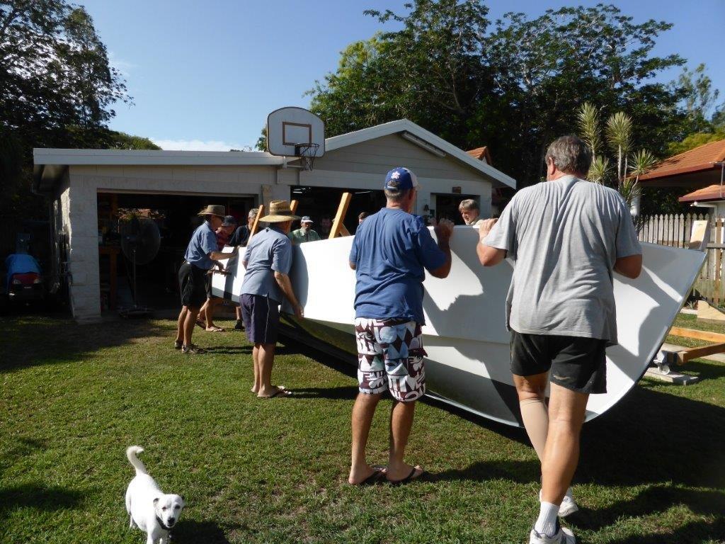

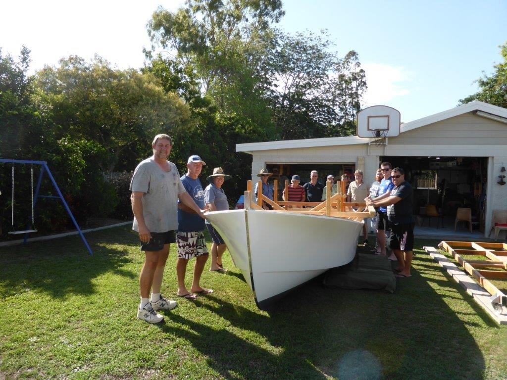

G-Day men,

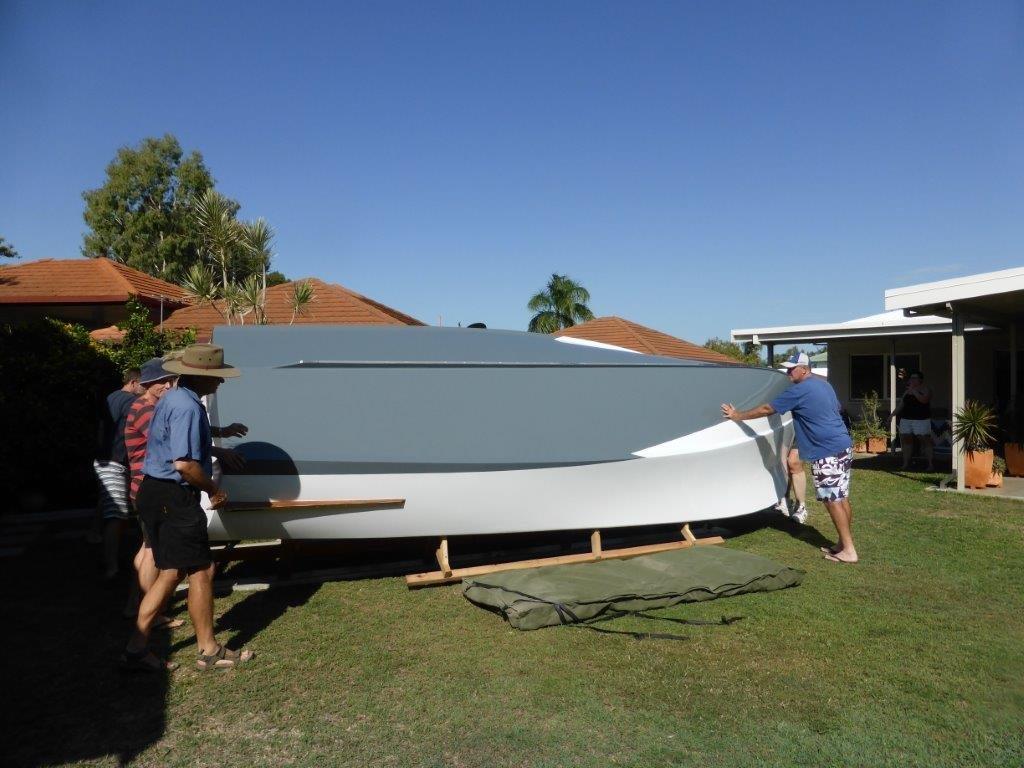

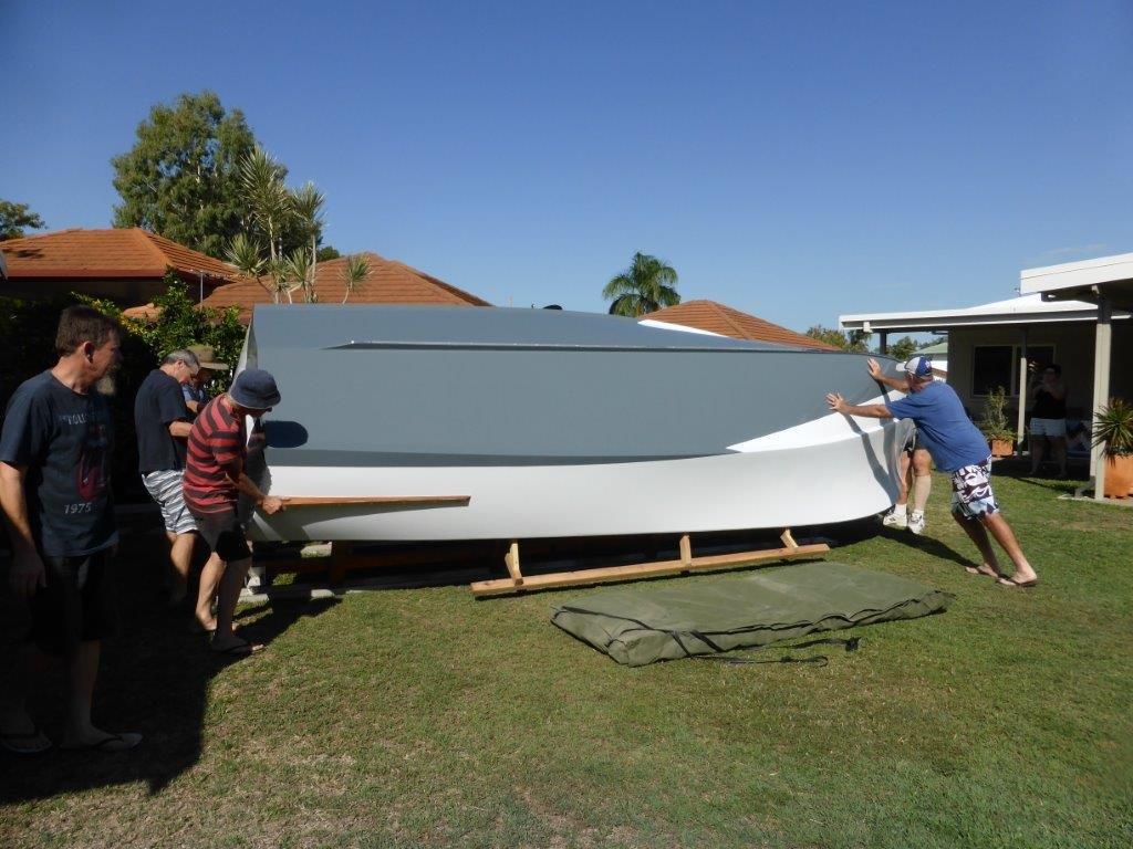

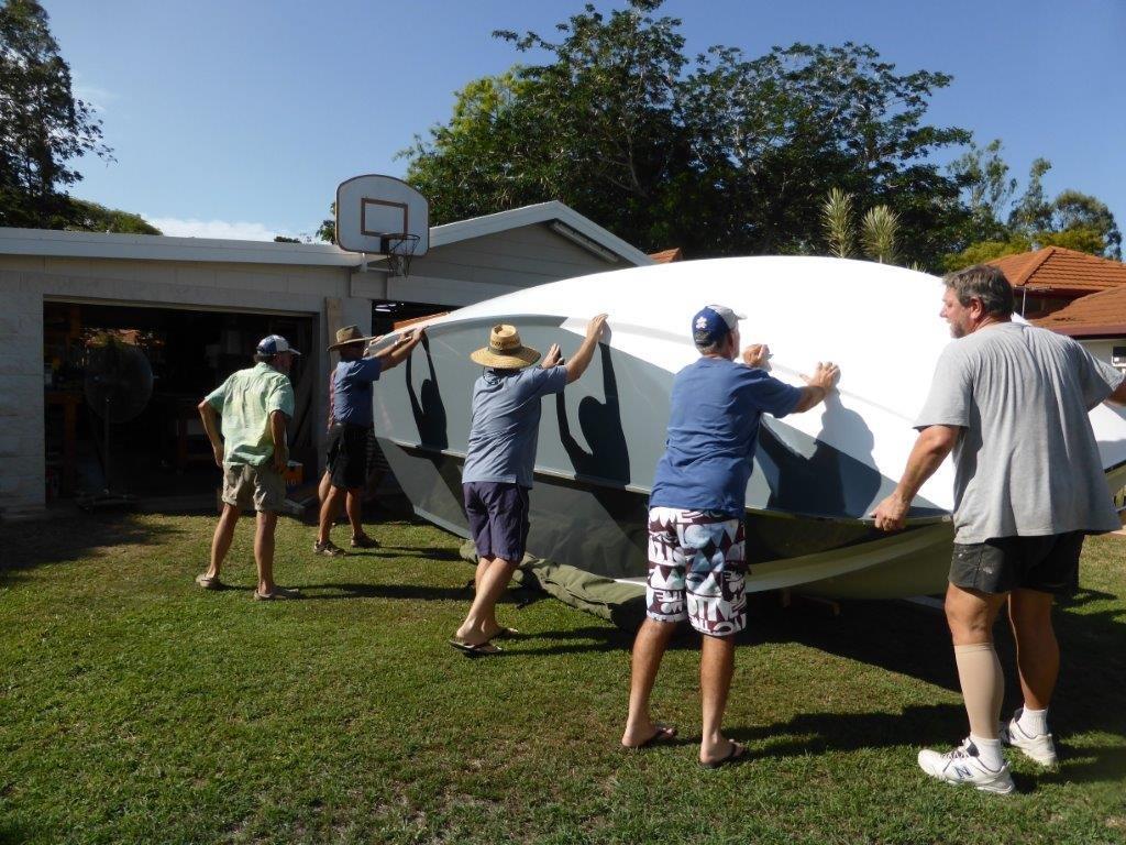

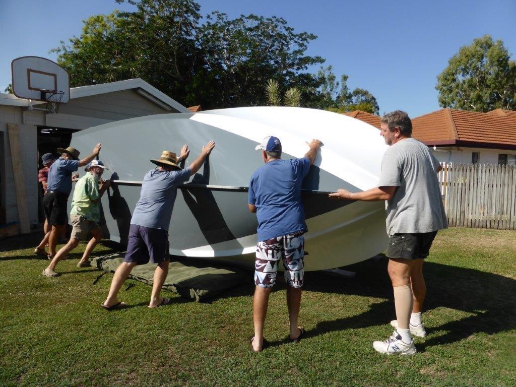

I thought I would put my 2 cents in re the turnover thing...I am building an OB-20 and found the easiest way to turn her over was with a few mates and a cantilever style frame that levers off the legs of the strong back. It was the easiest way I could figure out how to do it. After we unscrewed the legs from the SB, the whole thing stood up by itself, then with a gentle shove we pushed her over onto the frame (outrigger), up vertically and over onto my swag which was under the chine...........easy! Then we picked her up and put her onto pre cut supports that sat on the SB framework. the whole thing took 1/2 hour at the most and most of that time was taken up with who's shout it was going to be after the event. Honestly, it went without a hitch.

Pete-- I don't see how you're going to get that block and tackle to pass through the rafter pulley, once you've got it lifted off the cradle.  I'm talking about the loop drawn in red.  For me, the hardest part is getting the boat up to the vertical balance point.  The second part, setting her down from this point, is the easy part.  If I were doing this, I'd take the strap extending from the block and tackle, go under the hull, and connect it to the far gunwale.  This would take care of the difficult lift.  The rest I would leave up to friends, recruited with pizza & beer, of course.
