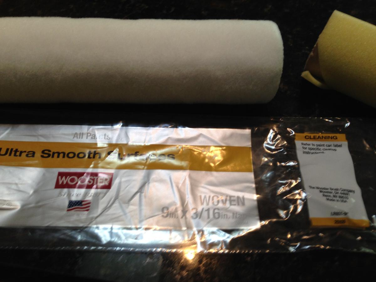

Don Silsbe Posted September 30, 2015 Author Report Share Posted September 30, 2015 I'm going into the Big City tonight. I'm gonna pick up a bag of those velour rollers, and let 'er roll. (I live in the boondocks, and need to coordinate my shopping with other trips to town.) I tried the foam rollers that Alan recommended, but they kept coming unglued from the cardboard sleeve on the end that hit the bandsaw. Hmm... Anyway, I'll try all three. Quote Link to comment Share on other sites More sharing options...

Don Silsbe Posted September 30, 2015 Author Report Share Posted September 30, 2015 OK! I'll add them to my inventory, photo below. Tonight I'll also turn in my new spray gun for a polisher. Sounds like the safe way to proceed. Right? Quote Link to comment Share on other sites More sharing options...
Don Silsbe Posted September 30, 2015 Author Report Share Posted September 30, 2015 OK! I'll add them to my inventory, as shown in photo. (Note foam roller defect.) Tonight I'll also turn in my new spray gun for a polisher. Sounds like the safe way to proceed. Right? Quote Link to comment Share on other sites More sharing options...
