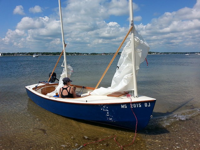

Ed.  I used mahogany for mine and attached with stainless screws, and set them in polysulfide sealant (mahogany colored).  While I promised myself that I would fill all the screw holes with bungs, I was too anxious to get out on the water while our short summer lasted.  I think they look good as is and function well when rubbing up against a dock.  No visible damage so far (only 5 sails so far).
I did not need to steam the mahogany as it took the bend forward just fine.  I put a radius on the deck and placed them just below the radius.  Best function of them seems to be "Oh Jesus" handles for when the boat gets caught in a puff with the skipper responding a little slow!  post-2815-0-15197900-1440418181_thumb.jpg
Good luck.
David
