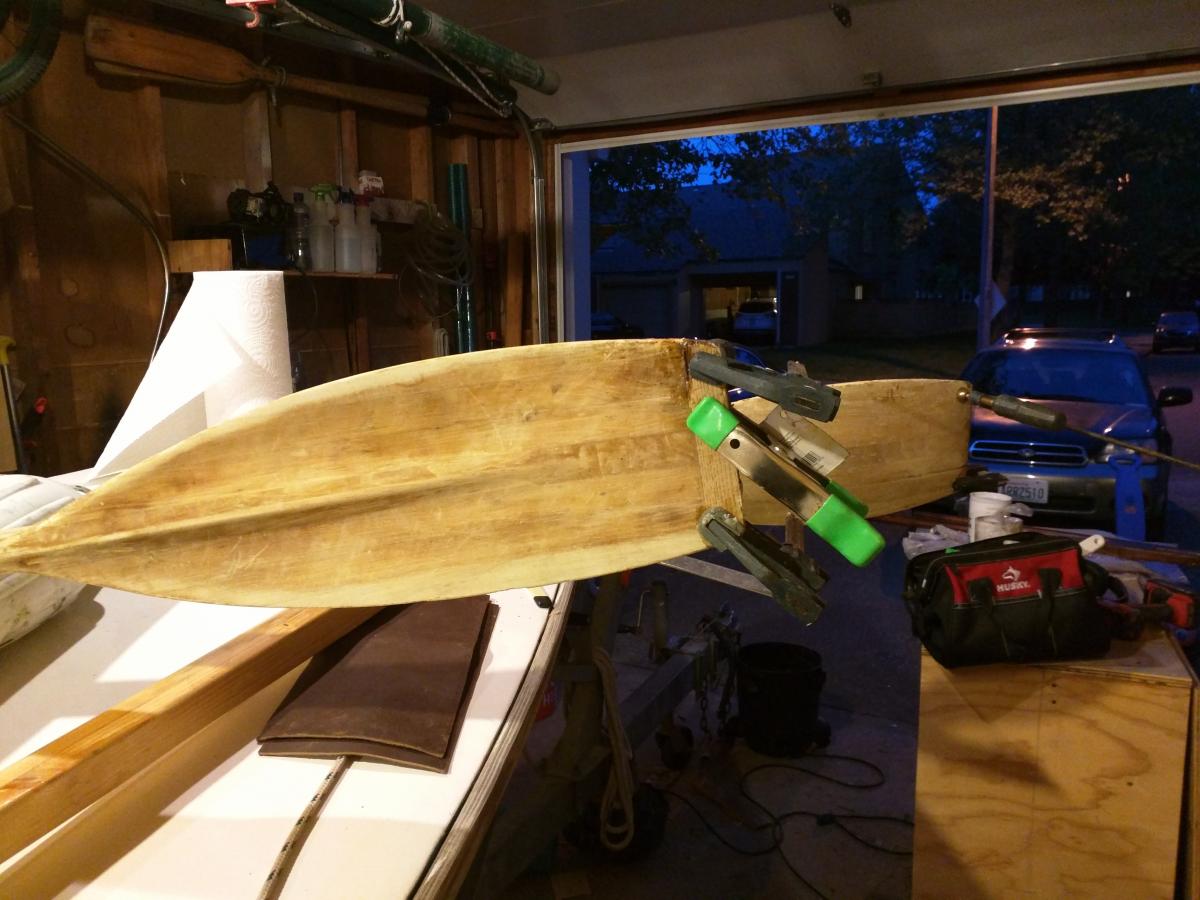

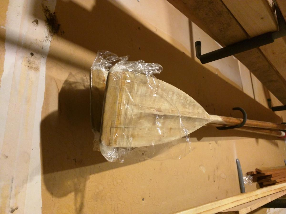

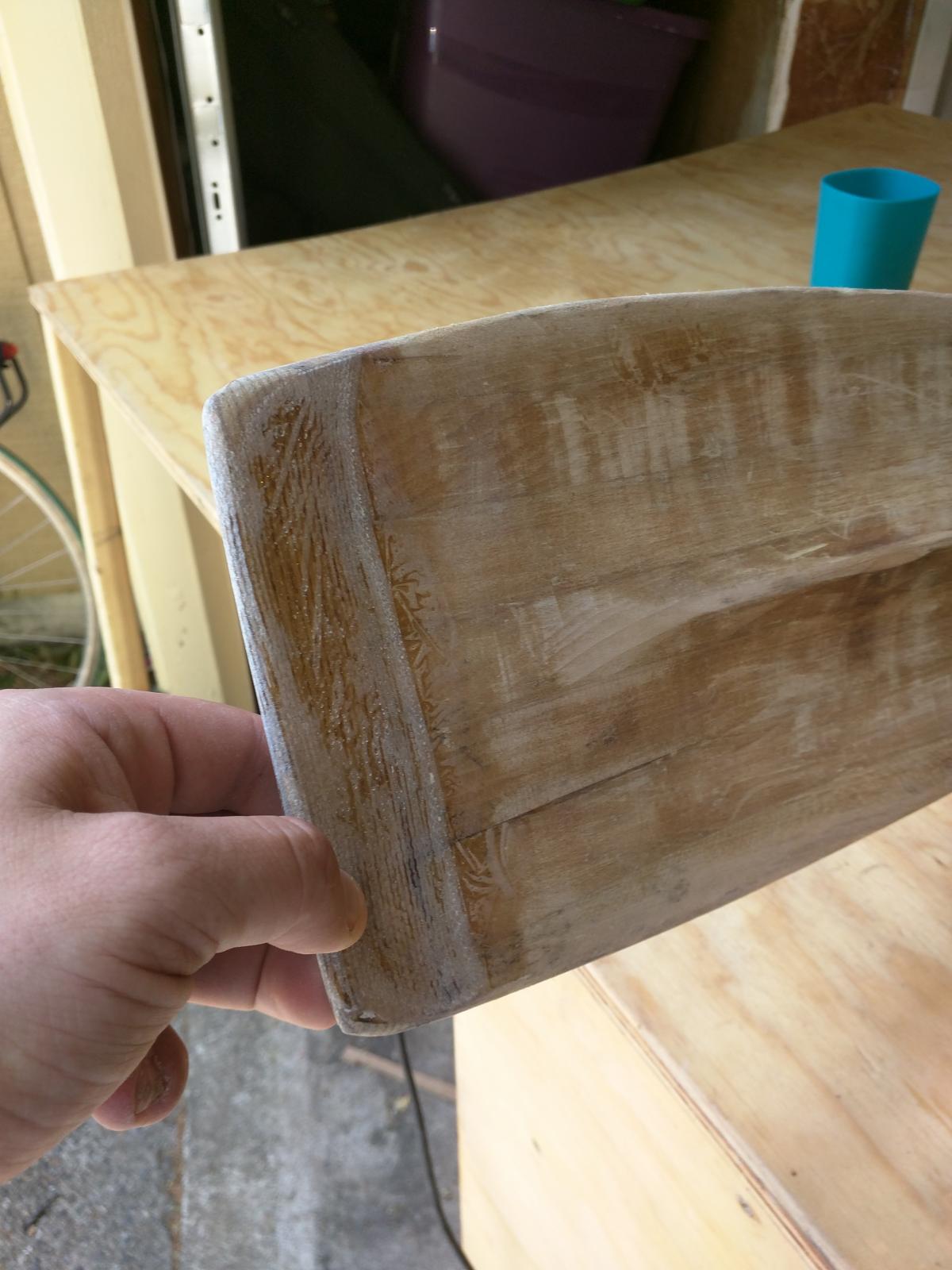

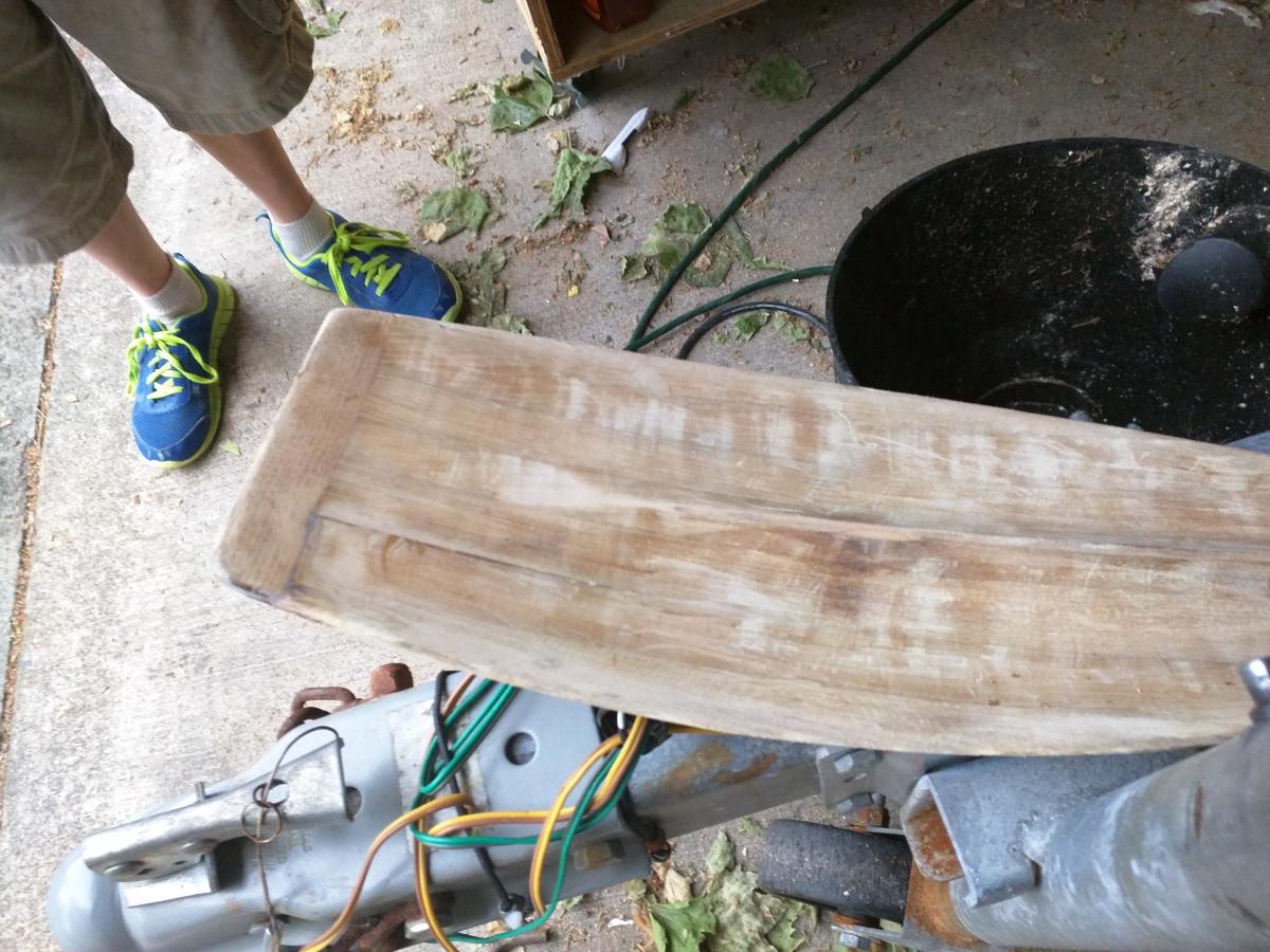

1) Oars, tips scraped, bleached, sanded, and then holes drilled in length wise and epoxy inserted with syringe then ends relaminated. 3" 6oz tape of glass folded over tip for reinforcement.

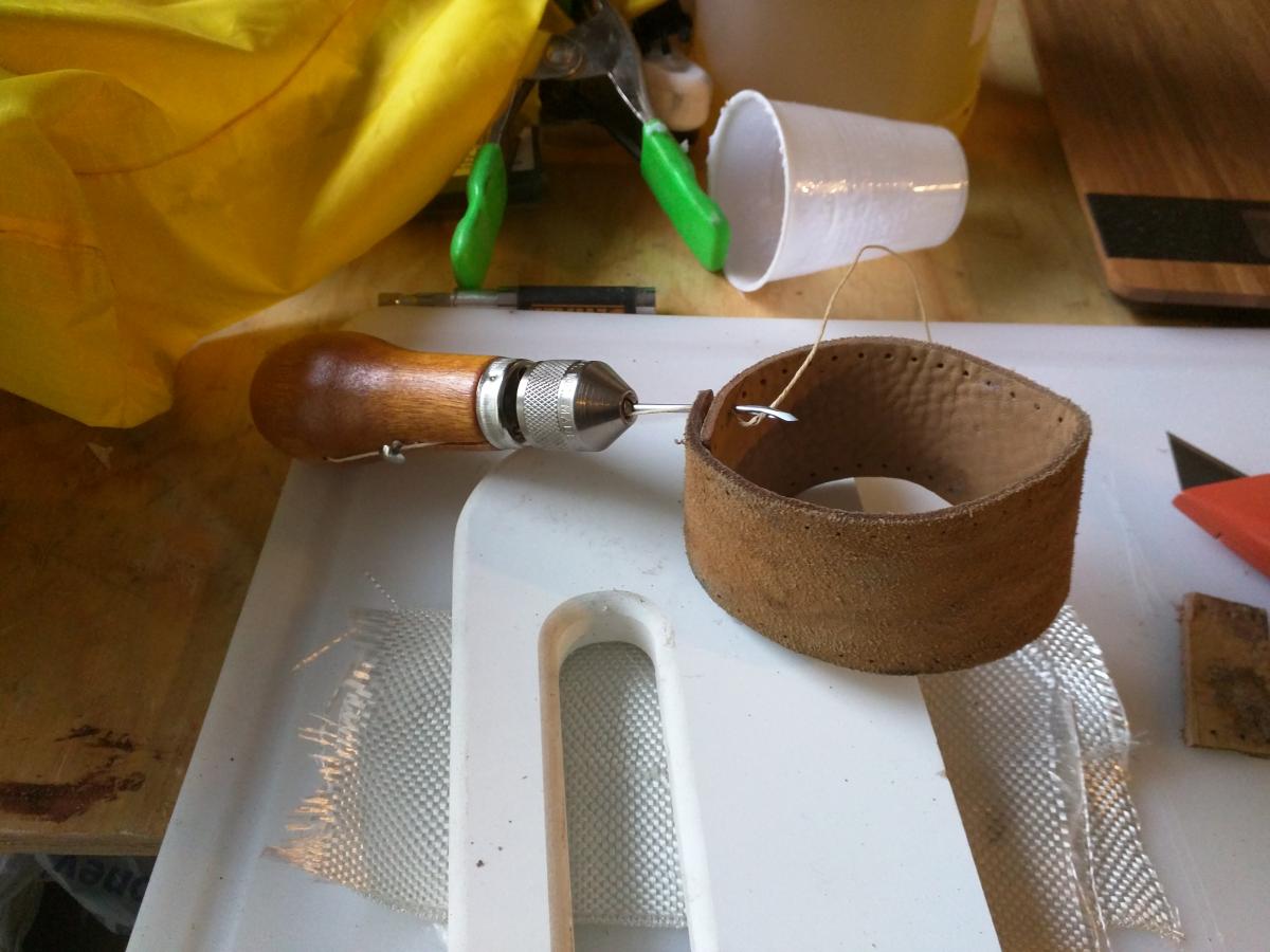

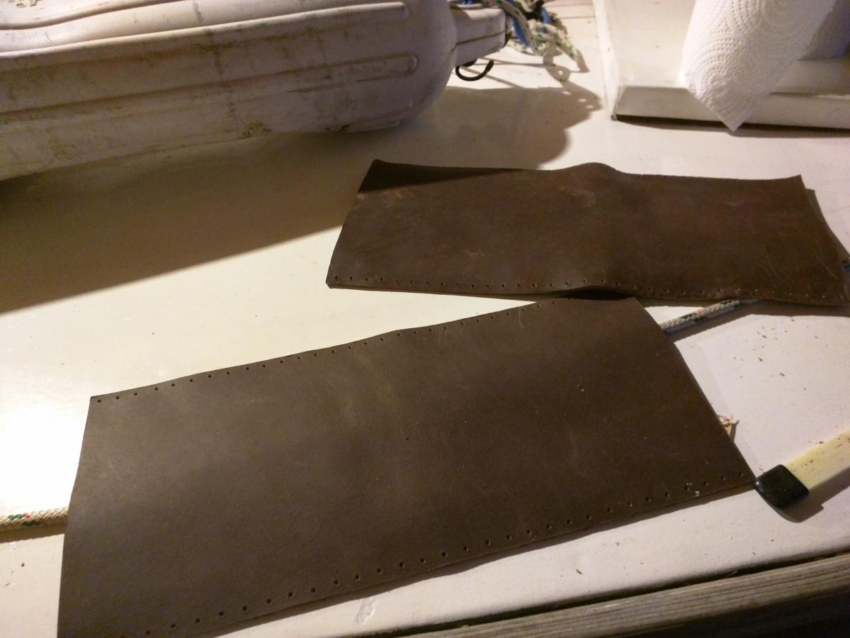

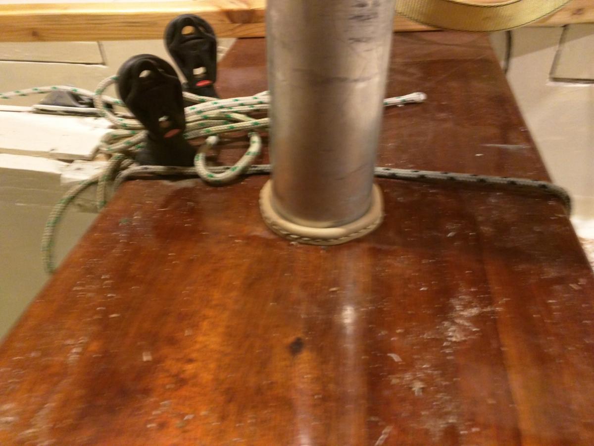

2) Jenn hand sewed new leather for me to project thwart from mast chafing.
3) Leather ready to be sewn in place on booms for chaff protection from masts.

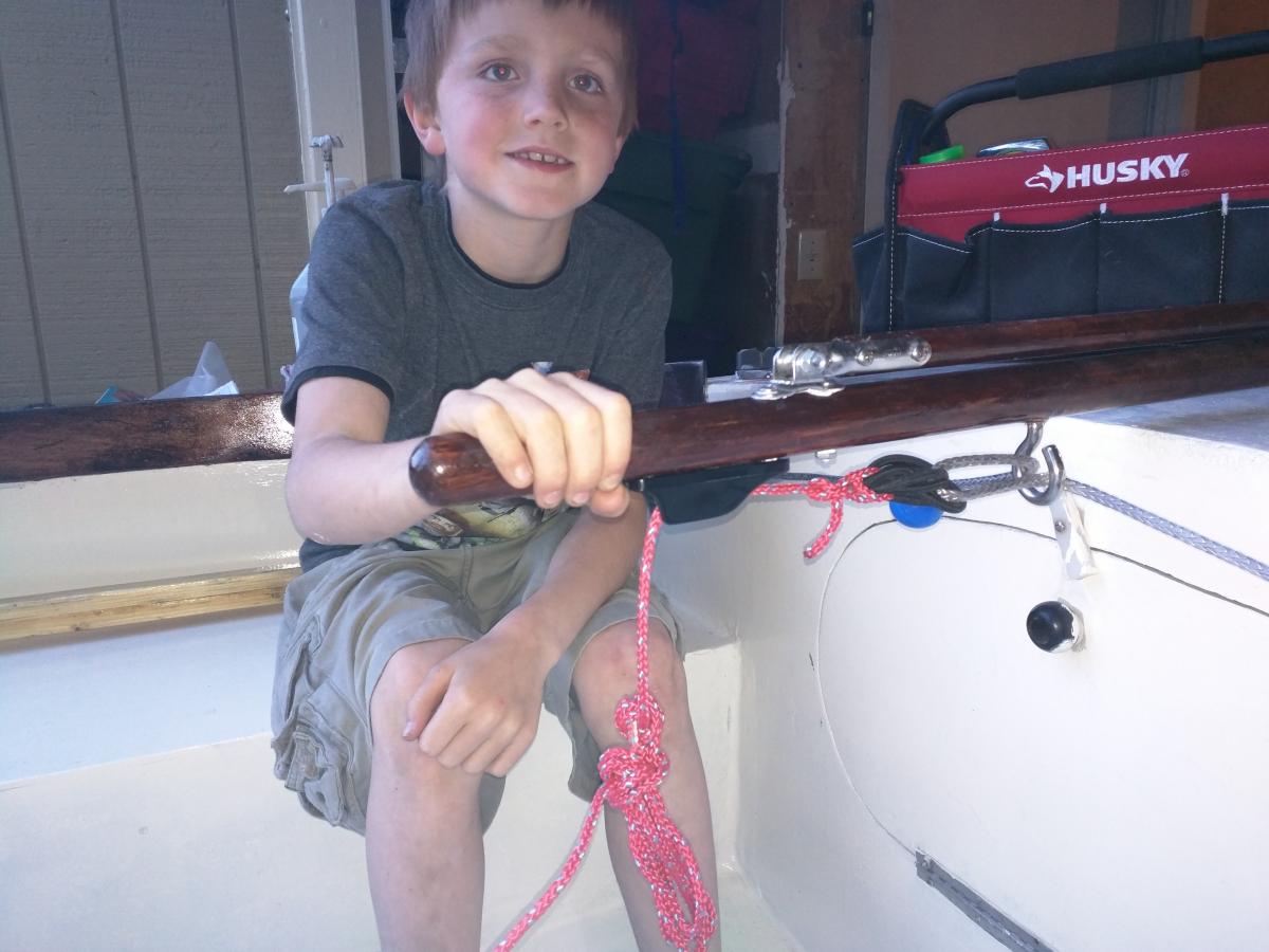

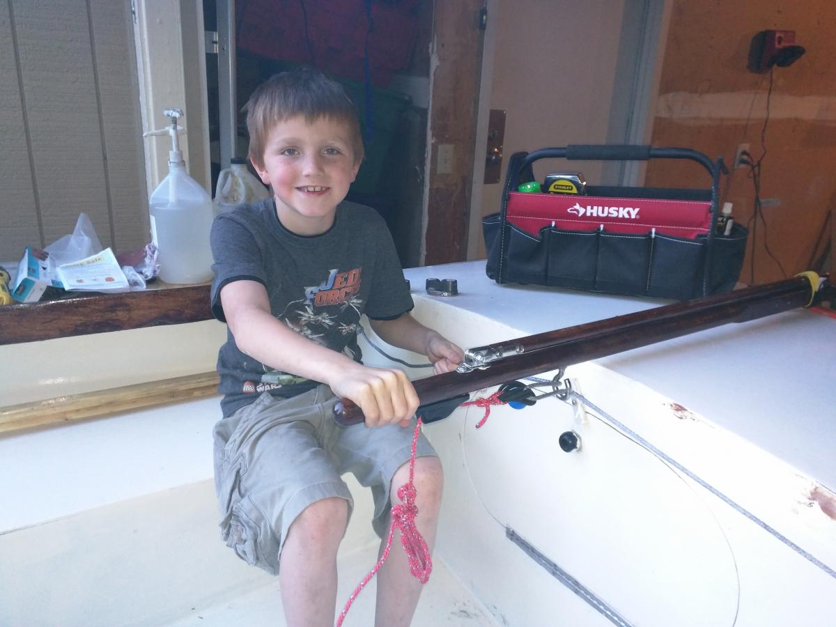

4) Tiller stained, and first coat of varnish applied.

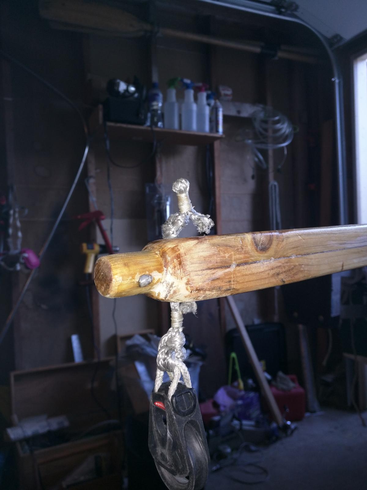

3) Drilling oversized holes and filling with epoxy on boom, then installing cheek blocks and camcleats on each boom for easier double reefing then taking the end of the sail off of it.
4) Installing two pulley's for main down hull, running aft to make it easier.

Tiller handle is varnished and back together, anchor roller support is revarnished.

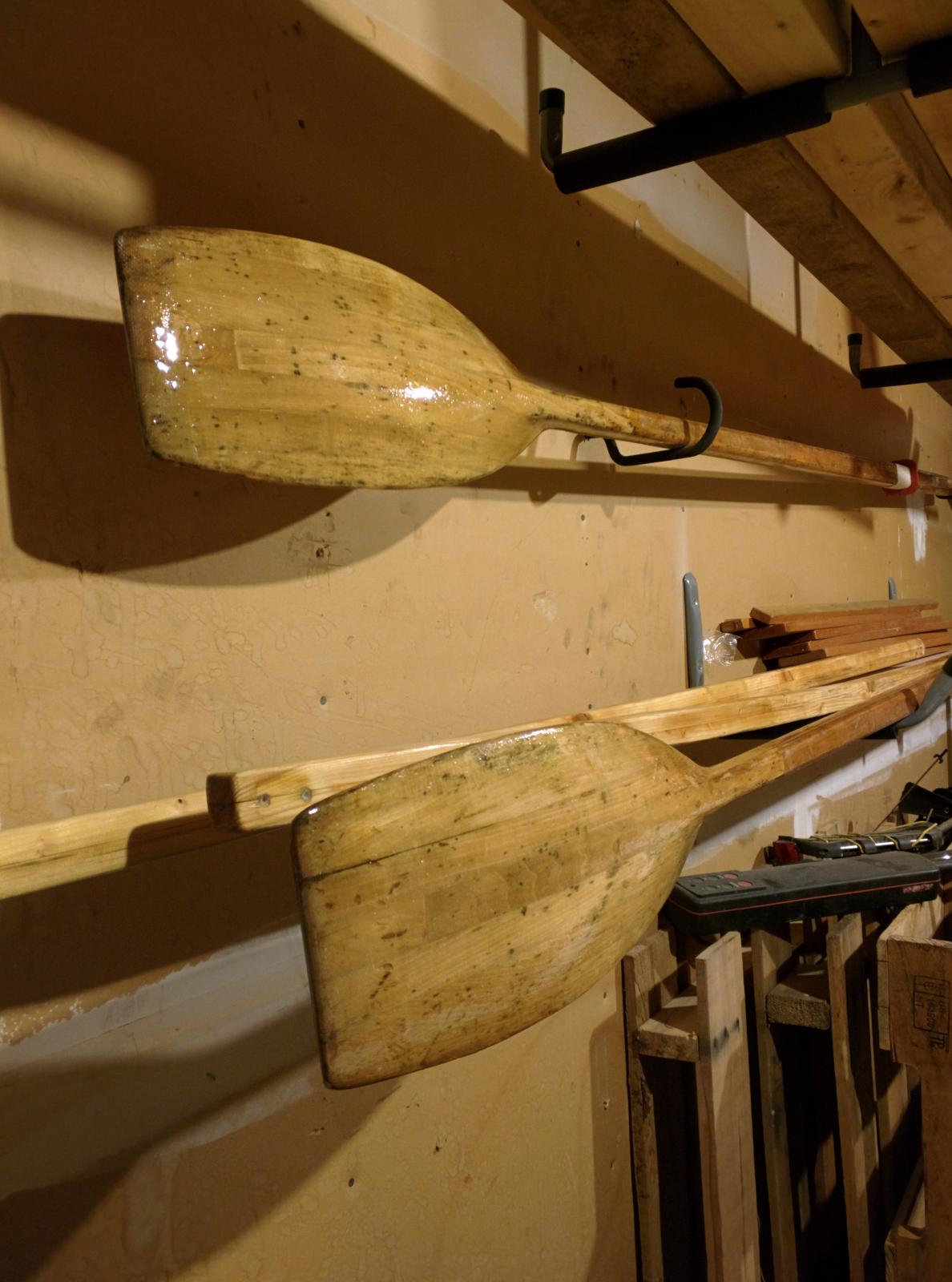

Oars are glassed on tip, and have had two coats of epoxy applied on blades. I'm going to test them out tomorrow, then next week after they have cured hard sand and apply a third coat.
Does anyone know a good stopper knot for 3/16 12 strand spectra rope??
 For the blocks on the boom, I've tried the ashley, and stevedore knot and am worried they slip to much under load with slippery rope, am considering the EStar Stopper however it supposedly will not ever come undone after a load has been applied which could be bad if I have to take anything apart. I don't mind doing whipping on the trailing end to prevent slippage for the right knot.
I'm using the spectra because of the strength, even after knots have been tied, I had a thicker line before, but it didn't rotate well in the hole, and the blocks need the ability to spin if the kids or I set the boat up wrong.
Link to comment
Share on other sites
I finally settled on using a anchor hitch to the blocks off the booms. I drilled a hole that was oversized then filled with epoxy and drilled out again. The spectra is tied to the block then through the hole with a stevedore stopper knot to finish it off, and both tails are whipped.
I tested this configuration under a lot of load using a wratchet, and then I was able to undo both knots. The spectra once tied well does not slip.
I also used Wes's tiller lock plans from roguepaddler.com which turned out great!

We tested out the oars and everything else today.
Video and photos are http://www.foggysailing.com/2015/05/r2ak-1st-day-of-practice.html

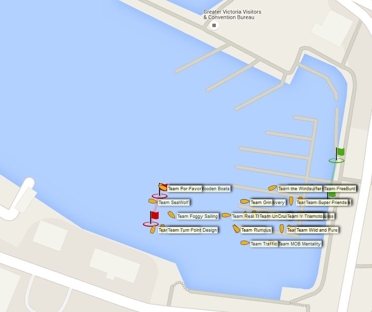

On r2ak.com site you can view track, and replay.
