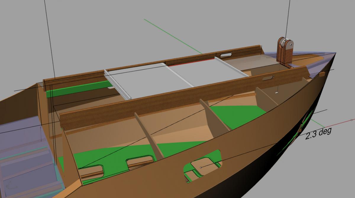

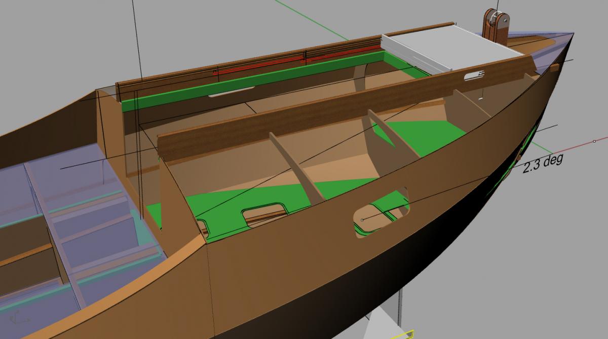

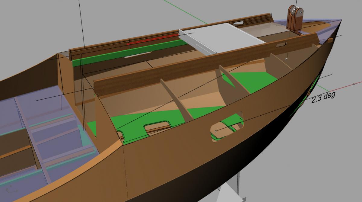

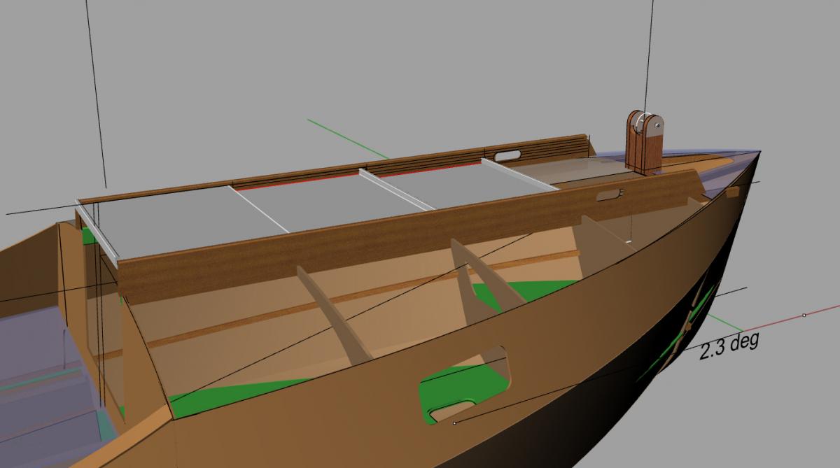

While on my trip I got to go flying. As the hanger doors slid by each other I thought, I should revisit the cascading hatch.
Alan and had discussed it and it was dismissed. My main criteria was that it must not leak at highway speed in driving rain.
Here is what I came up with. Three hatches made of 3/8" ply. Each one has one has cleats front and back that stiffen the hatch and overlap its partner so that when it is pushed open it collects it's partner as it is pushed open or closed.
The cleats will have some weather stripping which will compress against it's partner when the hatch is closed, There will be a sweeper strip of rubber or plastic on the front of each cleat that bears down on the hatch or deck below. The green piece is a coaming that surrounds the trench perimeter to keep any water out that gets by the hatches. The rails are 3/4" ply with grooves cut for the hatches to slide.post-127-0-09712000-1426345075_thumb.jpgpost-127-0-93327500-1426345136_thumb.jpgpost-127-0-18754900-1426345179_thumb.jpgpost-127-0-85553200-1426345226_thumb.jpg

Graham,
I LIKE it!  Is this the cake we can have and eat too?  Access to the forward mast and anchor well, good ventilation, ability to stand in the cabin, AND waterproof?  Oh, and not as pricey as the very sweet design that Doug worked up.  Looking forward to more details.  And, since your boat is likely to be the first one with this design to be rained on, let us know if the weather stripping/combing configuration works as well as we hope.

Let me nit-pick a little... :mellow:
As you know, water will really pool up between the siderails ahead of the hatches in a heavy rain (and much more so during trailering) , consider adding "serious" limber holes in the side rails ahead of the coaming at the front of the trench (almost as large as typical handrails).
With the sliding sequence of hatches shown in the sketches (e.g. aft-most in the top-most position... fwd-most in the bottom position) there ends up being three (3) sweeper strips vulnerable to leaking.  If you reverse that so the aft-most section is on the lowest track (and slides 'under' the hatch section ahead of it) then you eliminate the sweeper strips needed between overlap between hatch 1 and hatch 2, and similarly the sweeper strip between hatch 2 and hatch 3.  Of course there might be a bit more too it than that ;)   Not sure but you may also be able to make the fwd 'twartships hatch coaming solid between the rails (instead of having a gutter (water channel) running along the full length of the side rails.  Don't know how clear that is, but hope the basic idea got across.
Of course it ain't that easy, and there are lots of details involved...
I really like that by dividing the hatchway into three it brings the crew so much close to the mast.
Can't tell from the dwgs, but If there isn't one, consider adding a sturdy standing/stepping location inside the boat (with the hatches most forward) in a position that allows the crew to stand with their waist/hips just at the level of the coaming - standing in a hatchway so that you're well braced without using hands is quite helpful if you need to fiddle with the sail in the rough stuff.

I like it, but it seems like it would need to be built with extreme precision to be watertight. It will be interesting to see all of the ideas that take shape as all these Mark III's start to near completion. I really like the idea of a walk through type hatch and I worry about handling lines during docking and anchoring if it isn't easy to get to the front of the cabin. This looks to solve that by keeping the cabin open its whole length. It would be interesting to hear Doug chime in with his experience.
I think Tom's idea of having a step falls in line with my plan to make a floorboard between the bunks that lifts up into a table below. I think that step down is a big one and an invitation to a twisted ankle. I plan to have a fold up step (or battery box) and the floorboards.

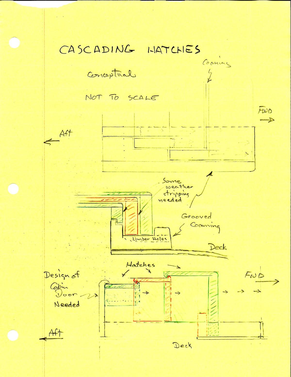

I, too, like Graham's cascading hatches.  From the photos, it looks like he has in mind flat surfaces for each hatch.  That would ease the perfection needed for a waterproof and easy sliding assembly.  It will still need careful workmanship.  I second Tom's suggestion that the limber holes be "seriously" large enough for heavy drenching in high winds.  But all precautions won't keep all the water out if you're driving thru a rain squall.  Best hope will be to at least try to channel what water comes in down to the bilges without soaking everything in the cabin.
I also liked Tom's suggestion of having the aft hatches sliding forward under the others.  I've sketched a conceptual design that might be worth considering.  With most of the wind nearly always from fore to aft, such a design would seem easier to waterproof.  Fabrication seems easy enough with the side coamings cut from solid wood with a set of dado blades.  All other joinery is flat and at right angles -- except for the coaming at the forward end of the companionway.  And I would think some simple short pieces of weather stripping between the sides of the hatches (1&2 and 2&3) at the aft end of the wider hatch would keep out most rainwater trying to enter aft to forward that might be caused by a "back draft" when on the highway (or parked on shore or in a slip).  A little bee's wax or silicon lub would keep them sliding nicely.
Concerning the limber holes.  For boats that mostly live on a trailer, they need to be easily accessed and sized so they may be cleaned out frequently.  I have to cope with substantial pollen and tree debris which I find seems to clog up even very large limber holes.
I haven't thought about the door to the companionway and its proper interface with the aft most hatch (and its stowage when not used to close the companionway).
From Graham and fellow builders -- I'd welcome critical comments and suggestions.

Are you thinking cabin doors or the possibility of weather boards?  Either way, I would have them close under the hatch, not behind/over.  Doors are convenient, but usually in the way on small boats, even on larger ones.  With weather boards you can use 2 or 3 depending on storage space.  I found that while cruising for up to 2 weeks I removed my weather boards, stored them, then didn't see them again until the end.  But I had a dodger over the companionway.  I would bet though that in a period of nice weather that you may find them not coming out at all.
