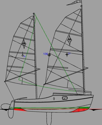

Chick Ludwig Posted November 14, 2014 Report Share Posted November 14, 2014 Hey ya'll. Any interest out there for a CS -15 Mk 3? I've been corresponding with Alan Stewart about having B and B design at least a partial kit for one. He posted some renderings on the "Core Sound 15 Kit" thread. http://messing-about.com/forums/topic/9048-core-sound-15-kit/page-2 What do you guys think about it? Here are some thoughts I sent to Alan: 1. Raise the sheer, and leave the cabin height as it is on the rendering. That would let it look less "chunky". 2. Drop the berth height and eliminate the footwell in the cabin. Sit up with feet up cross-legged. Kinda like being in a tent. This would give headroom without raising the cabin any higher. I'm a solo sailor, so I don't need much room. 3. Have a forward hatch instead of sliders and full length tunnel. 4. Outboard on transom and no oars. Use space in backrest/coamings for stowage of misc. small stuff with access into bins through the back rests / coamings instead of using them for oar stowage. 5. Definitely keep the water ballast. Here is more: I'll build the cabin interior "as I go along". That way I can mock it up to try things. Can we get at least 6 1/2 feet of length inside? Need to move the mizzen aft to do this? The berth top would be just high enough to give a large enough area to sleep on. There would be some space for stowage below through hatches. Probably won't want an aft deck or even a seat/locker across the back. More room to sit that way. Maybe I'll put in a removable seat there for when Debbie and the grandson go. Tabernacles on both masts for ease of going under bridges. Necessary on the lakes. I'll want a bimini over the cockpit, so the foot of the sail needs to clear it. Will you or G. provide sail plans with spar dimensions? As much as I like full battens (we have very light winds up here during the summer.), I need to be able to drop the rig into the boat as mentioned above, and I don't want to have to remove the sails to do it. I would think that the battens would cause a problem. (I know most of you wouldn't need this.) Of course, these are my ideas for my boat. What would you want for yours? Quote Link to comment Share on other sites More sharing options...

Chick Ludwig Posted January 2, 2015 Author Report Share Posted January 2, 2015 Hey y'all. We're getting closer to start up time! I had a nice conversation with Alan at B&B a couple of days ago. They should be done with the power cat by the end of January, and hopefully far enough on their other projects that they can "jump onto" the CS-15 Mk-3. And here is some great news---looks like it will be a stock kit! Alan thinks with the way we are "tweeking" the design, she'll be a very efficient little cruiser. Scratch the cabin with a berth on one side with cabinets/lockers on the other. We'll have a simple, open layout with the entire cabin as a berth area with a shallow footwell, with a lift-up floorboard to make one big sleeping area. My boat will have tabernacles on both masts, but the stock boat will be like the other Mk-3s with a lift-out mizzen mast. Not sure where the w/c will "live" yet---maybe as a companionway step? The berth area won't be high enough for it to fit underneath at the forward end. Or maybe it will slide under the cockpit seat from inside the cabin? I dunno. The guys will work that out I'm sure. Anyway, it's fun thinking and dreaming about this stuff on a cold, rainy winter day... Any more thoughts from you other guys out there? Maybe we can get Graham or Alan to post an up-dated rendering!!!??? How about it G. and A.? Quote Link to comment Share on other sites More sharing options...

Designer Posted February 18, 2015 Report Share Posted February 18, 2015 Hey Chick, The cold weather is not all bad, I found a small window to start fleshing out the CS15 mk3. I decided to make it 15' 3" long rather than 15' even to better use up the 2 sheets of ply for the side planking. Quote Link to comment Share on other sites More sharing options...
Chick Ludwig Posted February 18, 2015 Author Report Share Posted February 18, 2015 Hi Graham!!! I'm thankfull for the cold weather if it gives you some time to work on the Mk-3!!! ( Other than that---wishin' summer would get here!) Looks GREAT! I wanna go SAILING! Lookin' forward to seeing the progress. By-the-way, What is it that looks like a jib club boom on the fore deck? Or is it the main mast shown as lowered in it's tabernacle? Quote Link to comment Share on other sites More sharing options...
Chick Ludwig Posted February 19, 2015 Author Report Share Posted February 19, 2015 I've put my thoughts together for Graham and sent them to him. Any ideas from you guys? 1. First thought was to drop the berth height and eliminate the foot well in the cabin. Sit up with feet up cross-legged. Kinda like being in a tent. Now I’m thinking that it would be best to leave a shallow foot well with a sole that will raise to be a filler for sleeping. . Can we get at least 6 1/2 feet of length inside? Need to move the mizzen aft to do this? 2. Is there a place that a w/c could live in the cabin? Maybe as a "step" coming down into the cabin from the companionway? 3. Have a forward hatch instead of sliders and full length tunnel. Maybe a sliding style hatch so I could open it with the mast in the lowered position. 4. On my boat, I’d want my 2.5 'zuki hung on the transom and no oars. Use space in backrest/coamings for stowage of misc. small stuff with access into bins through coamings instead of using them for oar stowage. Then again, maybe it would be good to have the oars. There are lakes up here that allow non-powered boats for a low fee, but charge a LOT for motors. 5. Cockpit needs to be large enough to "live in" and be able to day sail 2 or 3 people. (In our case, me, Debbie, and grandson Carter.) Usually, though, I’ll be sailing alone. I would want 4-hatches for plenty of access into the cockpit seats. At least one of them large enough to fit a cooler through. It could be on the opposite side from the weighted centerboard for balance. Access from inside the cabin to forward end of cockpit seats for sleeping bags, clothing, etc. Probably won't want an aft deck or even a seat/locker across the back. More room to sit that way. Maybe I'll put in a removable seat or removable stowage box there. 5. Tabernacles on both masts for ease of going under bridges. Necessary on the lakes. I'll want a bimini over the cockpit behind the mizzen, so the foot of the sail needs to clear it. Quote Link to comment Share on other sites More sharing options...
