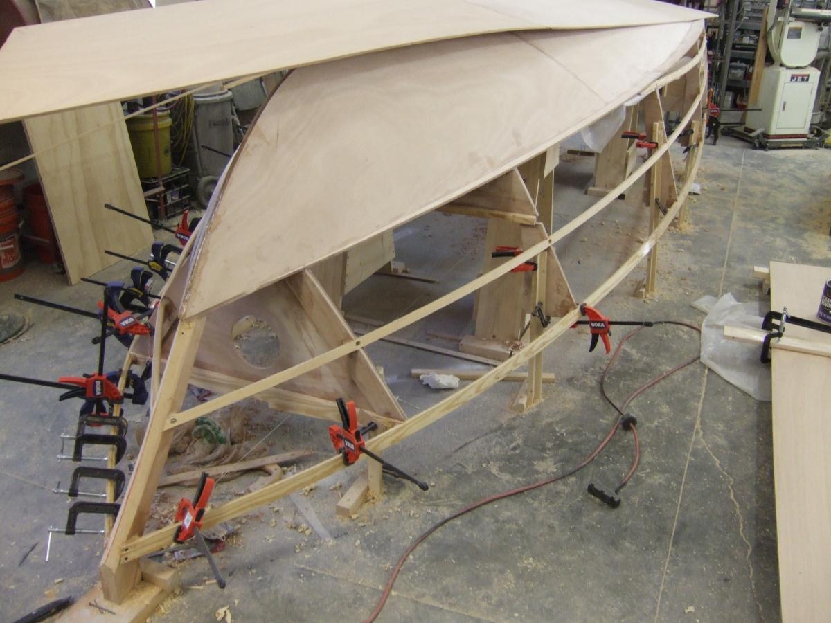

MikeLTour61 Posted September 15, 2014 Author Report Share Posted September 15, 2014 Hi All, A few more photo updates... I finished the inwales which turned out not to be as bad as I thought. As Graham suggested, I didn't put quite as much twist in them where they meet the stem and planed the excess. It's now fair and most of the meat is still there. I also got one of the side panels installed. I'm working alone so I installed guide pins (10d nails) once I got the panel where I wanted it. You just HAVE to remove them after securing with screws or they will be epoxied in place. It made the install a breeze once you know the panel is in the right place. 2 Quote Link to comment Share on other sites More sharing options...
Lotus Posted September 15, 2014 Report Share Posted September 15, 2014 Great nice work Mike ! I like the way you twisted the gunwales, looks very fine . Are those screws on the sides temporary ? Quote Link to comment Share on other sites More sharing options...
MikeLTour61 Posted September 15, 2014 Author Report Share Posted September 15, 2014 Thanks Lotus! Yes, they're temporary... just sheetrock screws. I used 1" in the stringers so they wouldn't punch holes though and cause more work on the inside. Quote Link to comment Share on other sites More sharing options...

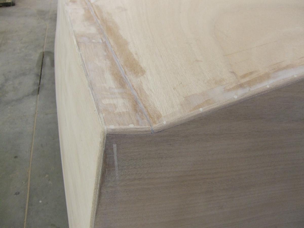

MikeLTour61 Posted September 22, 2014 Author Report Share Posted September 22, 2014 Here's an update of what I got done over the past week: Remaining side panel installed, bow and bottom profile formed (filled gaps where panels meet), fillet where bottom meets the chine, started fairing process. I only found one area that really needs a lot of fairing (+ 1/8") near frame 2 on the starboard side. I guess I shaved off a little too much from the stringers in that area to avoid having a gap between the chine and side that I had on the port side in that spot. Anyway, it's got enough fairing compound on it now... it just needs to be finished. I'm using West 410 fairing filler. I hate that stuff. It sags like crazy. I try making it as thick as possible but it doesn't want to support its own weight. Does anyone have any advice on use of fairing fillers? Also, I'm getting ready to round over the side to chine joint and wonder if anyone has advice on how to get a consistent bead (?) down the side with the varying angles. I have a laminate trimmer with an angle base attachment but maybe someone has a better idea. Some pics: Quote Link to comment Share on other sites More sharing options...
Miyot Posted September 22, 2014 Report Share Posted September 22, 2014 I'm using West 410 fairing filler. I hate that stuff. It sags like crazy. I try making it as thick as possible but it doesn't want to support its own weight. Does anyone have any advice on use of fairing fillers? Try 407, I've had no sagging problems and it still sands well and is stronger than the 410. Boat looks good. Quote Link to comment Share on other sites More sharing options...

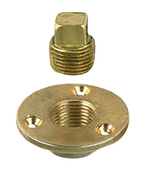

MikeLTour61 Posted October 15, 2014 Author Report Share Posted October 15, 2014 Latest update: Nothing thrilling, just a LOT of sanding. Final fairing is finally done. Will put a coat of epoxy to seal the fairing compound next and then she'll be ready to flip. I have thought about priming prior to flipping and wondered if anyone had any thoughts on that. I don't want to apply the topcoat until all the other work is done and I was wondering if there's some kind of time-critical component to the primer/topcoat application. It might be 6 months between the two steps. I know that in the car painting world, you generally want to prime (bare metal) and then paint prior to the primer curing. Also, I bought two brass garboard drain plugs for the transom and wondered what people used to seal them in. I plan on drilling slightly oversize holes and epoxying them but I'm wondering about how to seal the flange to the transom. 3M 5200 is the first thing that comes to mind but is there some other option that's better?? Thanks!! Quote Link to comment Share on other sites More sharing options...
Chick Ludwig Posted October 16, 2014 Report Share Posted October 16, 2014 I totally finish and paint the hull before turning. Mask it well. When youbuild your deck and glass it over onto the hull, mask to where the rubrail will cover the bottom edge of the glass. Trim the glass along the masking tape while the resin is still "green". You can buy a flaring tool to flare the cut end of the brass drain tube against the inside of the transom. 5200 would be ideal to seal it. http://www.amazon.com/520290-1-Drain-Tube-Flaring-Tool/dp/B0082ANA0C Quote Link to comment Share on other sites More sharing options...
MikeLTour61 Posted October 16, 2014 Author Report Share Posted October 16, 2014 Thanks Chick. This is my first boat and I'm not sure if any damage will occur when flipping. That's one of the reasons I'm hesitant to paint first. I bought the threaded plug below so no need to expand. Quote Link to comment Share on other sites More sharing options...
Chick Ludwig Posted October 16, 2014 Report Share Posted October 16, 2014 Oops. Different plug... Quote Link to comment Share on other sites More sharing options...
