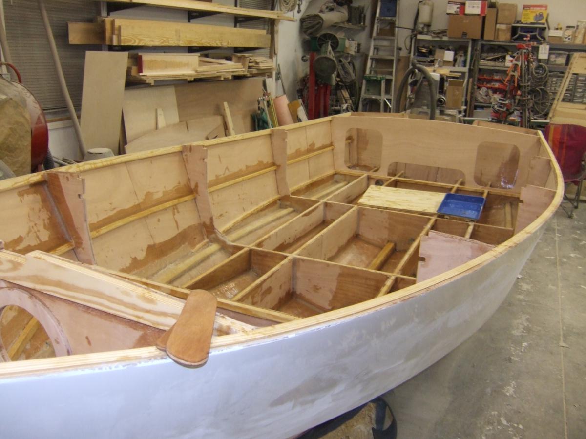

MikeLTour61 Posted January 6, 2015 Author Report Share Posted January 6, 2015 Hi all. It's been a couple of weeks since my last update but I have been hard at work and I think I made some pretty good progress. I'm done glassing the bilge (tabbing and bottom). Graham suggested I glass the bottom if I decided to go with a 50 hp engine so I went ahead and did it. Actually, I just bought some 8" 10 oz. tape and used two pieces per bay in the bilge. That gave me three inches up the stringers and 2 inches overlap in most cases. Where it didn't, I just added cloth as necessary. As you can see, the coaming is done. I'm presently working on getting the transom and motor well finished. While I'm writing (and you're reading) I wondered what should be used to seal the chase pipe (PVC) to the aft locker sole as shown in the last picture. I've experimented with thickened epoxy & 3M 5200 after roughing up the PVC with 80-grit. Neither of these methods worked very well although the 5200 seemed better than the epoxy. Lotus said he used something from Sikkens but couldn't recall what product it actually was. I think it needs to be solvent-based to bond with the PVC. I'll also use it where the chase goes through the frames. I hate rattles!!! Thanks!! Mike Quote Link to comment Share on other sites More sharing options...

Dale Niemann Posted January 6, 2015 Report Share Posted January 6, 2015 Not sure what you mean by seal the chase. I used epoxy for attaching my chase, after roughing up the PVC with 60 grit sandpaper wherever it was to be glued in. Where the chase came through the aft floor I used thickened epoxy and a plywood collar around it. The chase inside is not sealed in any way on my boat. Hope this helps. dale Quote Link to comment Share on other sites More sharing options...

Lotus Posted January 7, 2015 Report Share Posted January 7, 2015 Hi Mike, nice and clean job !. I have 3 suggestions to make if you don't mind . Put an other separate 25 mm pipe for the fuel line. Make that console narrower, in my opinion its enormous for the boat width. I made mine 700mm (28inches)wide and got space for all the instruments needed and more floor area to manurer around The 3rd is to add a partition in the bilge area . This partition will attach from the middle of the transom to the next frame and from the keel to the floor. Than when the floor is in place continue this partition from the floor to the bottom of the motor well. This will take all the force generated by the motor. I dont have a closeup photo of this section but can be noticed in photos1and 2 The stuff I used for the pipe is Sikaflex-11FC+ Hope this will help you. Quote Link to comment Share on other sites More sharing options...
MikeLTour61 Posted January 10, 2015 Author Report Share Posted January 10, 2015 Thanks again all for your input. Lotus, I noticed your smaller chase in previous pictures and wondered what it was for. I thought maybe for the depth finder wire as they can act up when placed close to other wiring. It makes sense to separate the fuel from the electrical. Don't want any stray fuel meeting any stray electrons! It doesn't look like we can get Sikaflex-11FC+ in the US. We can get Sikaflex-11FC. I don't know what the '+' is but I'm sure it's the thing I need I think I'll end up doing a large cabosil fillet around the penetrations. A couple people have done it that way and have had success. I drilled dimples into the pipe where the fillett will be which should help hold things in place. I may feel more comfortable making modifications to my next build but I think I'll default to Graham's console design for this one. I'm having some problems with ill-fitting parts from the kit and Graham is working to fix. I like the idea of the extra brace for the motor well. I thought of installing a knee but that line of thinking was carried over from my wooden rowboat days when growing up. I don't know if it's necessary for a 40 or 50 hp engine. The other thing is I'm putting a 6" round Armstrong deck plate cover in the center of the well. The reason for that is one of my bilge pumps will be located in the aft void. The other pump is between frame 3 and bhd 2. I'm ex-Navy and unless I have two methods to de-water I get nervous. I am planning on using the remaining biaxial tape to reinforce all the connections on the transom and motorwell. I think that should do it. Thanks again everyone!! Mike Quote Link to comment Share on other sites More sharing options...
Lotus Posted January 10, 2015 Report Share Posted January 10, 2015 Looks like you know what you're doing Mike ! A small suggestion is that its better to use two 45 deg. bent instead of a 90 deg. L bow. It may be difficult to pass the control cables through as their last 6 or 8 inches is not flexible !. I used one 45 deg at the aft and two 45 deg in front and still was not easy Quote Link to comment Share on other sites More sharing options...
Dale Niemann Posted January 11, 2015 Report Share Posted January 11, 2015 I used two 45 degree elbows aft and left the pipe open under the console. dale Quote Link to comment Share on other sites More sharing options...
