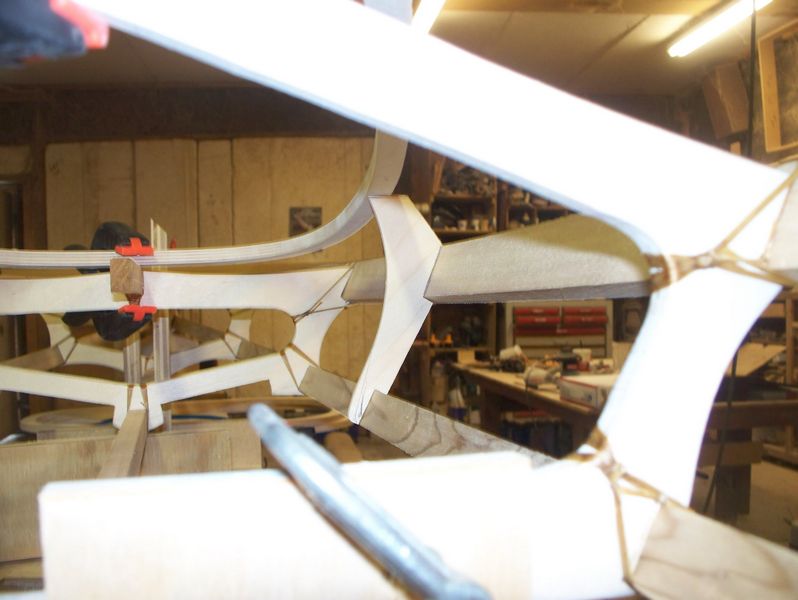

lisian Posted September 17, 2014 Author Report Share Posted September 17, 2014 My timber adjustable foot rest, copied the design out of a friends fiberglass kayak, the plywood just slips out and can be moved along to any of the slots. The coaming as of today, still lots and lots of hours of sanding to go. Woodman - Thanks for the pic helped me get my head around it Jeff - There is no flex at all in my coaming, but I have decided to put the supports in anyway. I had to make some new ones today as the the ones I had made, even though I cut them oversize were not tall enough to reach up to the coaming and there is no way I can bend it down to meet them Quote Link to comment Share on other sites More sharing options...

woodman Posted September 17, 2014 Report Share Posted September 17, 2014 Lisa, my adjustable foot pegs.... http://messing-about.com/forums/topic/9217-the-curlew/?p=82467 Quote Link to comment Share on other sites More sharing options...
Kudzu Posted September 17, 2014 Report Share Posted September 17, 2014 I am a little concerned/confused about one thing. What are the stringers(?) under the heels? Your heels should rest on the skin. Also, you don't want ANYTHING around your feet could even possibly get entanvled on and trap you in your boat. Quote Link to comment Share on other sites More sharing options...
lisian Posted September 17, 2014 Author Report Share Posted September 17, 2014 Jeff - just took them out, what if I just run a piece of ply along the middle 3 stringers/keel where my feet go? Quote Link to comment Share on other sites More sharing options...
Kudzu Posted September 18, 2014 Report Share Posted September 18, 2014 I never use and anything. The boats are designed to your feet to rest on the fabric. So if you add anything you cut down the space available. Quote Link to comment Share on other sites More sharing options...
