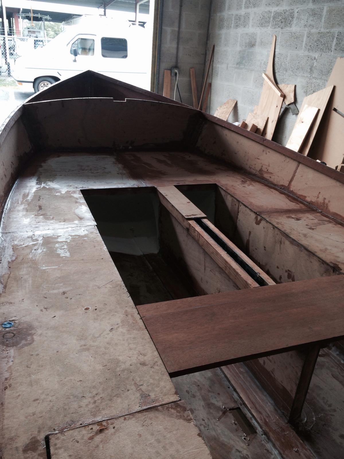

Well I tacked the center board trunk into the boat.  I do not know how well it will it will be in the end.  When I put the keel batten in I do not know how well it was done  It was hot and I had to do it by myself no help and the epox wanted to set before I really had it where I wanted it ..I did not get it screwed to the hull but I had plenty of epox under it.  It run out around the edges.  The center board trunk looks sq and true down the center but there was some space between the keel batten and the side of the trunk.  I will fill ity with epox and add a 1x4 over the batten to give support to the trunk.
 The question  when I put the front seat piece in the cover for the center board trunk  seemed to go a long ways down the center board trunk will part of it have to be cut off seems real long and will be in the way of the center board when it is down

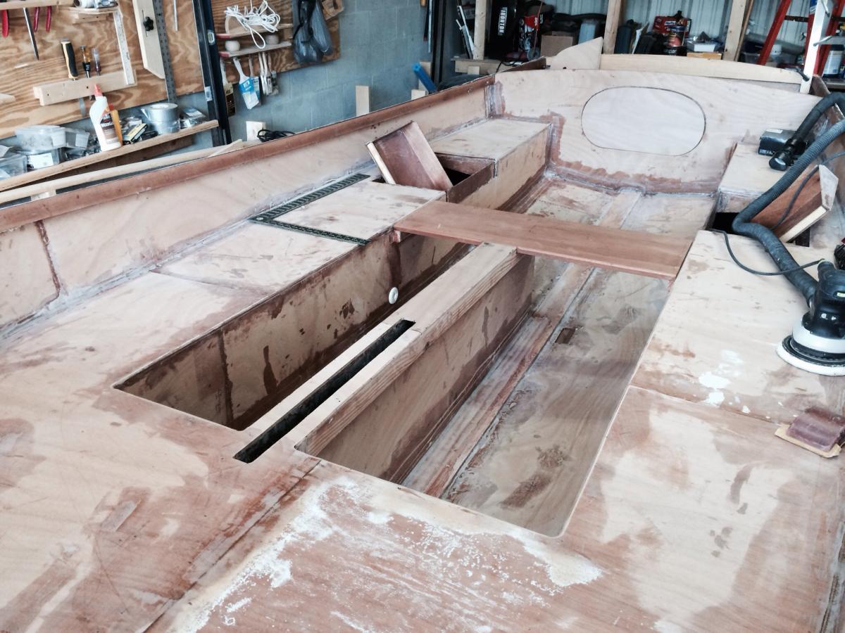

Floyd-
i know now what you are saying about the keel batten install. I had a friend helping me and I was organized gong into it but it was stressful, goo drying and generally a step I was glad to get past. Hope yours comes out ok. As far as the front seats,  I had same question and here is my take: the front of the CB trunk "slot" does get covered as the front seat goes in, but is easy to use a router ( or perhaps a pull saw) and cut out a nice clean hole up to the front end of the trunk-
see picture. It seems from the pictures and my own experience that you should epoxy and paint under where the front seats will be as it is easier before the seats go in. Good luck! Some of this stuff is difficult alone.
